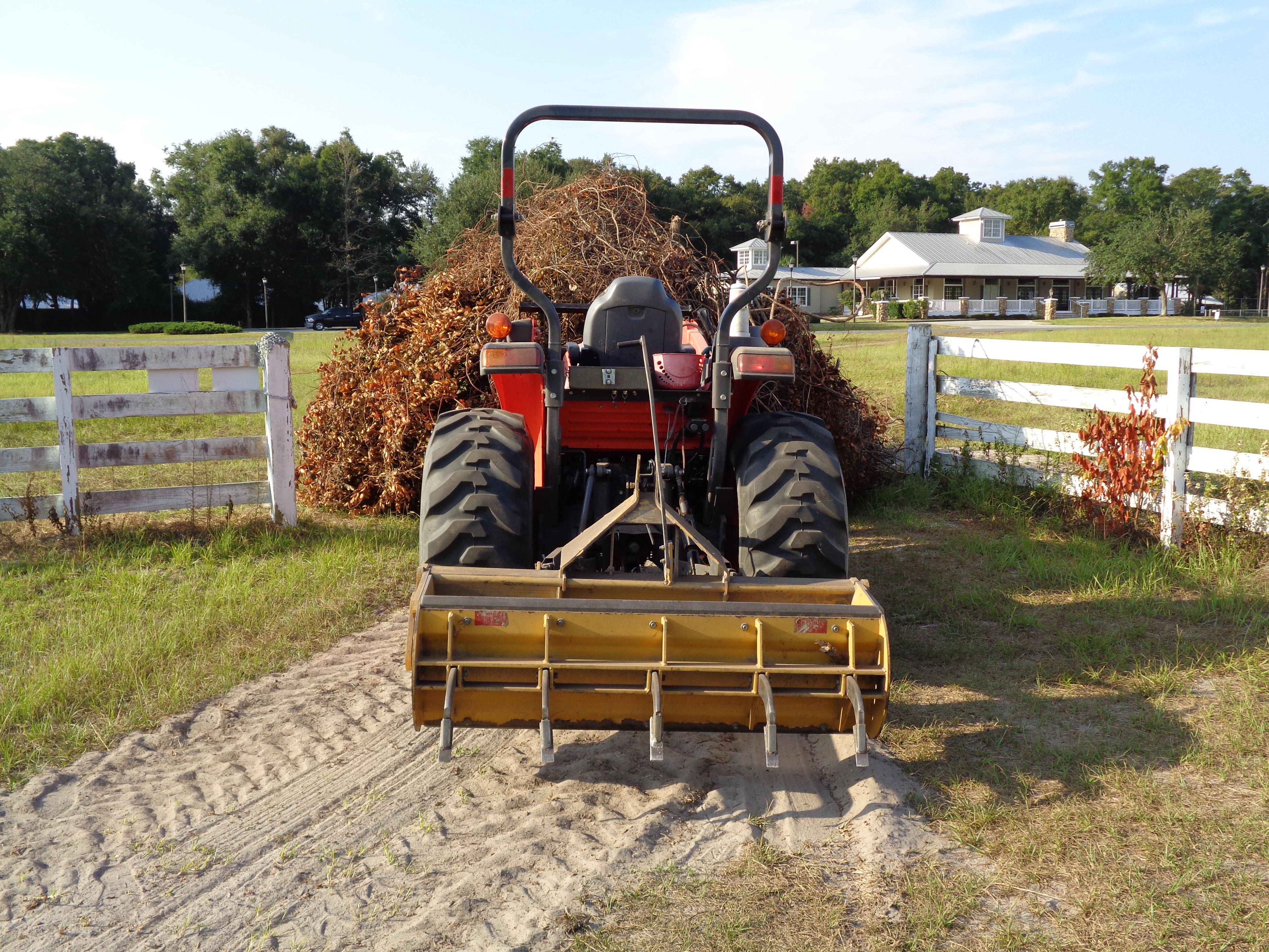

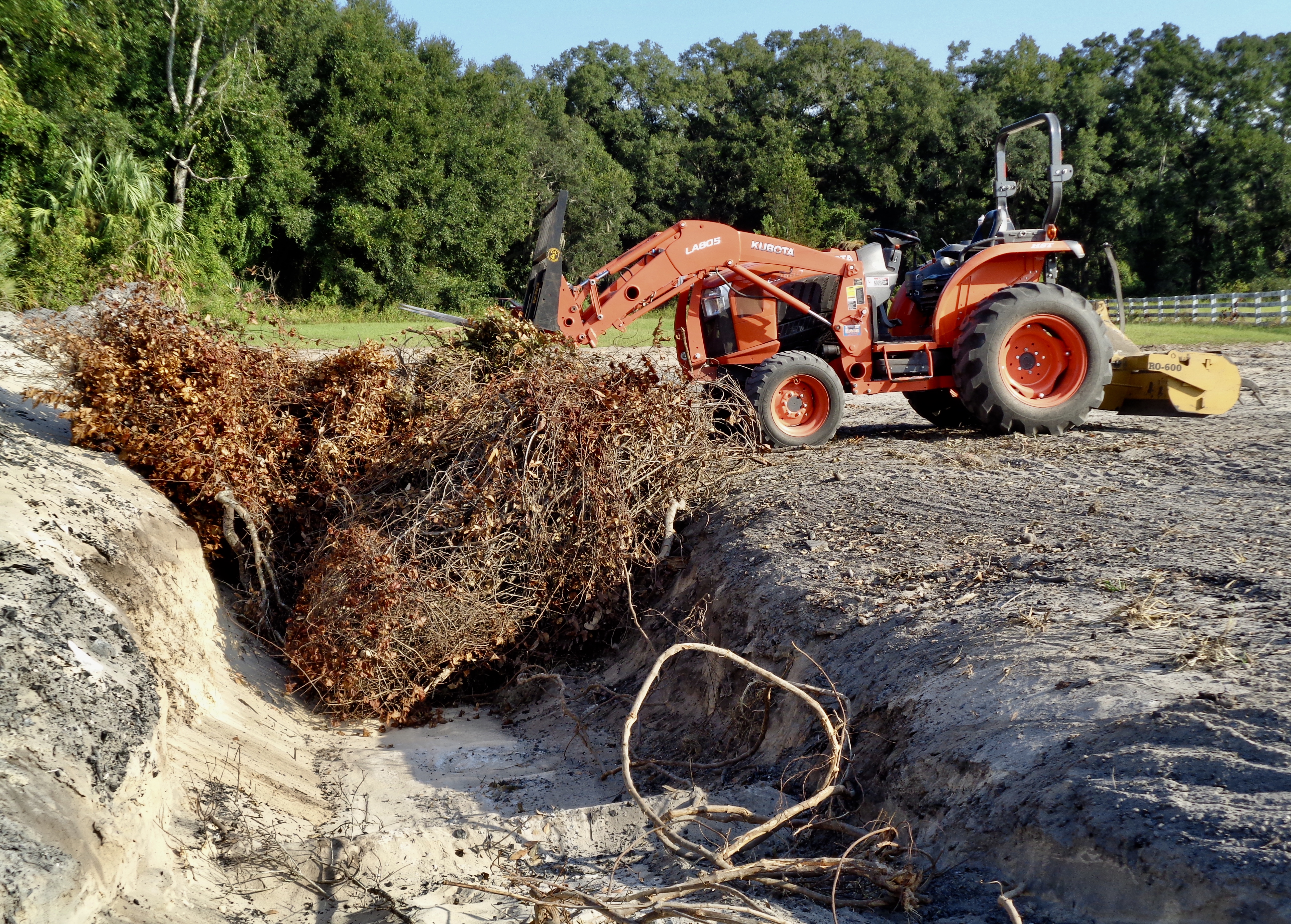

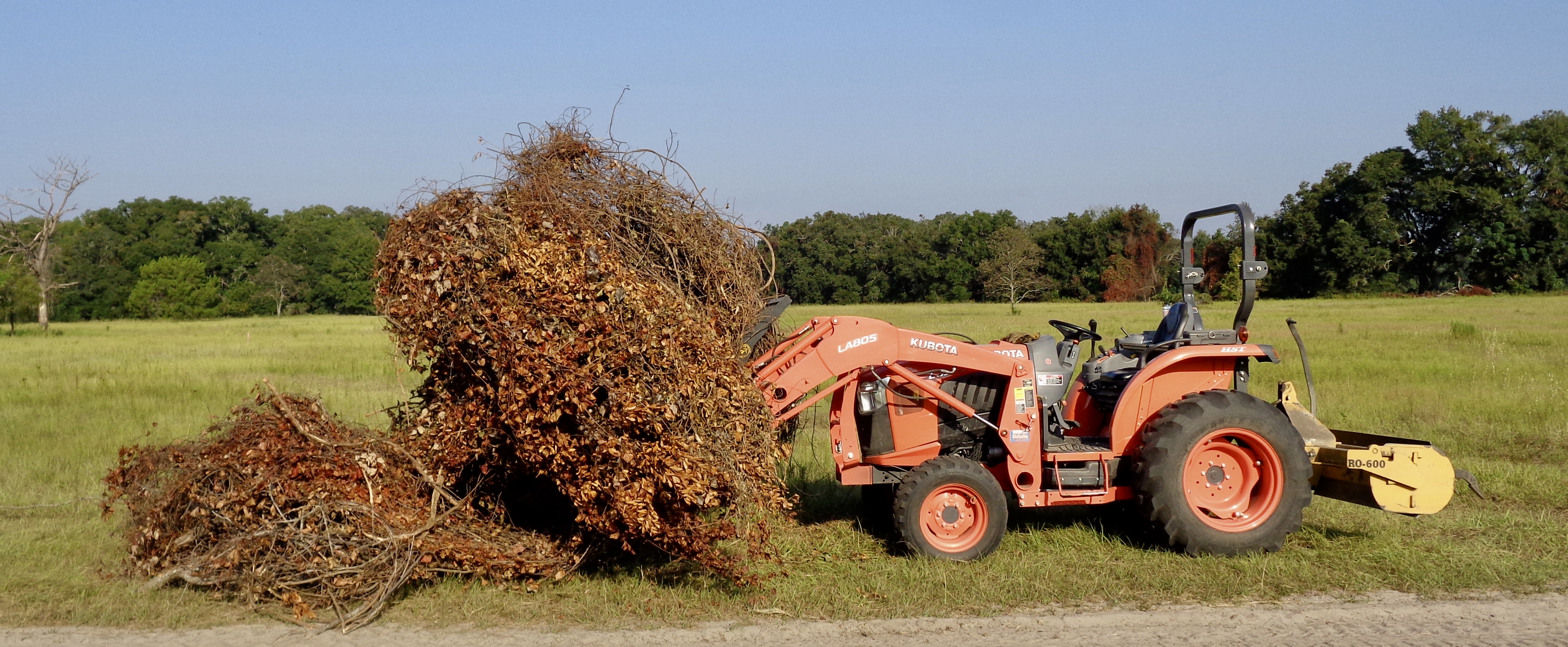

Consider a Three Point Hitch mounted Finish Mower as well as the MMM. Cheaper and much easier to mount and dismount.
VIDEO: Comparing Finish Mowers (midmount VS 3-point) - Kubota B26�1 - YouTube

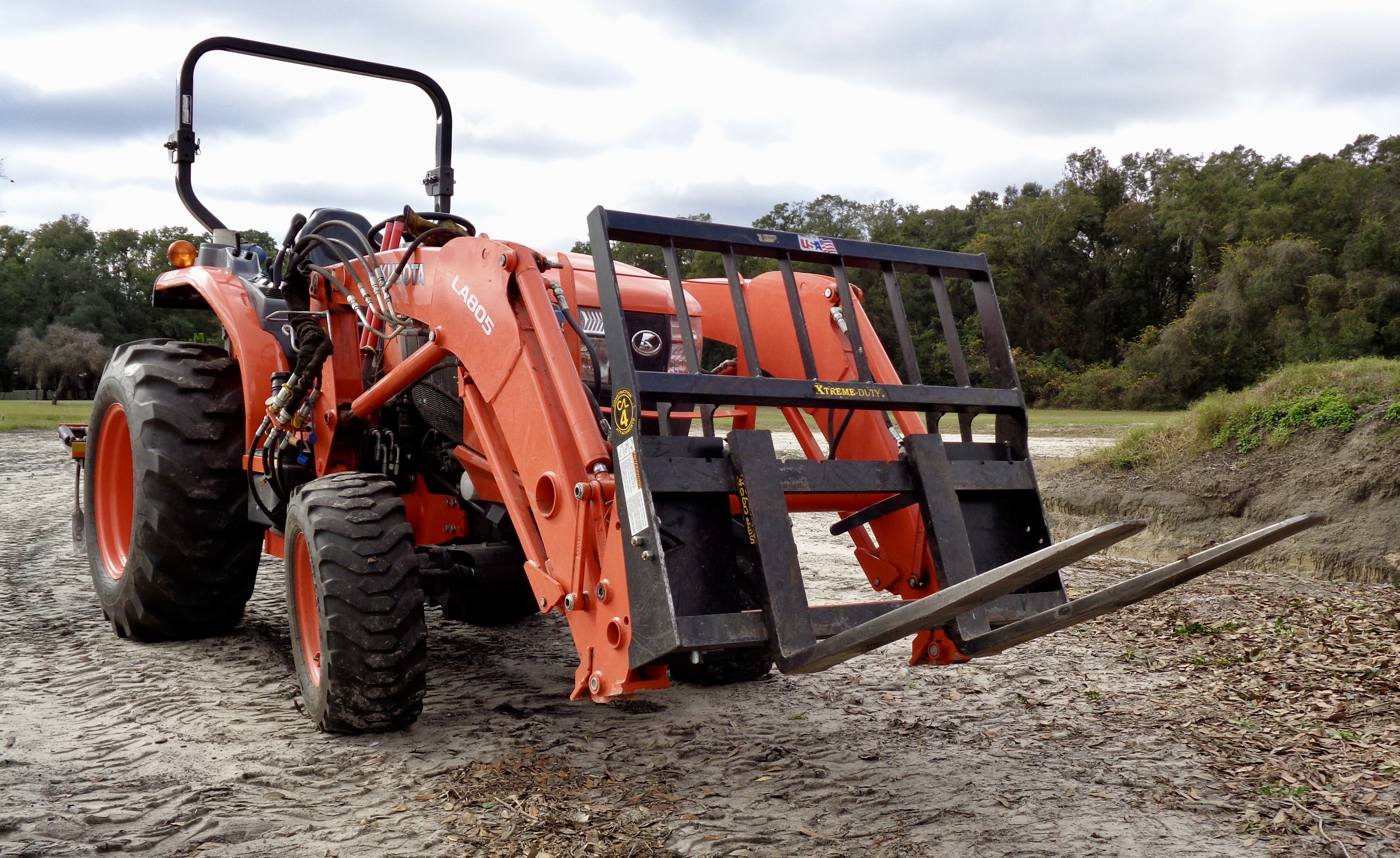

Over 1.2 acres 18" or 21" Debris Forks or 24" Manure Forks or light duty Pallet Forks are about equal to a grapple for landscape cleanup but cheaper, simpler and well matched to subcompact tractor limited lift capacity. If you opt for Pallet Forks find some 24" to 36" long. BX does not have lift for more length. Shorter length is more maneuverable when picking up debris, so you get off tractor infrequently.
Manure Forks, being round in cross-section, pick up less dirt with debris.
Multi-Spear Ultra Fork
Finding the simplest tractor solution is a priority for me when considering implements and attachments.
