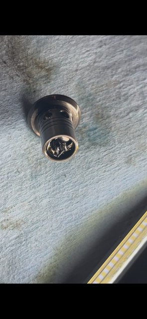

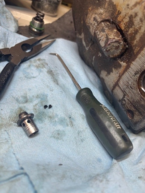

Today, I started removing drive motor plugs as per TC-Service-manual and found debris which appears to be hose related in the relief valve hole. I think it was blocking the small 'HOLE' in the middle leaving the relief valve opened.

I then inspected the hose with the fitting we screwed in to make the joint and sure enough the inside of the hose has a cut in the rubber hanging loose ready to go in the motor to make more damage.
