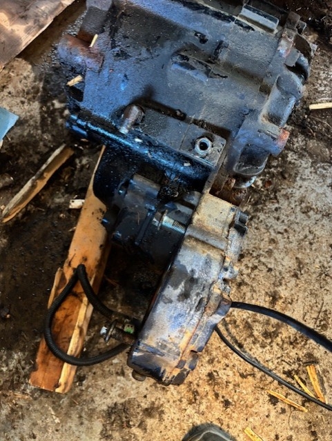

No, I don't know for sure. All I know is, when I jacked the TC up, only the rear wheels were turning. But on the ground, it would move forward or backward when cold, getting warmer it would stop moving making a weird sound, then I would increase the throttle and it would start moving again and eventually stop again. It did not feel as the brakes were on. I have the front axle on the floor now. Before I open the drive motor or the axle, I am not sure what I should do next. I never to got to try it with the new hose on because the mechanic who changed the hose decided to drop the whole axle down mainly because he was not able to unscrew the bottom bolt of the drive motor. Had I been there, I would have screw the new hose on and gave it a try. Anyways, I guess I could still try the drive motor to see if it turns while it is on the ground but I have to figure out what other hoses I need to block or connect. On the drive motor, there are the 2 big hoses and then there are the 2nd speed hose and the case drain(I think), then on the axle, there are 2 hoses. I suppose, 1 for the brakes (I can probably block that one) but there is another I don't know what it is for. That's where I am at.

Almost there... I have bought 6 feet long hoses for the motor and transxale, so I can test the drive motor aside(see if turns) and transxale while on the floor. When I started the TC, I got a 50-13 error code. Because I did not extend the 4 wires Deutsch connector. Now ... my reasoning is ... If that wire matters and it did not complain about the speed sensor before while having the problem, does it mean it thinks the transxale is turning when the wheels are not !?

Update. I hooked all the hoses and speed sensor while I have the drive motor and the transaxle separated on the floor. Started the machine, forward/reverse only the rear wheels are turning but not the motor gear. Notice, I pressed the fast speed button on the left lever and the rear wheels also stopped turning while lever was in forward position. Did not try reverse. The yellow light came on the console to indicate traction control was off I suppose. From a youtube video (howIdidit) they are diagnosing a drive motor issue with a Bobcat skipsteer. They are capping the hoses and taking pressure. While not engaging forward/reverse they say it should read charge pressure and when engaging it should read 5,000 or so psi. Anyone agrees with this test ?

Charge pressure is within specs on high idle. Almost 350 psi. I capped the front drive hose and only get close to 1000 PSI but I know the drive motor does not turn when the hoses were on. You wrote drive loop pressure, do you mean connecting the 2 hoses together and testing pressure on a T type connection?
