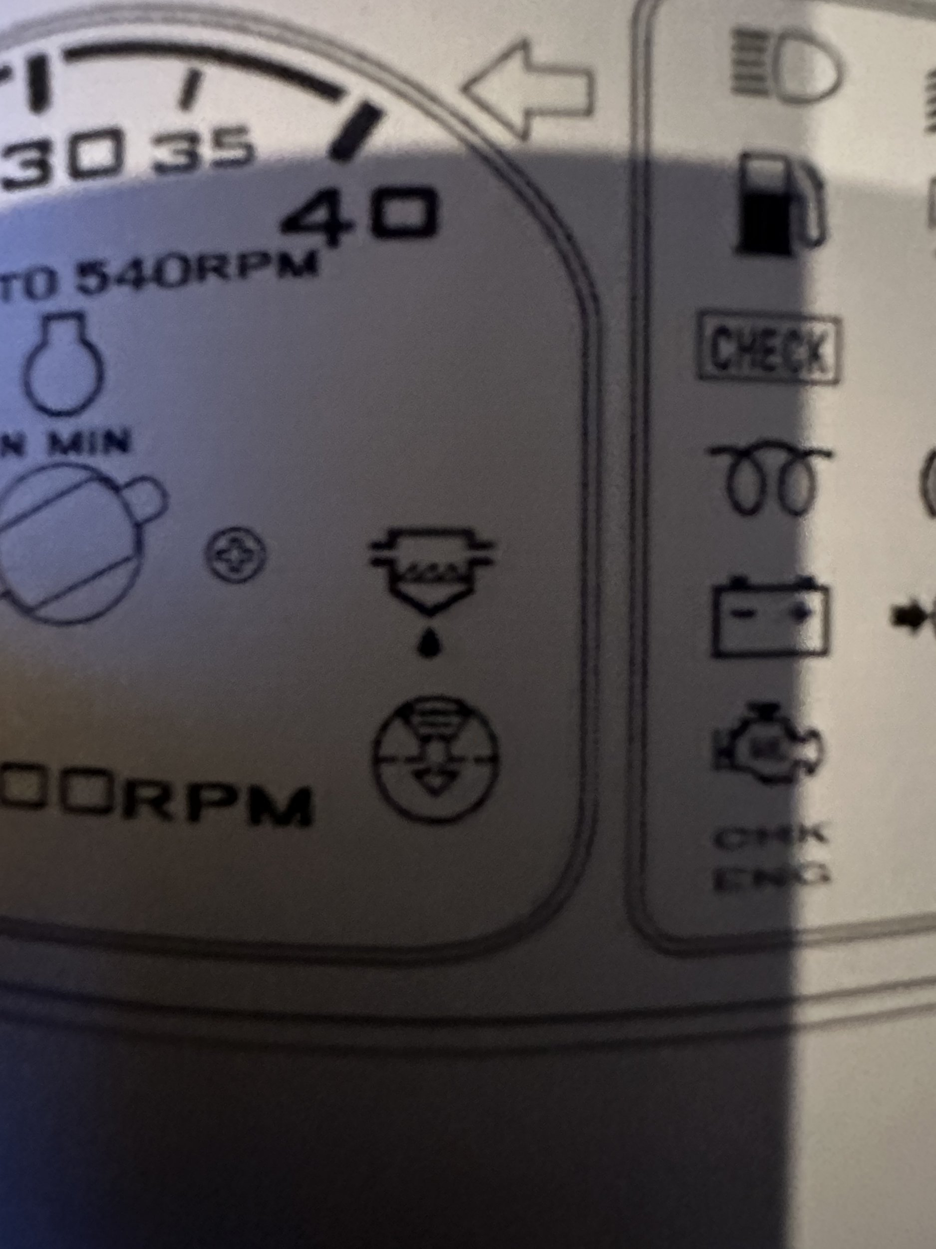

I’m trying to find out what the square light is. The one that has a swigley line through it. It started coming on and off and it is the only one that doesn’t have a definition for it in the manual. Can it be water in fuel light?

If it's the image that looks like a funnel...
/ 2017 Mahindra 2545 dash warning light #3
Do you mean this? I don't own a Mahindra, but I would interprete it as water in fuel indicator.
Drain your primary fuel filter. It only takes a drop of water for those to react. They are sensitive and so is your fuel system to water.
