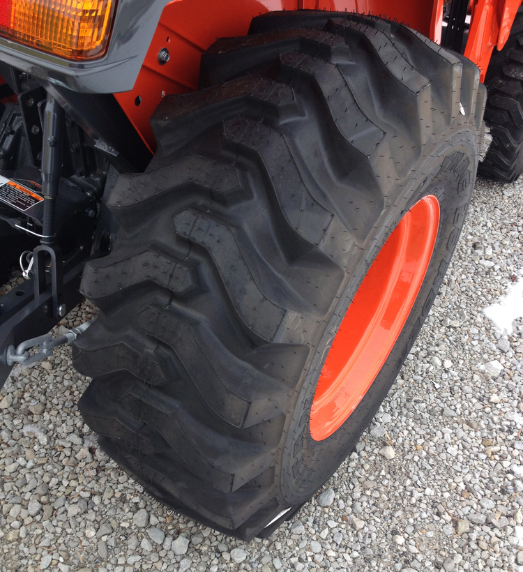

Newbie here. Just took delivery of a Kubota B2601. :) Im getting ready for winter and doing my chain homework. I will need chains for sure. Has anyone out there had to put rear spacers on their B2601 for chains to fit? I want F&R chains. Im being told by one dealer I can put chains on the front and got a price- and the other dealer told me that absolutely no chains on the front of a B2601. In his words, he said that tractor is not made to fit chains on the front. Reallly? It sure as heck looks like the chains will fit on the rear- it is close. I was looking at the Tru Grip 225s for the rear. Anyone out there have chains on a B2601 F&R and without spacers?? I really dont want to pay for spacers if not really needed....pretty darn expensive. But I need chains for winter.
I welcome any advice you all might have.

I had the previous generation B, and it did not have enough room for chains between the rear tires and fender with R4 tires but I suspect there would have been enough room with Ag tires. What type of tires do you have?

Google Wheel spaces for Kubota. or buy from Kubota dealer in Vermont as they deal with this stuff often. Most Kubota dealers know nothing about spacers. Longer studs required. Max spacer you need is 1-1/2"
Front chains Amazon.com: GDP-:cool:: Automotive
GDP-070 or GDP 060 will fit front. Buy a spare set as they are not heavy duty. Heavy duty will not be good for front axle. These are fairly harmless and still help with traction.
Load your tires.

Thank you. They are the R4...not the AG tires. Hope the photo of the tire comes thru.
I am finding mixed opinions from the dealers...frustrating. Prices for the wheel spacers are all over the place...

One thing for sure: for ease of installation the X chains are far better on the R4's than ladder style chains, though I do suspect you might get a tiny bit more traction out of ladders.
