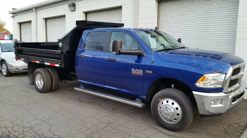

I've had them all my preference right now (because they've given us the best service) is ram. Here is a picture of the last one I ordered.
