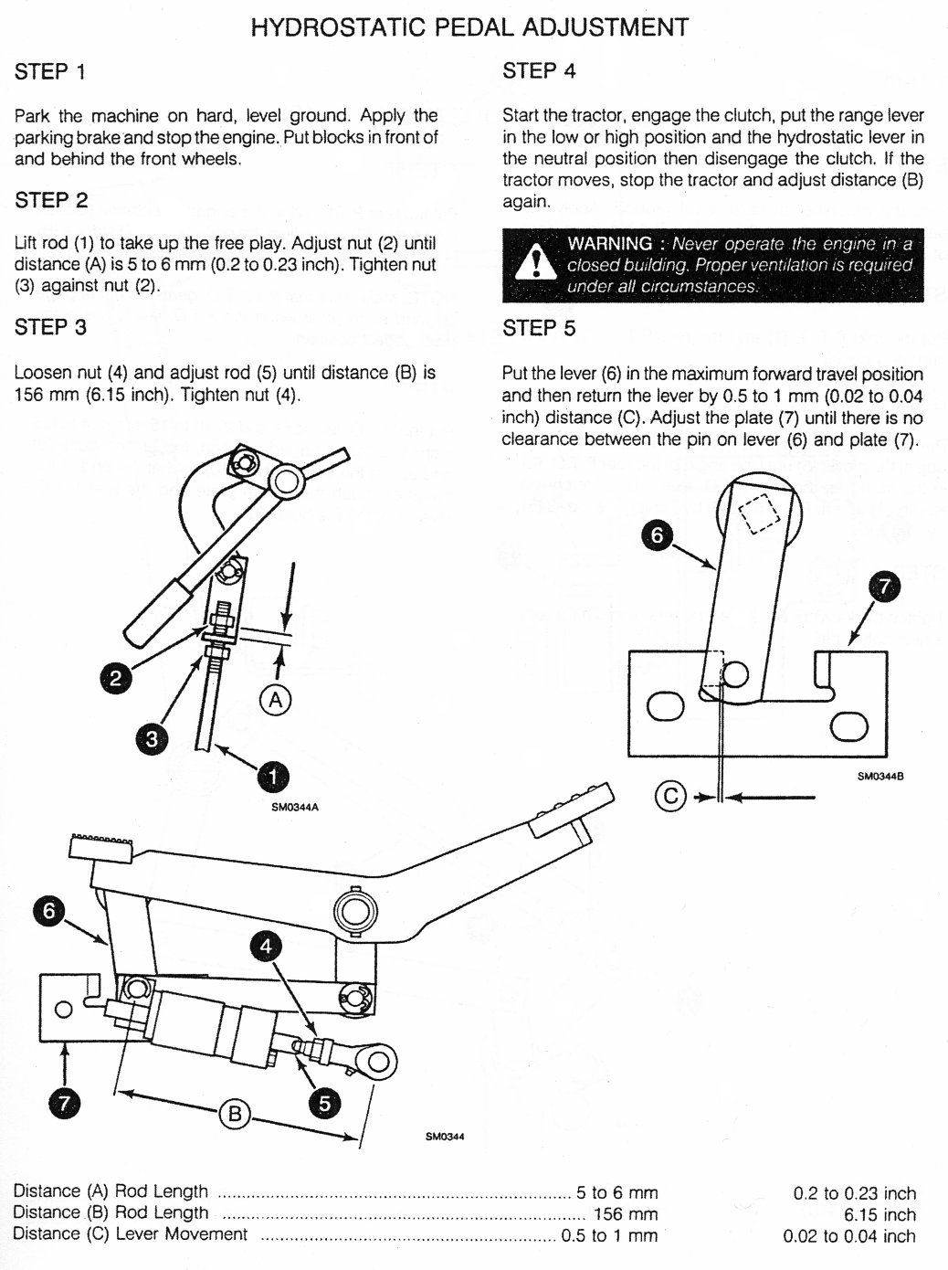

I compared the diagram to my HST linkage, and alas, it's not remotely similar, oh well-- the 2015 setup is very much simpler. I see only one bolt/locknut that might be the culprit, but it's accessible from the side and I'm pretty sure the service manager said I need a look from below (not the side) with a flashlight to even see it, so dunno. Will investigate further.
   / 2015HST crawling forward with foot off the forward/reverse pedal #12
Sorry about that. I should have added my book is for the 1533/1538.
#13
Here are the instructions for adjusting the hydrostatic drive pedal on the 15-series (2015, 2615, 3015):
   / 2015HST crawling forward with foot off the forward/reverse pedal #14
Thanks very much! Will report back.

Glad I came across your post 5 years later. Hoped on you figured your issue out as I bought a 2015 last year that is having forward/reverse drift such as described in this thread.
I’ve made the adjustments as per the manual but the reverse drift continues to get worse and worse.
I’m thinking that I need to pull the forward/reverse damper and rebuild it. I’ve tracked down explodes views of the damper assembly and it looks to be rebuildable. There are some o-rings that may have likely failed or aged out.
Did you resolve your issue and if so, what was it?
