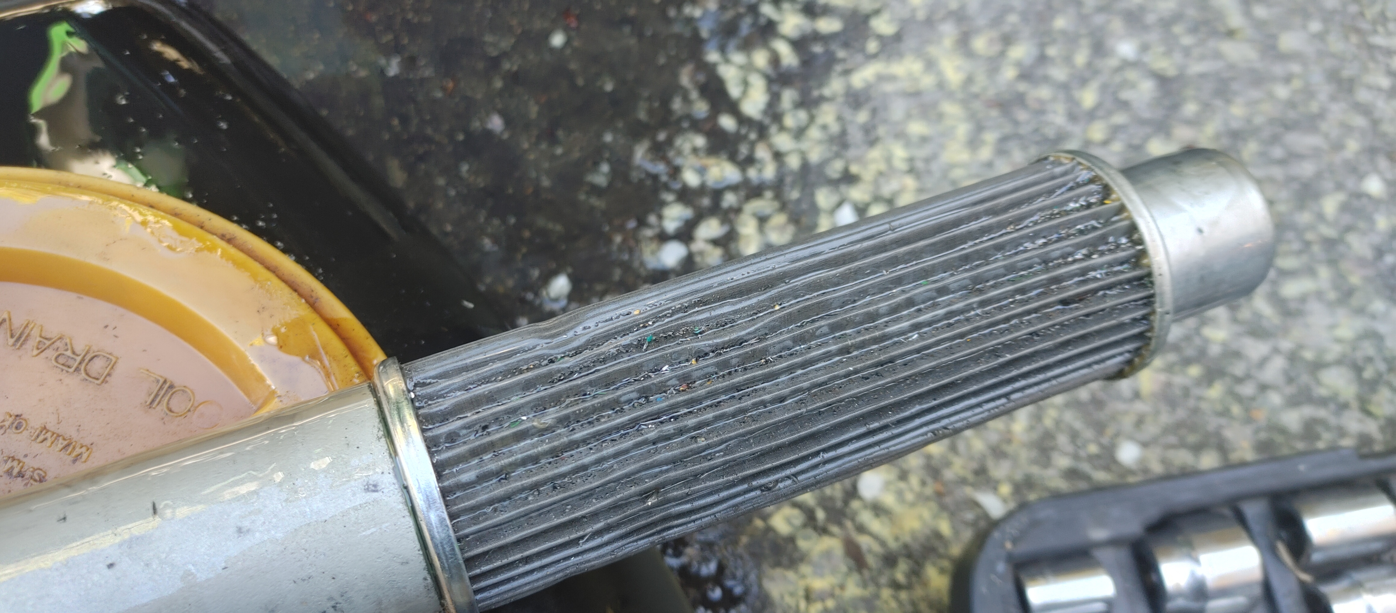

/ 2015 John Deere 5075 #22
JD recommends changing the fluid after the first 300 hours, then I think every 600 hours. Obviously it was an issue for me, and I was told by the mechanics at JD that screen clogging is a pretty common issue that they see, and that I could either pay them to fix it, or change the fluid, and clean the screen off myself. I think I changed mine at like 220 hours, and it was maybe 150-160 hours when I started experiencing the issue. After changing it, no more squealing and whining, and it now goes F to R without kicking into neutral all the time. I mean if you've got 400+ hours and you've never changed your transmission fluid in a 10 year old tractor, it's not a bad idea if you're having transmission issues anyway. Your tractor's good and broken in by this point. You're likely going to have some metal in there from everything wearing into itself. Mine absolutely did. But do as you will I guess.

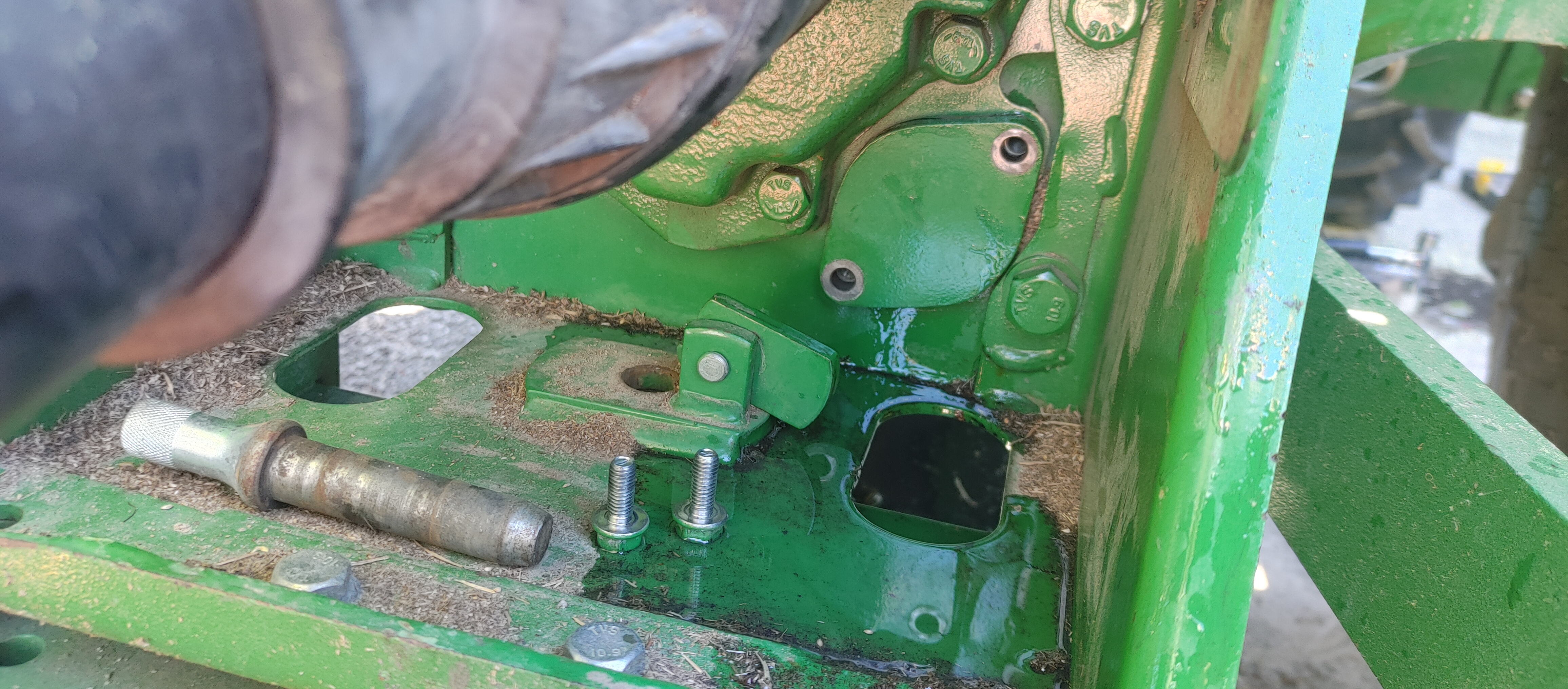

/ 2015 John Deere 5075 #25
The only issue my 18 5075E ever gave me was my shuttle wouldn't go forward to reverse and vice versa without kicking into neutral, or using the clutch. It would also humb or squeal sometimes. Turns out the screen filter in the transmission likes to clog especially during breakin, and changing the trans/hydraulic fluid sooner than the manual recommends is a good idea. Basically it was just restricting oil flow which was my issue. If you've not changed your trans/hydraulic fluid after 400 hour it would be a good idea. That screen inside the transmission definitely picks up a lot of trash, and debre.
It's located behind this cover by the PTO shaft.
Interesting looking screen and location, by any chance do you also have a similar 2 or 3 bolt cover under the rear housing?
The reason I ask is that I have heard that JD used the Branson rear and transmission in some of it's 5000 series tractor. That looks just like the screen in my rear housing that feeds the shuttle clutches of the transmission. And I also have a magnetic plug in the bottom of the housing.
