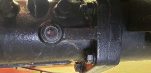

Oh yeah! the sight glass in the front axle. I read, do not over fill and I understand that. Would this be considered overfilled? If someone could comment on this I would sure appreciate it. Thanks...

Welcome to tractor ownership! I also recently purchased a Kioti, a DK 40 SE. Mine has a touch over 400 hours, and also needed oil and filter changes. When I looked in the owners manual, it stated to take the sight glass plug out and fill until it comes out. I left mine in, and filled until I just saw the oil in the sight glass, about 1/4 - 1/3 up the glass. In your pic, it is difficult to tell where the oil is, but I would add and watch carefully, once you see the oil, then stop and recheck after it levels out in the axle.
