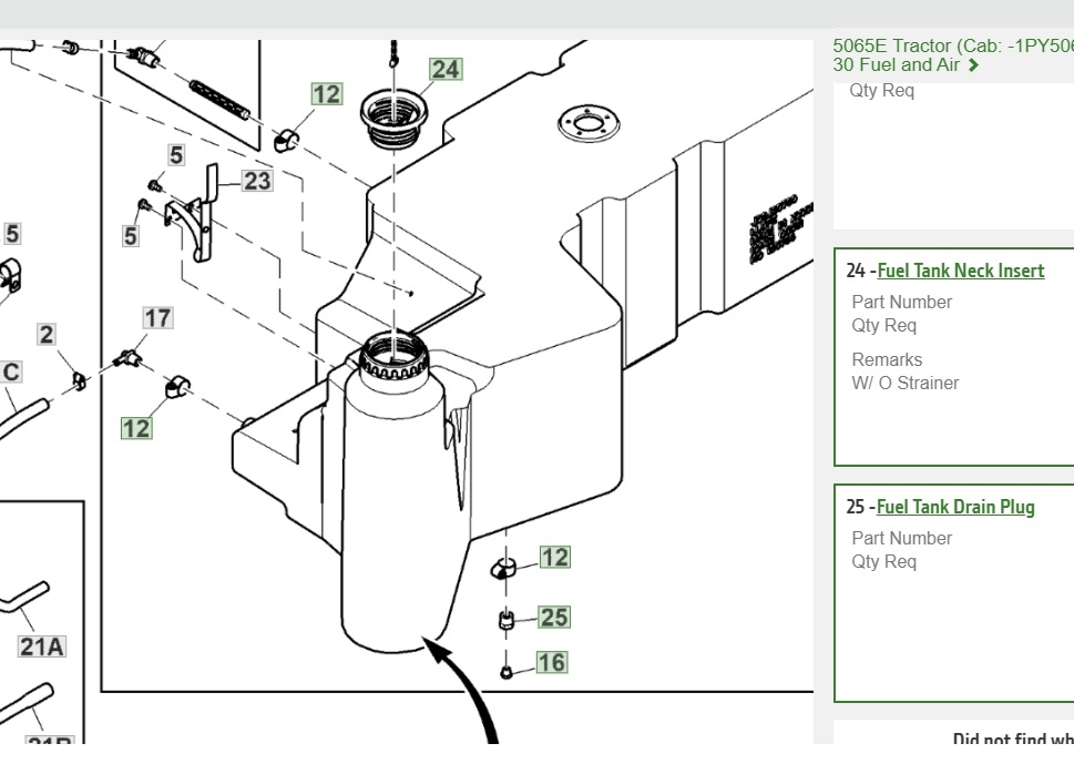

Some have that strainer and some do not. Here is schematic of one that does not.
   / 2012 5065E fuel pump question
#15
On the earlier tractors for sure there is a strainer in the tank outlet. Some are part of the fitting, some are totally separate depending on age, serial numbers ETC. Its not hard to remove, just a "drain the tank" project.
That looks like it. I haven't messed with it yet; I just looked for it last night when I got home and saw it. I'm not sure how it works, it's very odd looking.

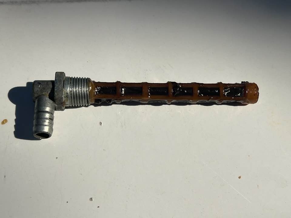

I’ve not had the issue with my Deere’s but I believe theirs a fine screen/ filter in your tank that your fuel supply line hooks to. I don’t think it’s to much of a job to extract it from the outside and clean or replace it.
It's taken me longer then I expected to do this because it would run fine for just putting a round bale out, but I just got a load of hay and I wasn't able to move it all without the tractor dying on me. It felt like it ran out of fuel, and then I would have to pump the primer after letting it rest before it would start again.
I did a YouTube search for the screen in the fuel tank and was able to see what the issue was. I removed the screen in my fuel tank and it was totally blocked by scum. I cleaned it off and put it back in, and the tractor runs great!!!!!
When it happens again, I think I'm going to through the screen away and install an inline fuel filter with a valve that is easier to remove without draining all the fuel in the tank. That was a mess!!!!
