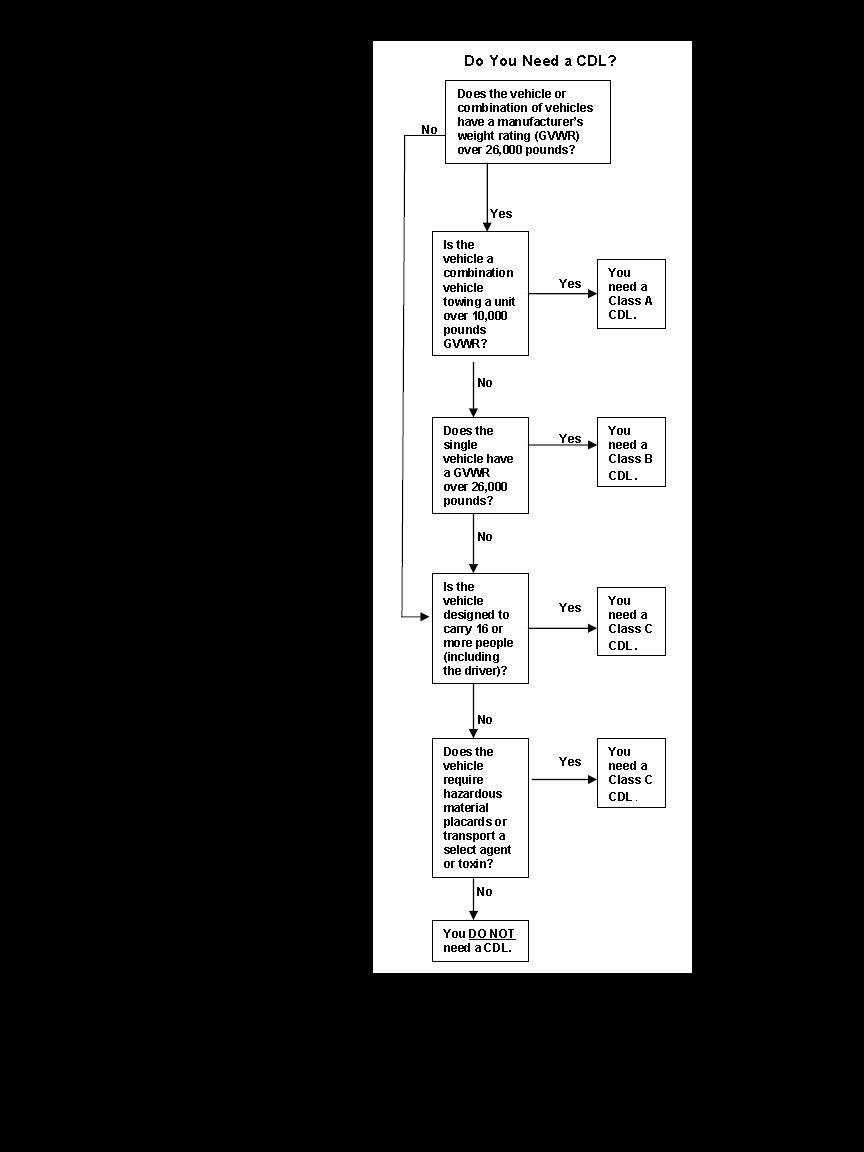

This right here is the Federal guide lines states had to go with. They can make stricter laws, but they at least have this minimum. They only go by GCWR, with truck trailer combo's, GVWR does not matter. Each state has written the terms in there own way, and in most cases in leagelese. Going by this to tow a trailer in excess of 10000 lbs if your truck is rated for over 26000 GCWR you do need a CDL. It does not matter if it is for personal use or not unless it is an RV. Here in NY they keep changing the wording every year and the requirments. A few years ago you needs a "Non-CDL" for over 18000 lbs GCWR.
So the way I read it, you can pull a larger trailer with a truck rated at 26000 lbs, than a truck rated at 26001 lbs+. With a 26001 lbs you are limited to 10000 lbs, with 26000 it's as much as you can haul staying below 26001 lbs.
15 years ago an F350/450 you would never see pulled over. Some of these guys were hauling dozers and backhoes way over the limits of the trucks. Not anymore, now you see landscapers etc pulled over. 1 stop and the fines are huge for not having the proper license and registration. They also don't care what you register the truck for, here in NY, they go by the rating from the OEM.
Classes of License:
The Federal standard requires States to issue a CDL to drivers according to the following license classifications:
Class A -- Any combination of vehicles with a GCWR of 26,001 or more pounds provided the GVWR of the vehicle(s) being towed is in excess of 10,000 pounds.
Class B -- Any single vehicle with a GVWR of 26,001 or more pounds, or any such vehicle towing a vehicle not in excess of 10,000 pounds GVWR.
Class C -- Any single vehicle, or combination of vehicles, that does not meet the definition of Class A or Class B, but is either designed to transport 16 or more passengers, including the driver, or is transporting material that has been designated as hazardous under 49 U.S.C. 5103 and is required to be placarded under subpart F of 49 CFR Part 172 or is transporting any quantity of a material listed as a select agent or toxin in 42 CFR Part 73.
Commercial Driver's License Program (CDL/CDLIS) - Federal Motor Carrier Safety Administration
This is true however besides Kalifornia there is very little difference between the Feds and any one state as far as the CDL requirements. That said NY has the most restrictions and endorsements of any of the states.
I am glad you jumped in here. NY's website does a pretty good job of clearly saying what can and can not be done with a standard DL.
But GVWR is how they get GCWR, and trailer has to be over 10k GVWR.
But NY requires Non CDL licenses that fall into the same weight brackets as CDL's, correct?
Classes of License:
NY's site clearly states that JB's example of 28k can be driven with a class D/standard DL.
Drivers with Current Class D Licenses. A driver with a Class D license can now operate a passenger vehicle, a limited use automobile, or:
* A truck with a GVWR of 26,000 lbs. or less that tows another vehicle, and the other vehicle has a GVWR of 10,000 lbs. or less
Which is the same thing the Feds say here. (In non legalese).
Question 6: A driver operates a tractor of exactly 26,000 pounds GVWR, towing a trailer of exactly 10,000 pounds GVWR, for a GCWR of 36,000 pounds. HM and passengers are not involved. Is it a CMV and does the driver need a CDL?
Guidance: No to both questions
