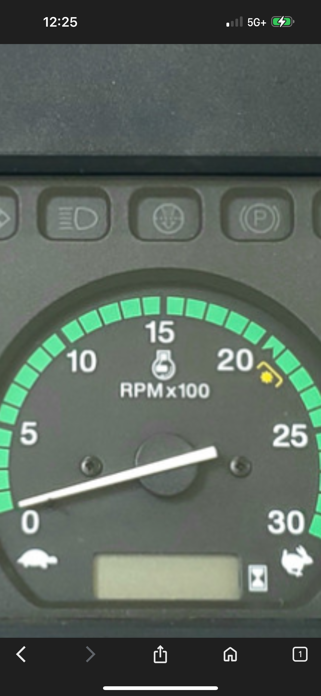

Can someone tell me what the center icon is circle with arrow pointing down?
/ 2011 5530 dash light #3
restricted air filter light

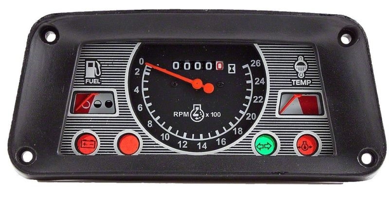

Yep. I actually added that to my Ford. It shares the bulb with my pre-heater.
My Repro dash had an unused socket. It's the red one next to the battery light. I just printed the symbol on a clear label and stuck it to the bulb lens. Just a little extra wiring while I was in there gave me the pre-heat light and the clogged filter light.

Thanks yall sorry it took so long to get back on here things got crazy around the house yesterday after work. I appreciate yall taking the time to answer. I had my tractor in the shop getting new vacuum lines new power steering cylinder and some other things done. Mechanic called and asked if I’d seen that light on before and I hadn’t and he wasn’t sure what it went to either.
