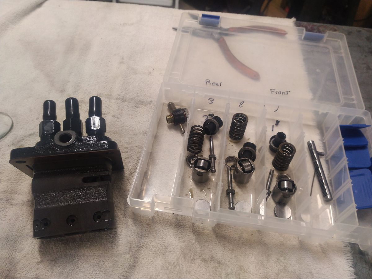

So,, got the pump out, the rack was hanging up for sure.
Disassembled on the bench,, the middle control sleeve (gear) had 2 damaged teeth.
Now,, I took a "small parts box" and labeled each section #1, #2, #3,, so I could leep the parts organized and separate.
That said, I think there is a roughly 25% chance I mixed up the plunger on 2 and 3,, but have no idea if I did or not.
I pulled the guts out for #1 hole, put everything in slot #1 in my organizer,
I pulled the guts for hole #2 and put them in the slot #2 in my organizer,
I pulled the guts for #3 and as I was putting them in the slot for # 3 (in the organizer) and noticed a plunger laying on the Towel.
There was no plunger in the #1 slot of the organizer, #2 had a plunger with it's parts.
I am ~90% sure I was looking at the numbers on the 1st plunger I pulled (#1) and then laid it on the towel.
So I am assuming there is no way to tell if I switched up plungers on 1-2 or not.
The "spacer" under the roller for #2 is 1.5 thousands thinner that #1 and #3 (1 and 3 spacers are the same thickness.

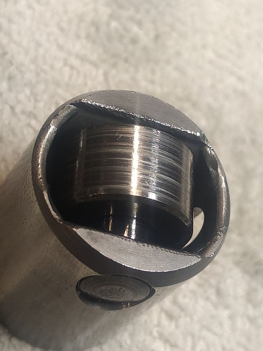

Also, the rollers on the lifters look a little "scorn" ?

Lol.. Fkn kids.!!
The plungers r mated to its barrel.. with that said..try to fit the plungers w it’s barrel..
DO NOT FORCE IT.!!
If it won’t go, grab the other one and try..
I’d be happy to reassemble it for u WITH NEW gears, gaskets and seals..
But seeing u took it apart.. it costs extra..
Shoot me a pm.

Forgot to mention the rollers.. they’re perfectly fine.. unless it’s got a flat spot..

The odd sized shim is in the #2 (center)

So finally shook some time out to put the CK20S back together.
I found the Control Sleeves (gears) on a site called "Finditparts.com for $10 each,, I debated a few days about ordering from them,, I went ahead and ordered. They arrived 3 days later and looked to be genuine Zexel/Bosch parts.
Assembled the pump,, installed, tangled with the steering hydro line to get the rest back together and she runs like a dream.
