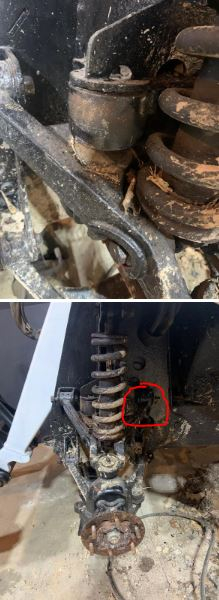

Update... First off, I wanted to say thanks to aelsnow for the new rear fenders. His generosity and contribution to my project can not be overstated.
Last night I removed the front wheels to get new tires on them and actually got a chance to mess around with the A arms. For the several months that I have owned the machine, the arms have yet to move. They have been resting on the stops since day one. Even when lifting the front end in the air.
So last night I started removing the shock bolts/nuts and A arm bolts/nuts to see what I could find. Amazingly when I got to the 4th and final bolt for the Driver side A arm and started to loosen it up, the entire assembly "popped" and returned to its normal unloaded state. I proceeded to remove each bolt, apply grease and reinstall. Does anyone know of any other way to lubricate these joints. I don't see any zerk fittings.
Same thing happened on the Passenger side. Unfortunately on the passenger side the rubber bump stops stayed with the A-arm because the bolts that hold them to the mount had rusted out of the rubber mounts. I imaging the drivers sides are close. Will work on replacing those next.
I am anxious to get the new tires under it and see what happens when I set it back down.
