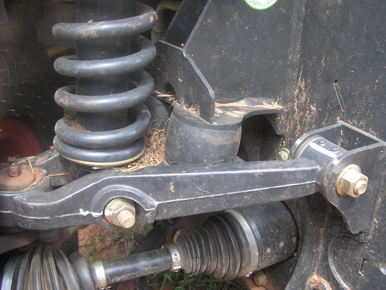

The front a-arms have zero movement. The a arms rest on the rubber bushings all the time. When loaded, unloaded and even when I have lifted the entire machine off the ground on a lift. Is that normal? The rear a-arms have a good amount of travel. It's like the front is just for looks and is really a solid assembly.
I have no experience with the D Series, but would think that it should move just like the F Series does.

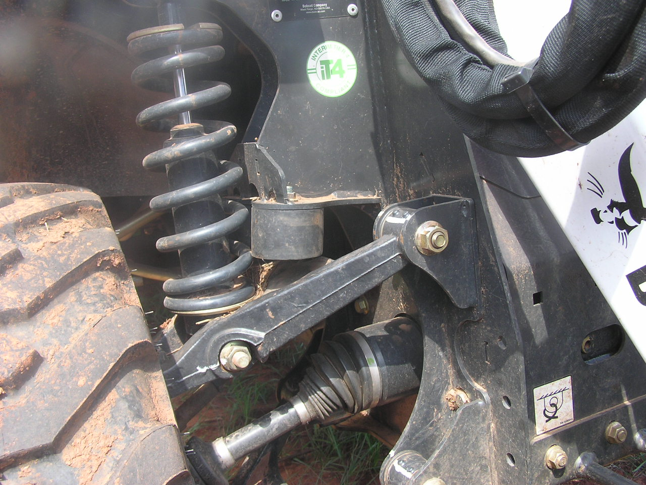

Raised the front wheels off the ground:
A arms are hanging down:
And compress the rubber with weight in the bucket:

Maybe the rubber snubbers get old and stiff. If they do, you would lose your limited wheel articulation.
   / 2007 Toolcat - no traction, stiff suspension, differential lock? #4
regardless of the rubber block when the machine is lifted up the arms should allow the axle to drop, something is preventing the arms moving, when no load is on the front the rubber bumpers should not be touching, my current machine has traction control my old one had rear axle lock, its setup always had one front and rear powered so something is not working on yours

Appreciate the help everyone. The photo above with the a-arms gapped below the rubber bushing when up in the air is just what I needed to see. Mine do not drop. Something must be froze up in the shock or a-arms I am betting. Will have to dig in and will let you know what I find out.
Laurencen, I do get one front and one rear going but that is a much as it will do. I will need to investigate why the rear axle lock isn't working. From the service manual, I can't see anything that goes to the rear differential that would actuate it. There is a "brake" hydraulic hose that runs to it to engage the brake, but that is all.

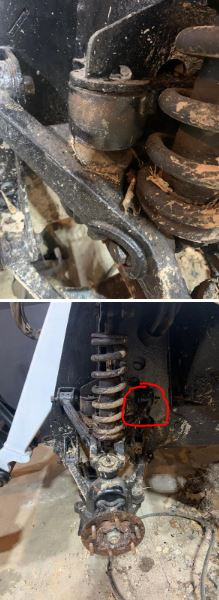

Update... First off, I wanted to say thanks to aelsnow for the new rear fenders. His generosity and contribution to my project can not be overstated.
Last night I removed the front wheels to get new tires on them and actually got a chance to mess around with the A arms. For the several months that I have owned the machine, the arms have yet to move. They have been resting on the stops since day one. Even when lifting the front end in the air.
So last night I started removing the shock bolts/nuts and A arm bolts/nuts to see what I could find. Amazingly when I got to the 4th and final bolt for the Driver side A arm and started to loosen it up, the entire assembly "popped" and returned to its normal unloaded state. I proceeded to remove each bolt, apply grease and reinstall. Does anyone know of any other way to lubricate these joints. I don't see any zerk fittings.
Same thing happened on the Passenger side. Unfortunately on the passenger side the rubber bump stops stayed with the A-arm because the bolts that hold them to the mount had rusted out of the rubber mounts. I imaging the drivers sides are close. Will work on replacing those next.
I am anxious to get the new tires under it and see what happens when I set it back down.
