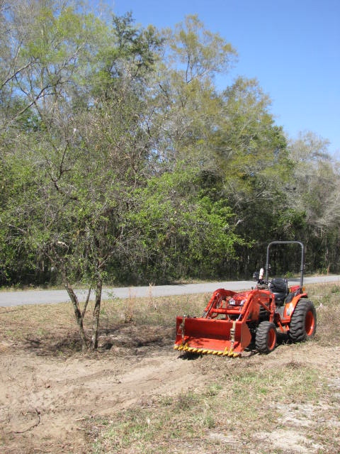

1.) I sold my Kubota B3300SU tractor loader package, 406 engine hours, for $13,000 in January 2014. It was always stored in a humidity controlled garage.
I purchased it new in February 2012 for $17,200. The way I figure it my depreciation cost was $10 per operating hour. Cheap entertainment and a good reason to buy a new tractor every two to three years.
(Yes, I had fuel costs, service costs and one $250 KTAC insurance deductible on a FEL repair.)
2.) HST is IDEAL for roto-tilling. It is a rare Kubota 'B' that is not sold with HST.

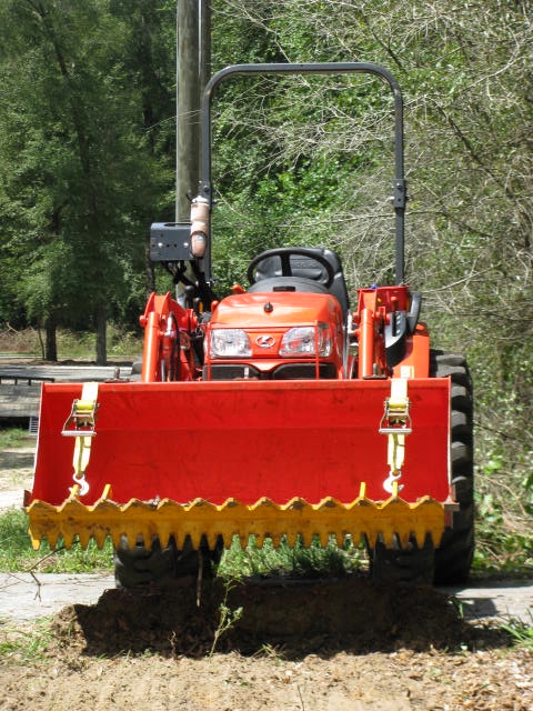

3.) I did not load the rear R4/Industrial Tires of my B3300SU, however I did mount an implement on the Three Point Hitch as counterbalance whenever I expected to lift anything over 50% of loader capacity. Usually I ballasted with a Box Blade. Weight cantilevered behind the rear axle is more effective, pound-for-pound, than filling the tires. The front axles on 'B' tractors are light, you need to be careful not to stress front axle and front bearings overly much when carrying a heavy load in/on the FEL.
Liquid in the two rear tires has the advantage of lowering your center of gravity, improving stability at all times.
4.) Mid-PTOs to power MMMs are optional on most of the B's. Do you have one?
I'm not keen on MMM's. With an MMM mounted you have no ground clearance.
Once you get the tractor home you will discover dozens of uses for it.

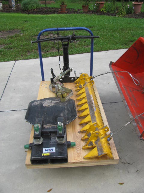

A Ratchet Rake is extremely useful on a 'B' bucket. You buy RRs from the T-B-N store. Here are some U-Tube videos: https://www.youtube.com/results?search_query=Ratchet+Rake
As you are new to tractors, I highly recommend purchasing Kubota's KTAC tractor repair insurance: https://www.google.com/search?client=safari&rls=en&q=ktac+insurance&ie=UTF-8&oe=UTF-8&gws_rd=ssl
A Handi-Hitch will allow you to tow from your Three Point Hitch: HANDI HITCH
IMPLEMENT LINK: http://www.lsuagcenter.com/NR/rdonl...45263BDD8/11557/pub2917tractorimplements1.pdf
