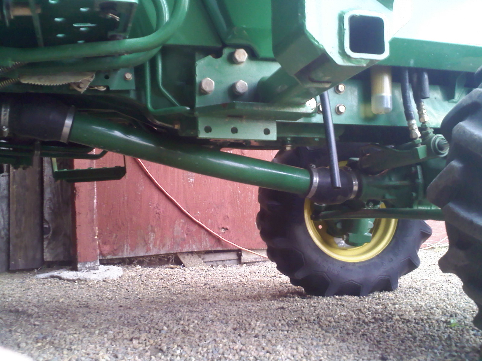

My tie rod is bent (from the factory) to avoid hitting the differential case. That's why I pointed out to be sure about it, before you started bending on it. It's a 2001 model, so it could very be different from yours. This is the best pic I could find of it from my files.
Kebo.....I dont think yours is bent from the factory. :laughing: I'm pretty sure you must of hit something with it. Mine was a 2001 model too.....and it was meant to be straight. :thumbsup:
I can remember thinking the same thing when I bent mine for the first time. I wondered if it was supposed to be like that? :) nope...Its easy to bend 'em.
/ 2007 JD 790 4WD problems #11
Ok, so it may be that mine was supposed to be straight, I just know I didn't bend it!! I bought it with the tie rod already like it is, but the toe in is good so I don't mess with it!! What's funny is that in that pic it looks like it's bent to the rear of the tractor, but part of it is also bent towards the front too (can't see it in that pic). It would take a heck of an effort to bend it like a snake (by getting hung up on stumps, etc) and yet both wheels still be pointing in the same direction.
