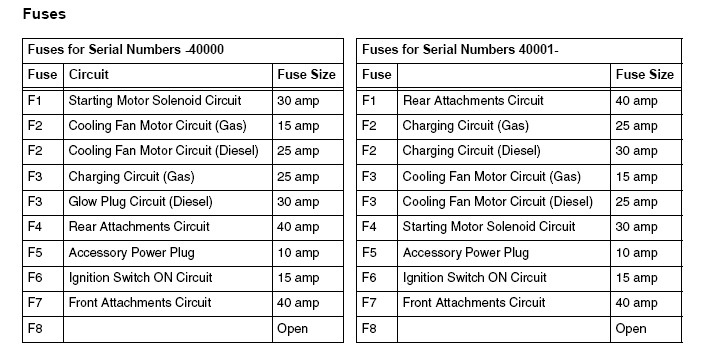

It sounds like there's something wrong with your clutch. I haven't had to work on one, so hopefully someone else can help. Below is a fuse box "map" from the manual for my '08. Hope it helps.

my fuse block has two rows but I got the dealer to help me with the "mapping" Thanks again for your help
