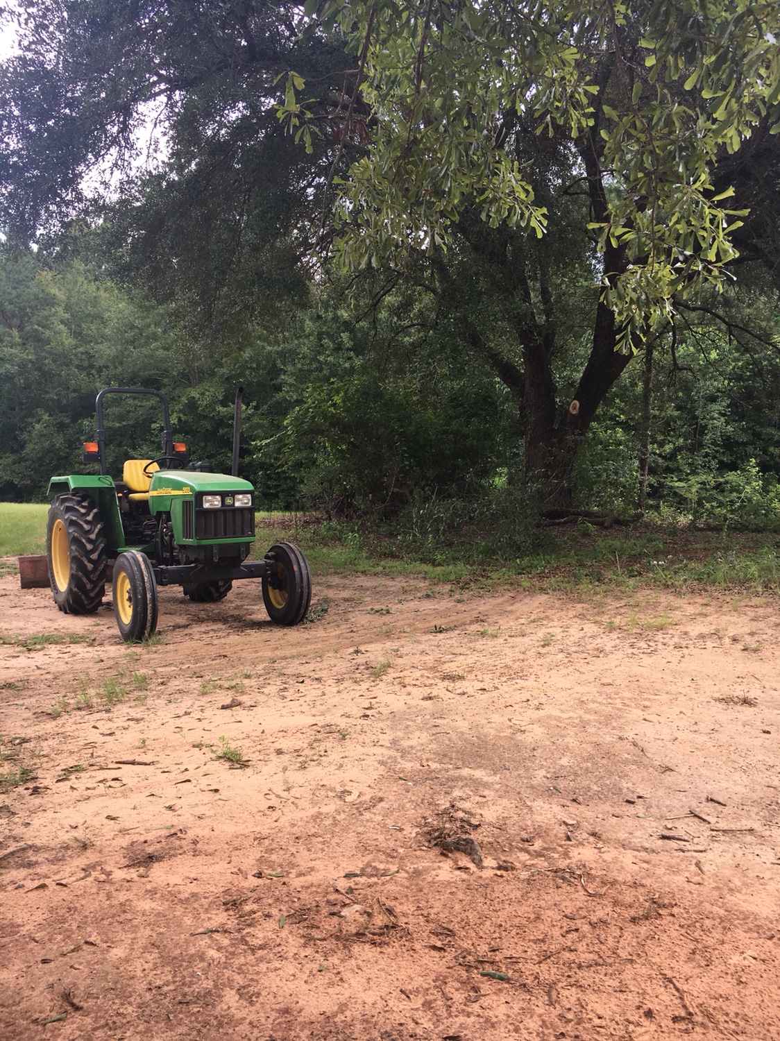

I am a stickler for maintenance and it is stored out of the weather. Here is a recent picture, about 6 months ago. It has about 400 hrs on it. Use is to grade and bush hog. IMG_4713.JPG

Had one until a year ago when I traded it in for a 5520. Awesome tractor. Mine had around 700hrs on it. Did everything I asked of it and kept on giving. Was afraid I was going to break it pulling my round baler.

Mine is the same way. Pulling my bush hog, box blade or disc, it just keeps working. Simple and reliable.
