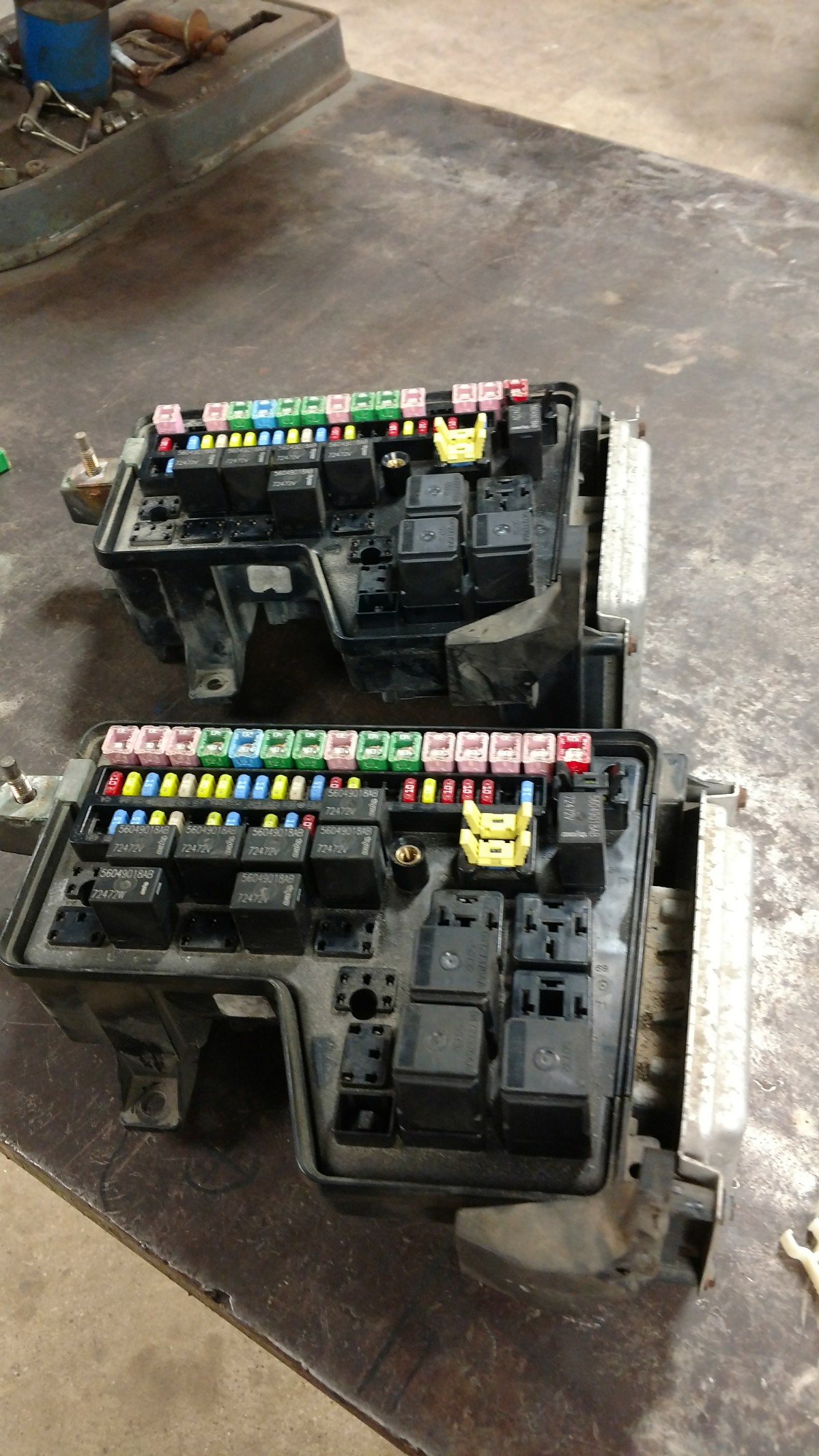

Update.
Chmsl works. Bad bulb.
Left tail light works....I broke a ground to it the other day when frustrated and pulling tape/wireloom off.
Backup lamps on that side also works. Now that ground is fixed. Right side backup has melted circuit board.
So....still left with
Left rear brake/turn don't work. Wiring from fuse box back is good. Cause it's the green wire with a white tracer, and normally has 9v on it but when 12v is applied it lights brake/turn. Manually applying 9v and it lights.
Front turnsignals just don't work. Haven't looked much at that.
Front headlights still the same. One high works, opposite side low only.
But when testing voltage on driver side at the plug, center wire ground.....from it to one wire shows 10.5v and 8v from center to other. Switching from bright to dim don't change any voltage readings (yet bulb goes out as it only works on high).
Very puzzled. Changed the FCM on the side of the fuse box with the one out of my Dodge..no change so that ain't it.
/ 2005 Dodge 1500 Electrical help
Problem solved if I can source a good part.
Integrated power module.
Basically what all the fuses and relays hook into. Its a computer of sorts. Swapped it with the one in my 3500 and everything works fine
Nicely done. Sounds like a trip to the boneyard is in order....
Stock up on dielectric grease if you are low/don't have any.
Rgds, D.
/ 2005 Dodge 1500 Electrical help #10
I suspected that was what the problem was. I just didn't know what to call it. I used to own a 2004 Cummins and was on the Cummins forums some and that was a very common problem. Another common issue is the tail light boards. Once again, I'm not sure what they are called, but its what your light bulbs plug into. They are really cheap and can be bought at a parts store. If you still have problems with the rear tail lights, I'd replace those also, they just plug in and are easy to replace.

The problem.
No parts at local yards. Had to order. Should be in tomorrow or friday

If it's just that one bubbled-up area that is the problem, I'd re-build the electrical connection with soldered-in heavy wire jumpers. Unless there was corrosion present, that may have been a weak solder connection or an undersized pcb trace.
Up here, that would be a pre-paid item, so you probably own the new one already though.
Rgds, D.
That can sometimes work on a two sided board, but if there are circuits inside the layers as well (I work on computer boards with as many as 8 signal layers as well as ground planes and power planes) it could be evidence an internal layer overheated and bubbled to the surface. Designers like to put the ground and power planes on the inside layers to help reduce signal crosstalk.
Another thing that happens is that road salt+water can short traces (looks like there are mineral deposits on the board, maybe?) and you can even have the tin "lead free" solder dissolve the copper in the circuit traces and exude crystals called whiskers that then bridge gaps to make shorts.
If he has gotten another board and it is working, I think that is a far better option than trying to resurrect the old one.

Everything is fixed now.
A boneyard entire fuse box was $200. Not worth trying to learn circuit board repair
