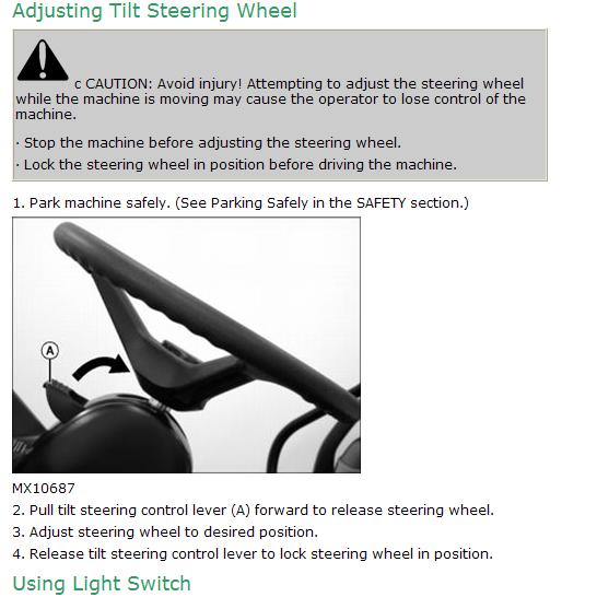

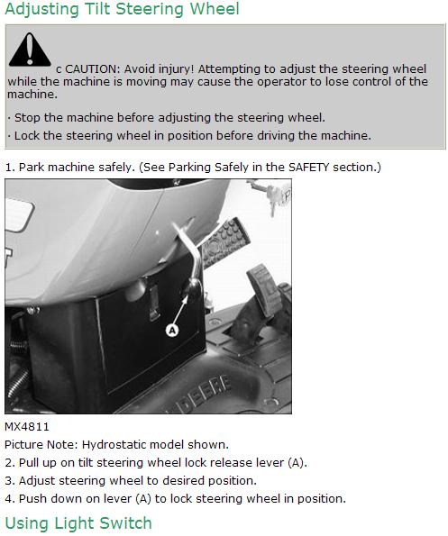

I believe that the friction lever on the 4400 was changed to a detent or caul system, such as is shown in the op manual for the 4410 (first pic) and the 4400 lever (2nd pic)
Yep, does look like quite a difference...

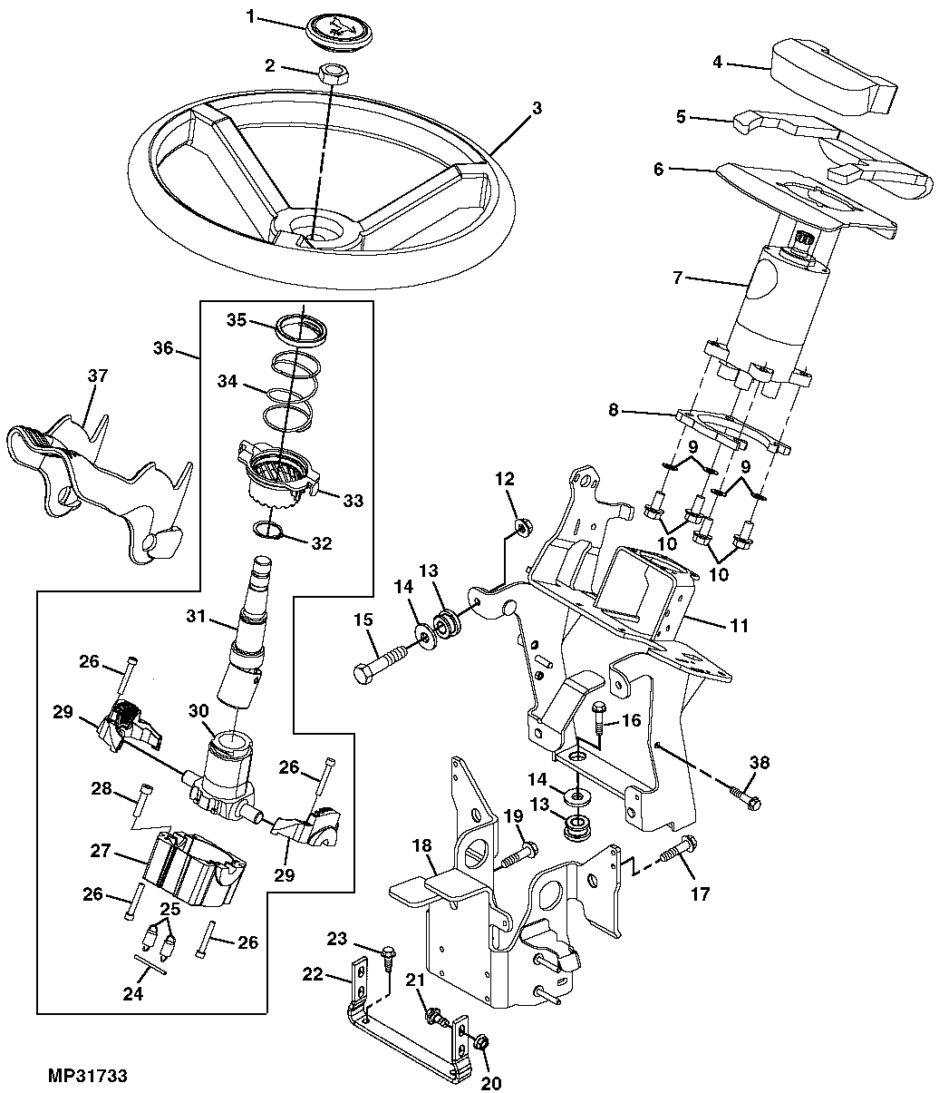

I hope the image is attached. If you look at parts 33 34 and 35, dirt could get in this where it travels on the shaft and stick. Also 33 mates with 29 (2 pieces) that are cast pot metal, and there are basically a gear teeth mechanism that when part 33 is raised, disengages and allows the wheel to move fore and aft. I found these teeth break. You may be able to remove the broken pieces and have it work - as I did.
to access this, remove the fuse box and starter switch covers, remove 4 allen bolts from the plate surrounding the power steering unit (4 hoses attached) remove the wheel, and unplug all wires to the dash panel. Remove it to see the affected area. You can call me at 209-742-4655 if you need more help. - Troy

Thanks for all the replies. Basically, nothing sticks at all. The issue is that you can't lock the column in place at all. The lever (37-in the diagram), is completely solid, it will not move or budge at all, in any direction. From the sound of things it sounds like its a compete pain in the rear to get the thing taken apart, so might have to stay that way.

It was a pain, but once I got smart and took the PROPER screws out, it got easier. If that wont move then I suspect dirt on the spring loaded column bushing. It can be fixed, and probably for free. You will need some patience, tho.

Well just wanted to do an update...I grew a pair over night and took the **** thing apart and it was a lot easier than I thought. The culprit was the latch and the two guides, all the teeth were busted off. I wanted to give a big thanks to everyone on here for the replies and tons of feedback.
