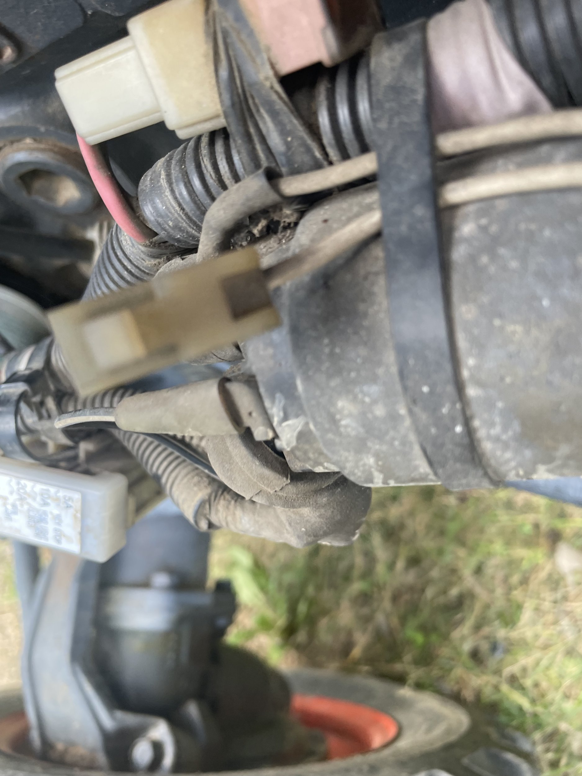

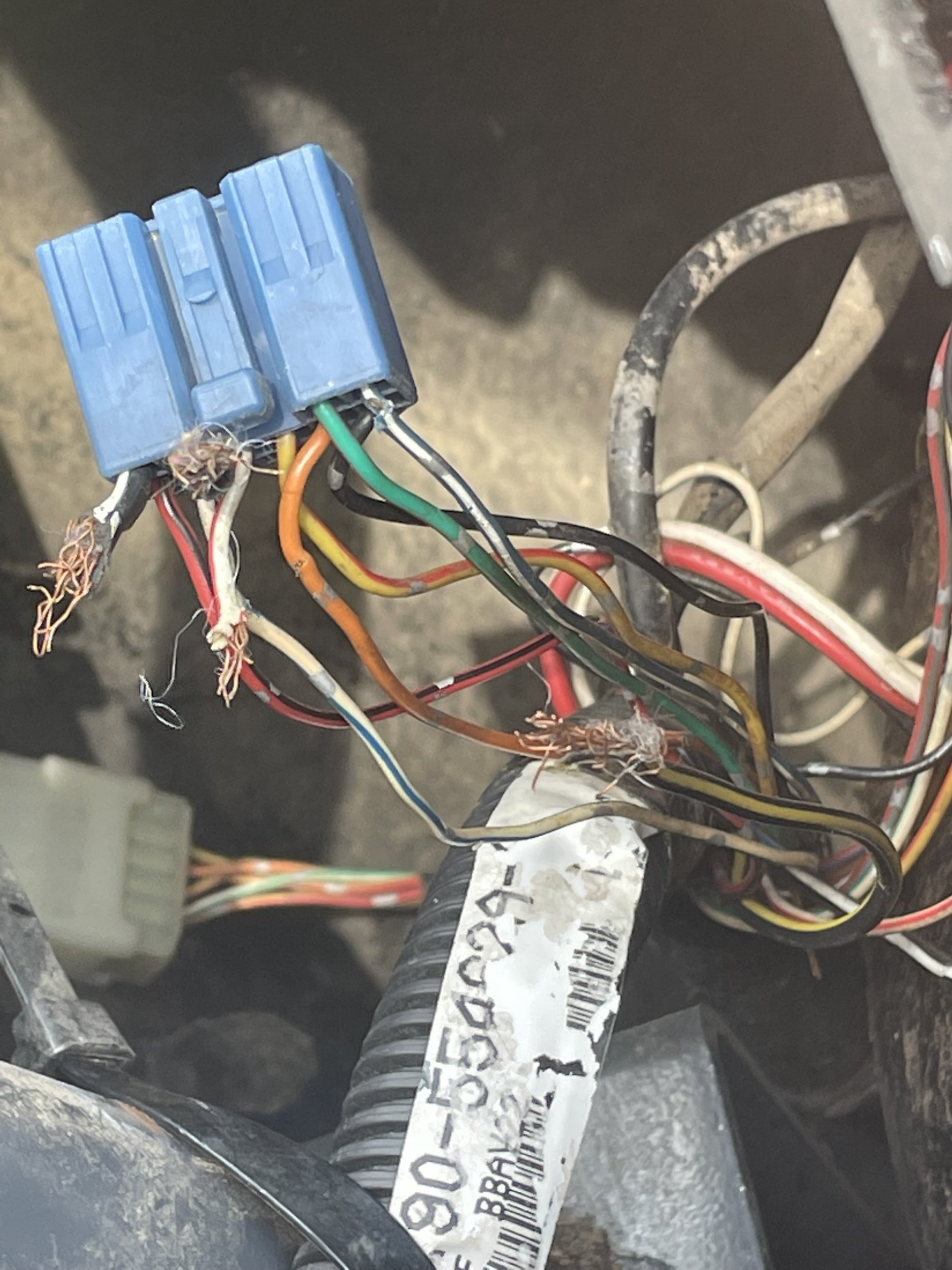

Ok found the problem, now fixing it is a huge issue.
Apparently a rodent ate through a wire harness behind the dash, I am trying to figure out if I can replace the plug or will I need an entire new wire harness? See photos below

Glad to hear you found the problem. Mice can sure do damage!
From the pictures it looks like there is enough wire to splice/solder and tape/insulate each wire back together to still use the connector, I hope so anyway. Otherwise I'd be looking to use individual bullet connectors to replace the plug or just hard wire it all together because when was the last time you used the plug?

The cheapest way would be to just splice some wires in there and replace some of the connectors in the plug if you have to. You can usually find the little connectors if they are standard ones.
You can google wiring harness pin connectors to find the right ones.
