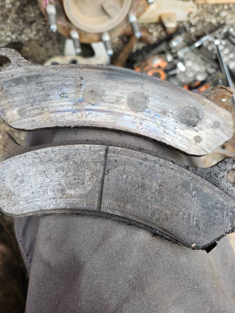

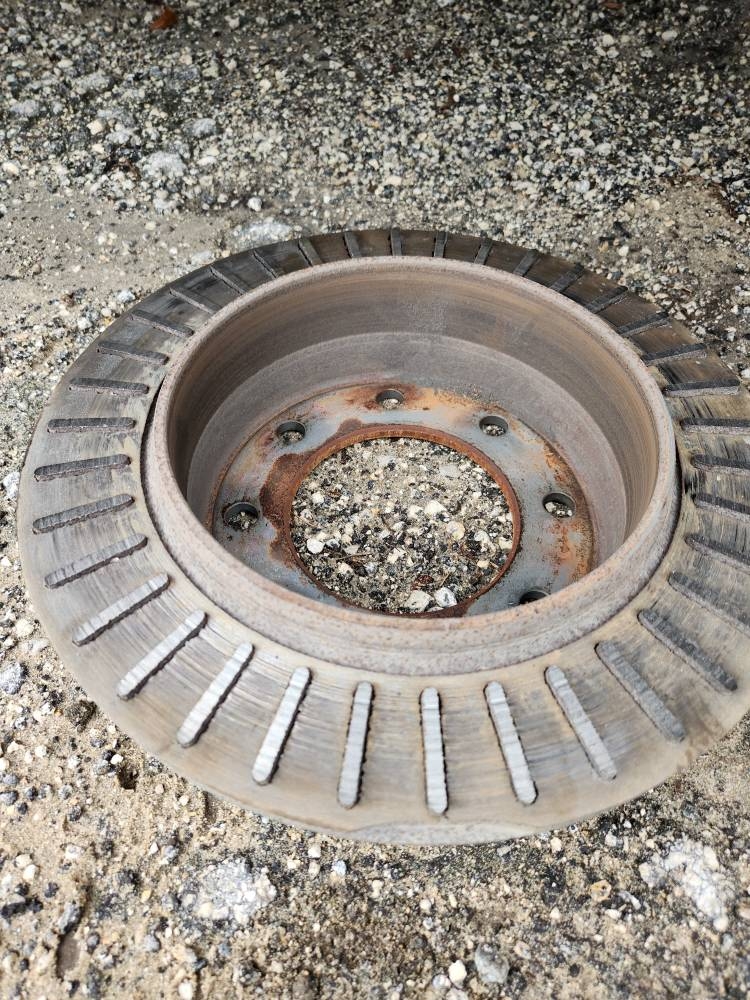

Last night, he mentions; something wrong with brakes, peddle goes all the way to floor before stopping... I check brake fluid (checked 2 weeks ago, good), nearly empty. Start looking for broken line (he admitted he was driving around in woods, so figured he snagged a line). Nope, drivers rear rotor and pad in pics. So little pad/rotor left the caliper pistons extended out so much it dumped the brake fluid.

Got breaks replaced. New rotor, calipers, and pads. Passenger side rear wheel seal is also leaving, but that's a job for another day. Explained to the boy, it could have been a $60 brake pad job, instead of a $400 whole ordeal, if he had paid attention...
Probably could have skipped the calipers; but one side getting hyper extended, if I figured I'd error on the safe side. Probably could have just got seals/pistons in a rebuild kit for 1/3rd the money, and a bit of hassle, but decided to just buy new (remanufactured).
Autozone sold me the wrong pads, so while I was at work, had boy go and get right pads; they sold him the wrong ones again. Stopped on way home, and this Autozone asked "dual piston or single"; dual; so we got right pads. Didn't realize a 1500HD could come with single piston calipers...

A 8lug 1500..is that part of the reason why it turned into a $400 brake job?
Rotors were toast, calipers probably could have been rebuilt, but just got remanuf ones. At $110/caliper, rotors at around $90, and $55 for pads. Got $40 back per caliper for cores. Apparently 1500HDs had two different set ups, dual piston, and single... GM had some weird stuff during this time, 1500, 1500HD, 2500, 2500HD, hi out put duramax, low out out duramax, heck, even saw a 2WD 2500 crew w/ 5 ft bed (bought in Mex, so not sure if it was offered in US).
