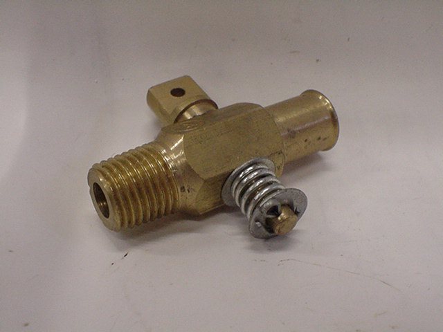

Ok great I'm going to check out everything real good tomorrow, but where does one find this fluid drain on the engine at:newhere:

Here's a diagram of my engine. It's part #35 in the diagram:
Contact
Your engine may be different.
Here is a close-up picture of the drain valve:
Turning the flat piece with the hole in it 90 degrees in either direction opens it. On mine there is a wire handle attached to the hole so you can open it without sticking your hand in. My owner's manual recommends filling the tractor before each use (with "clean river water") and draining it when you shut it down. I use antifreeze instead.
