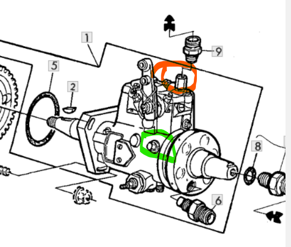

New to me 2000 JD 5210. Has 3300 hrs. This thing will start and run for about 30 seconds. Blows a puff of white smoke and will not re-start without the help of starter fluid in to the air intake. I have changed the fuel filter added seafoam. Any insight would be much appreciated.

One possibility is check valve encircled in orange is clogged. Next time engine stops operating open bleed screw encircled in green, leave slightly open & attempt to start engine. If engine starts operating remove fitting encircled in orange & check for blockage in fitting or return fuel line. IMHO using starting fluid spraying into intake is 1 OF THE MOST DETRIMENTAL things one can do to these JD engines. There's a long history of broken piston rings & piston lands from overdosing JD 300 series engine with starting fluid
