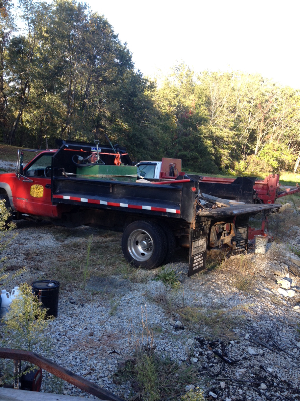

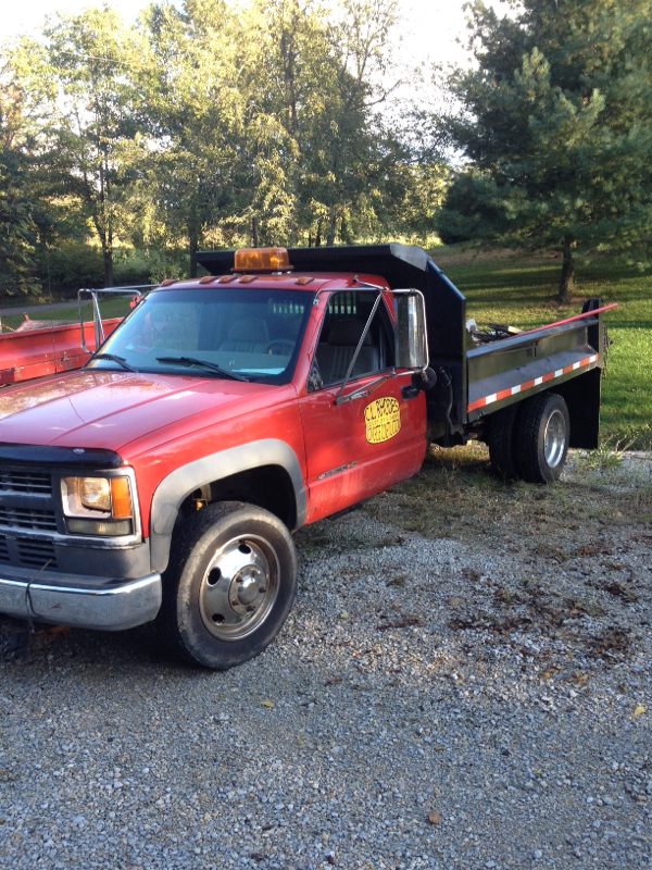

I am looking at a 1 ton dually with a dump bed. It has the 6.5 diesel with 99k miles. Seems to be in good shape. Any thoughts on this model of truck?

i wouldn't call that a 1 ton. it is the HD version it's got a 15K GVWR and is in between light duty and medium duty trucks. similar to the Ford F-Superduty from the same era. s for the 6.5 they are okay, there are common issues (like all motors) the PMD (Pump Mounted Driver) comes to mind. they get too hot

Definitely PMD's, if it doesn't have the relocation kit it will need one. Not too keen on the 6.5 myself.. Find one with the 454 in it and you'd be good. It sucks gas but at least it will run.
