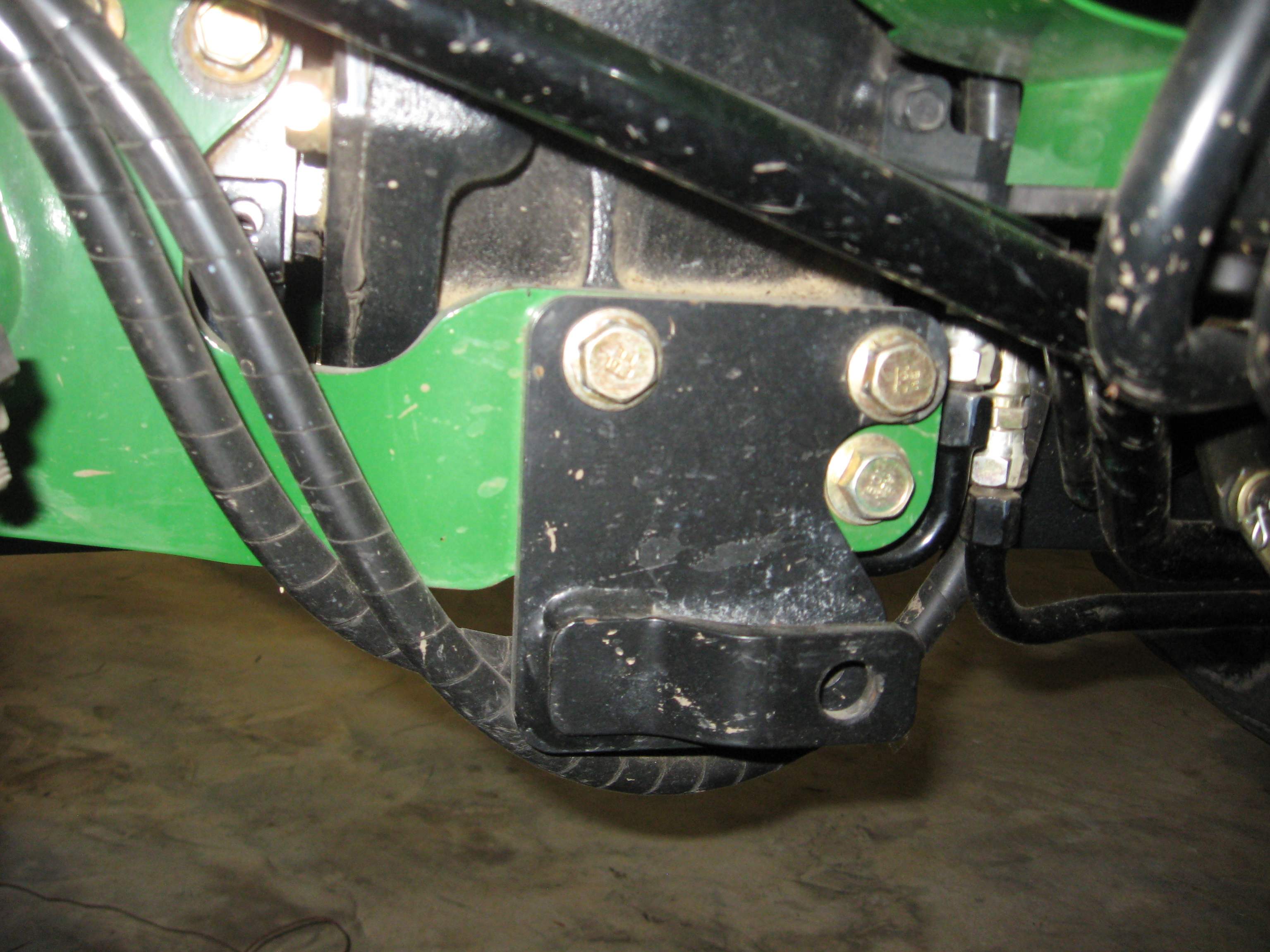

I'm not 100% sure I understand the question, but if it's like the 2520, the front MMM hanger mounts go on the outside of the loader frame, like this.
/ 200 CX Loader Install on a 4100 - Problem! #5
Yes, that is the way I installed the MMM hanger on the 4100 too. It seems like the FEL frame offsets the MMM hanger a bit further and causes it to bind with the fwd hydro pedal.

Sorry ksowinsk that was 2 tractors ago, and my memory is kinda short on this. But, I seem to remember that, what needed to be done was to take the plates that were on the tractor originally, off of the tractor (they are actually covering the real bolt holes in the frame) and replace with the brackets. Then the bolts will screw into the frame. The instructions do not tell you to remove those brackets, (and that is in the addendum to the instructions) and they look like you should not. I did not have any issues with my lines that I can remember?
