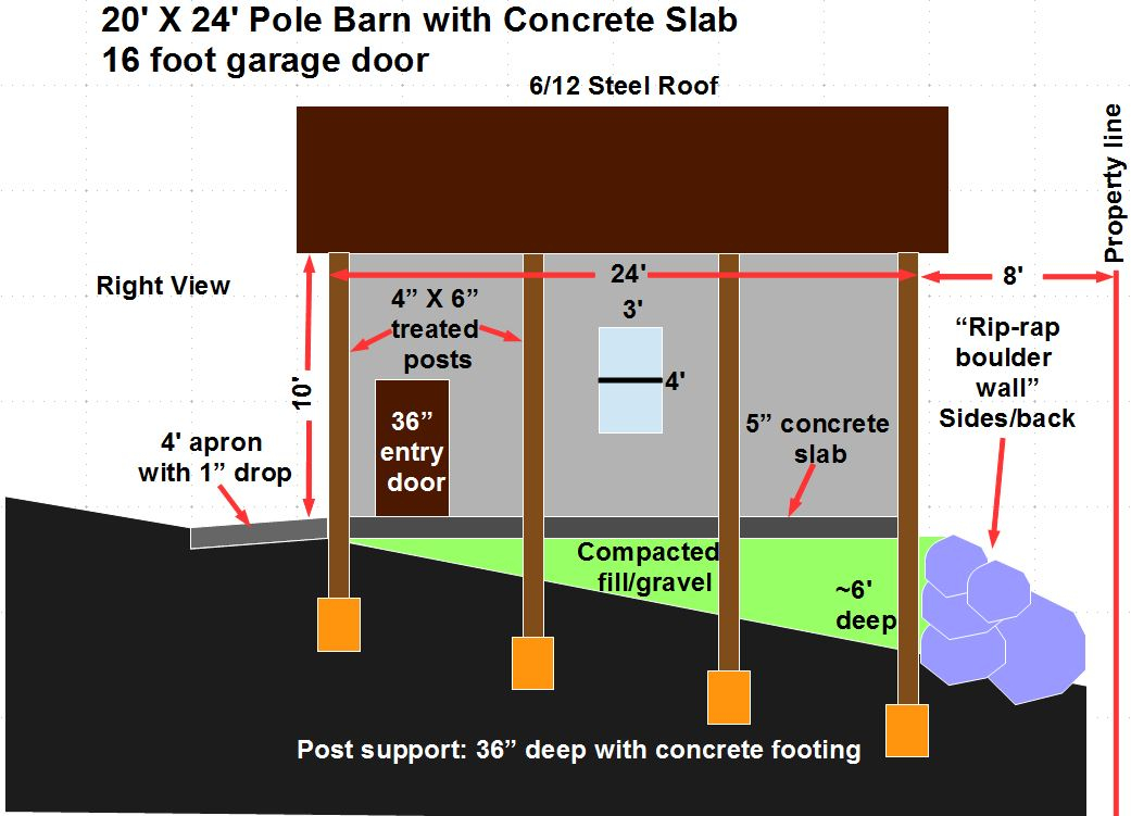

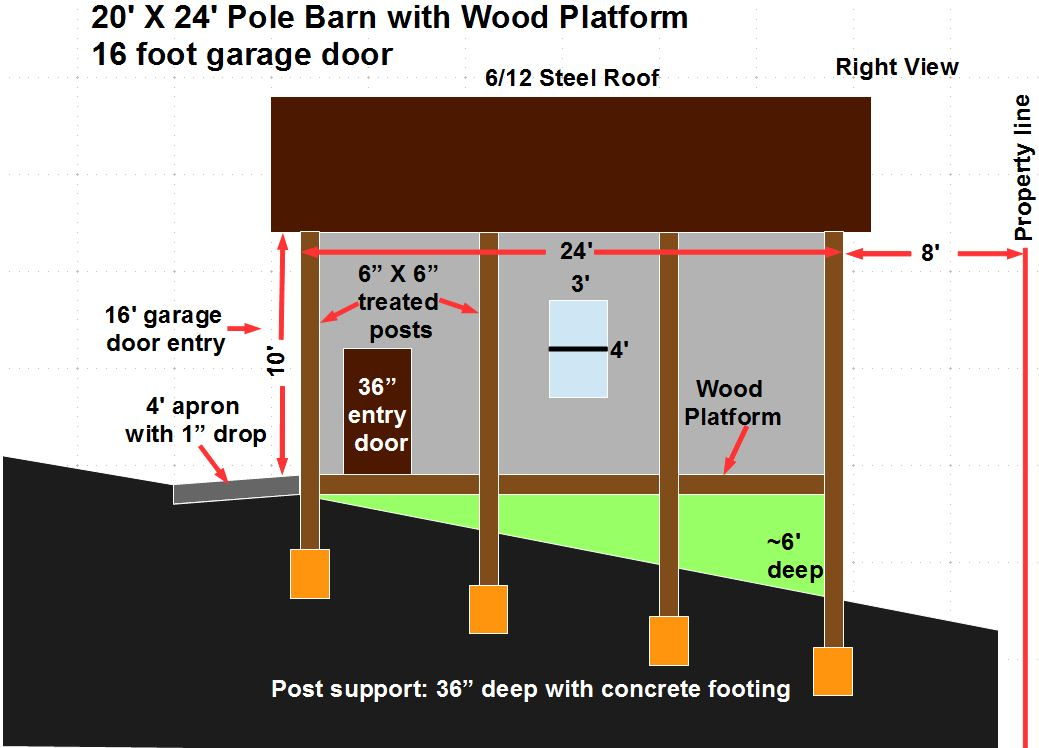

Hello to the forum - thanks in advance for any input. I read a number of other threads on the forums here about how to approach placing a pole barn on sloping ground, but not sure any of them really addressed my particular situation. Essentially the entry to the barn is at grade level (20' wide) and the ground slopes away at 25% along the 24' depth. Which means the "rear" corners of this floor would be 6' high.
See the attached images showing side views, they show two different approaches to build this barn:
1) Local contractor claims they can dig a ditch around the perimeter, then build up a retaining wall with very large rip-rap "boulders", then fill the interior with compacted gravel, then pour a slab, then build a pole structure above the slab. This has advantages of being able to park a car or truck in the barn if needed, although mostly this will be used to store a BX1500 tractor and other equipment. Disadvantage is having a huge pile of ugly rip-rap under this building (will be visible from the road). And not certain that this rip-rap "boulder" retaining wall will truly remain stable for the long haul.
2) Amish barn builder suggested a post building supporting a reinforced wood platform. This would use 6" by 6" posts, (about 22 total) with a post row under the center of the floor. The floor would be tongue-in-groove covered by plywood. Advantage is that this is much cleaner appearance on the outside (no giant walls of rip-rap). Disadvantage is that while it would easily hold a tractor and implements, might not be adequate to support a car or truck. Not a "forever" building, but would surely last as long as I am kicking.
The Amish guys are a little pricier. But I have seen their work on other barns in the area and it is excellent.

It would add $$$ to the building, but footers and a 4' poured concrete wall (actually foundation) would be the most attractive or at least look like normal house or garage construction.
Then there's simply getting some fill dirt to level this "pad" and the gradually sloping away so it could be mowed.
I'd take a guess that the concrete option might be $3-4000 and somewhat make this building look taller, at least from the back. Also your builder will need to switch from post holes and use the steel brackets to attach the posts to the concrete. That may add a few bucks for the building but it might be a "wash" as it means no hole digging and might eliminate the need for pt lumber.
I don't like putting wood in the ground anymore, I just don't trust the new treatment and one day it will rot and fail.

Side hill?
Dig into the side hill wider and deeper than than the pole barn. Dig & fill method. Get a nice gentle back slope to the excavation. If suitable use the excavated material to pad out in front of the excavation. Finally make a drainage ditch around the side and back of the excavation. Then use ordinary building procedures With cement floor.
Six foot depth may/will end up as less using cut & fill method.

Thanks for the suggestion. I've heard about this method, and I guess you could excavate into the hill,and use some of that material to "pad up" the rearward downslope area. Seems like the main advantage of that method is reducing the amount of fill - although the concrete pad still needs to be at grade on the left in these sketches, so wouldn't volume of fill be the same? Seems like you would still need a retaining wall of some sort around this earthen pad which will be supporting the concrete floor (and the weight of equipment). This is a clay area when you get down a foot or so. That stuff is pretty greasy, over time gravity will try to slide the concrete pad/gravel/earth fill on down the slope unless you have some retaining wall, especially on the downhill side.

6’ high on the downhill end is near my comfort limit for a pole barn base where you put in posts at grade (footers below frost line) but not out of the question. I’ll go take a pic of one I did that was about 3’.
Basically you build the pole barn normally but need longer posts on the downhill portion. At some point after it’s framed, you bring in self compacting gravel (#57 or #78 is my preference) and backfill and level the floor. The gravel spills out under your skirt board at a normal angle and forms a sloped berm around the barn. Once done, cover the gravel with a compactable material on the outside to finish the berm to the desired grade.
Instead of a sloped berm you can instead (or in combination) build a retaining wall on the downhill end.

When you say your comfort level, what's your concern about the 6' downslope height? Is it the pole length? These have to go 4' in the ground, so it would be a really long pole for sure. 10' just to get up to floor level, then another 15' or so above that. Can they even get a 6X6 25' post?
I hadn't heard this approach to filling inside the post array and allowing the gravel to naturally slope outward. Are you thinking about a concrete slab on top of that #57/#78 gravel?
One builder was proposing lining the post array with tongue-in-groove and filling gravel inside that box. I really didn't like that idea, because once that wood degrades/rot, the wall would burst outward. I guess if you made the box walls with 2X12 treated planks with moisture barrier that would be pretty substantial. But not a "forever" solution.
