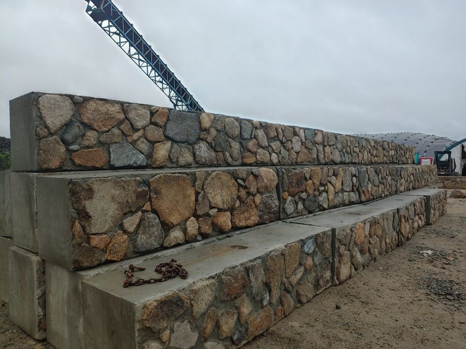

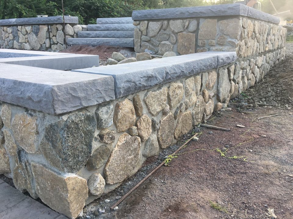

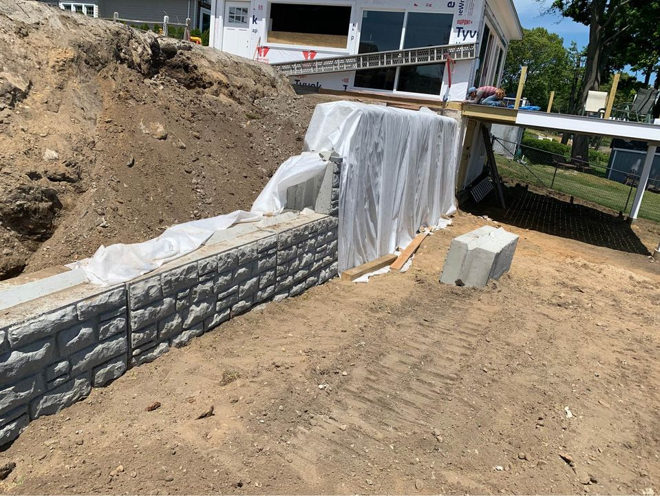

As jthibodeau89 contractor did you could easily build the area up to level with large retaining wall blocks (Mafia Blocks) & then backfill it, compact it, & pour your concrete floor & they don't have to look like an eyesore either (as jthibodeau89 showed in his pictures). They are used all the time throughout New England for this exact purpose. They are usually a pretty economical solution.
Here are some pic of ones available around here. We are bringing in some of the natural stone faced ones this spring for a project on our property. To give you an idea
Mafia Block Decorative Face Pic 1.jpg Mafia Block Natural Stone Face Pic 1.jpg Mafia Block Natural Stone Face Pic 2.jpg

Haven't seen the "Mafia blocks" before at least around here in the Midwest. Looks like those are concrete with a natural stone face on one surface? Agree that would look a lot better than large rip-rap boulders, but they have to be more expensive. Just out of curiosity, why are they called Mafia blocks? To me the biggest challenge with those blocks would be forming the corner.

Yes those are concrete with natural stone & have a really nice look... They are made of High psi/low slump vibrated concrete with New England Field Stone on the face, a 2'x2'x8' weighs 4700lbs
To give you an idea, the company I'm purchasing from gave me an approx. price of $350 - 375 for the 2'x2'x8' with the field stone delivered. The plain concrete ones are much less, but we like the look of the natural stone ones. (A plain concrete 2'x2'x8' is usually around $100 - 150)
Others are just made out of formed concrete, some with profiles some plain. Most of the companies make pre-made corners & even offer half bock sizes. Some companies offer caps for the tops, if needed, too.

I've seen some pretty attractive walls built with stacked quarry rock. Modular block walls like Keystone and Allen block can be built fairly tall and have a fairly small footprint for the actual wall, are attractive, and can be homeowner built, however they would require permits and inspections to support a building. Keystone uses fiberglass pins and can be built vertically, Allen Block has a back batter built into it. Both (and others) use a geogrid layered into the compacted back fill for strength.
