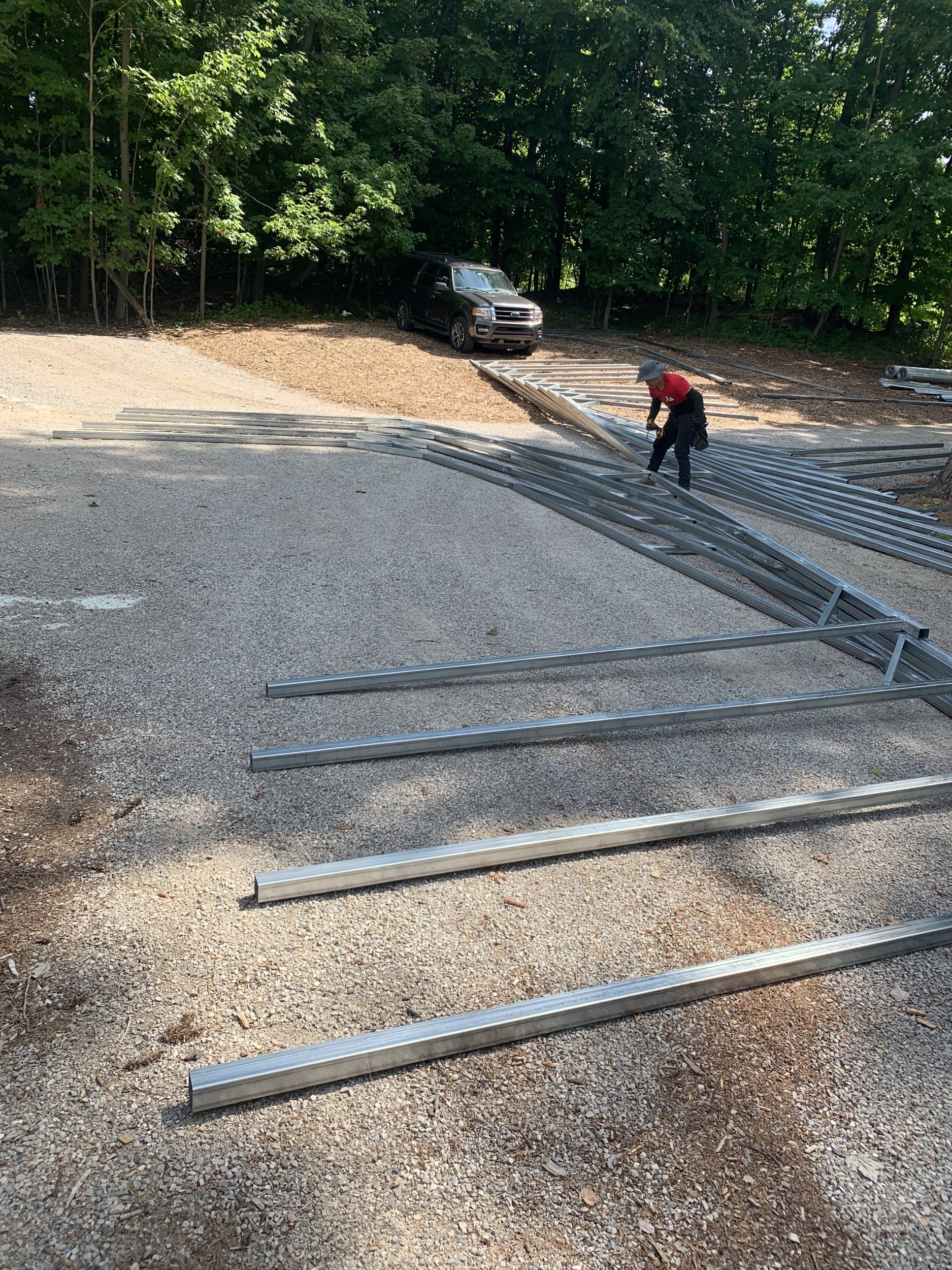

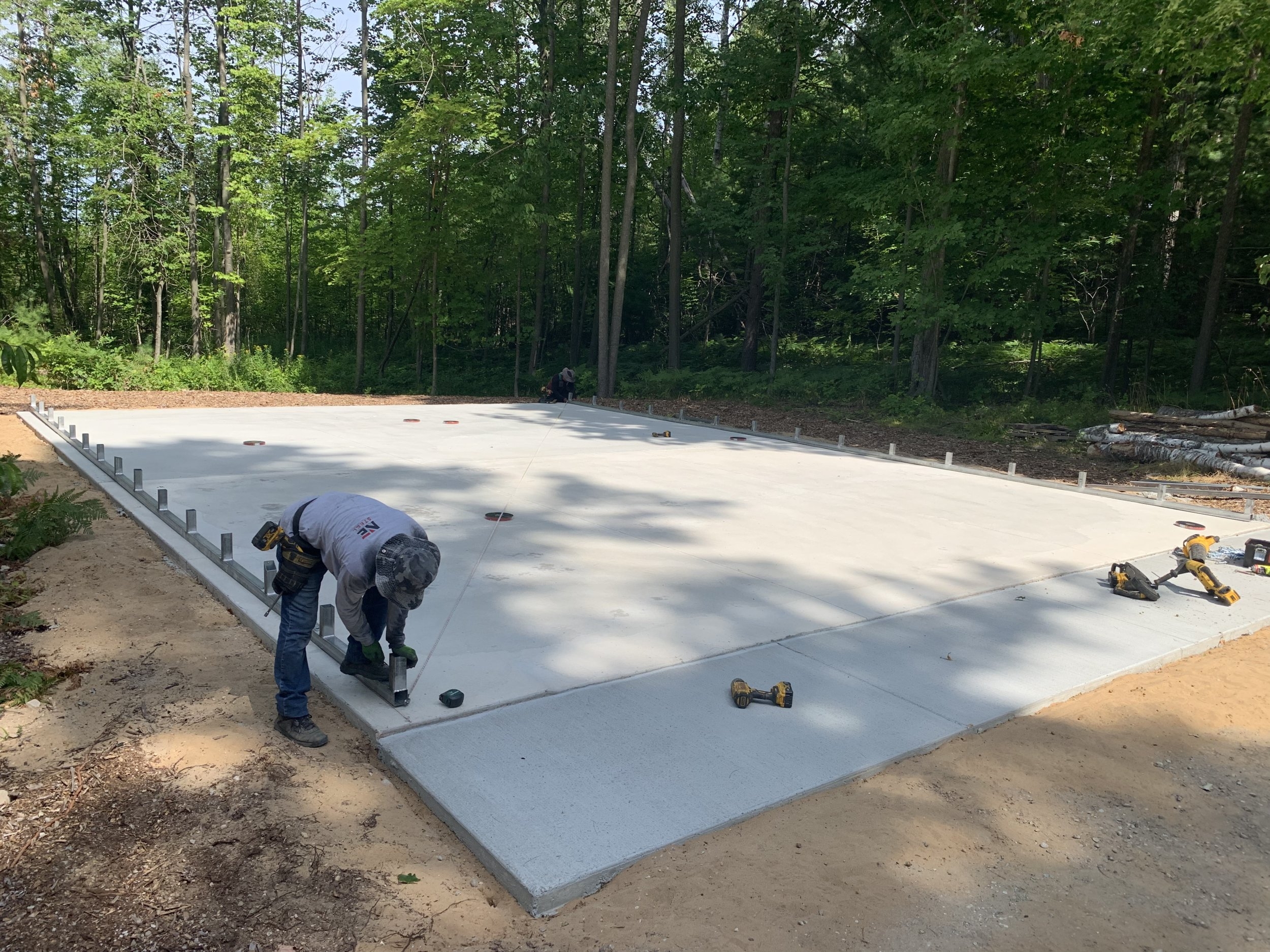

Good friend of mines neighbor needed a less expensive alternative to a pole barn, mainly just to store his boat and travel trailer. He went with a Northedge Steel building, local to us outfit sells and builds them. His is a 30x40’ , 3 fellas had it done in less than two days. You might want to check them out. Here’s a couple pics when they first started, I’ll get a finished picture next time I’m over there.
