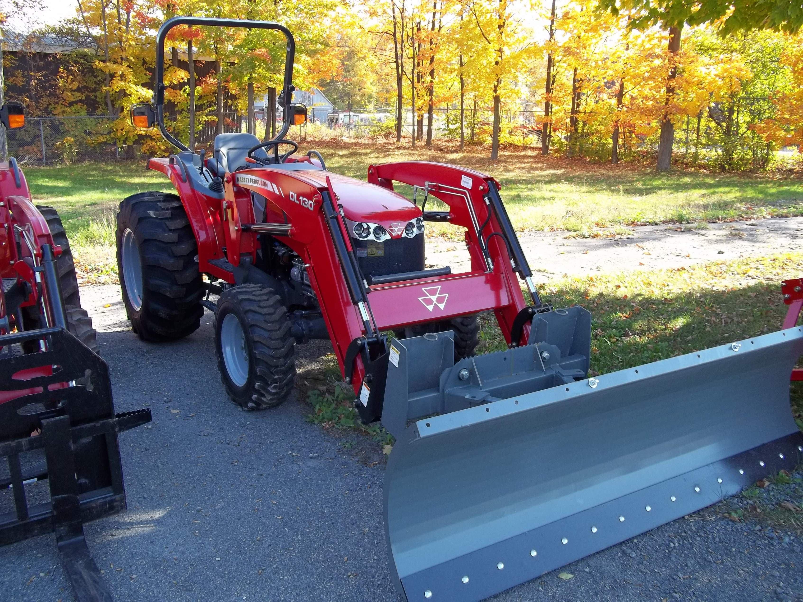

My driveway starts off by going down a hill thru the woods then follows a winding level path beside open fields at the edge of the woods. We get probably 6 feet of snow at least and all of my driveway is drift area so the truck plow option wouldnt work. I have also considered the atv option for getting into the woods as most of my wooded property is waterfrontage along a river and not very deep. Dont really need to get into the woods. My main use for a tractor is snow blowing & road maintenance. Very little of the driveway is actually my property, it is right of way to my property and is used by farmers to access their fields. Having said that, it gets chewed up real bad in the spring and fall with them hauling their equipment in. Not bashing them, they gotta do what they gotta do but if I want to prevent destroying mine & my families vehicles, its up to me to maintain it. Also, i am the only one that has a residential property there so i cant count on any help. By the way, thats a nice tractor you have, cabbed?
No cab, we spent abit more than we wanted to already and I've got all my ice fishing clothing already, so I figured I would keep the tractor simple as I could.
