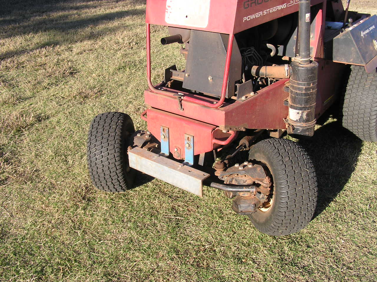

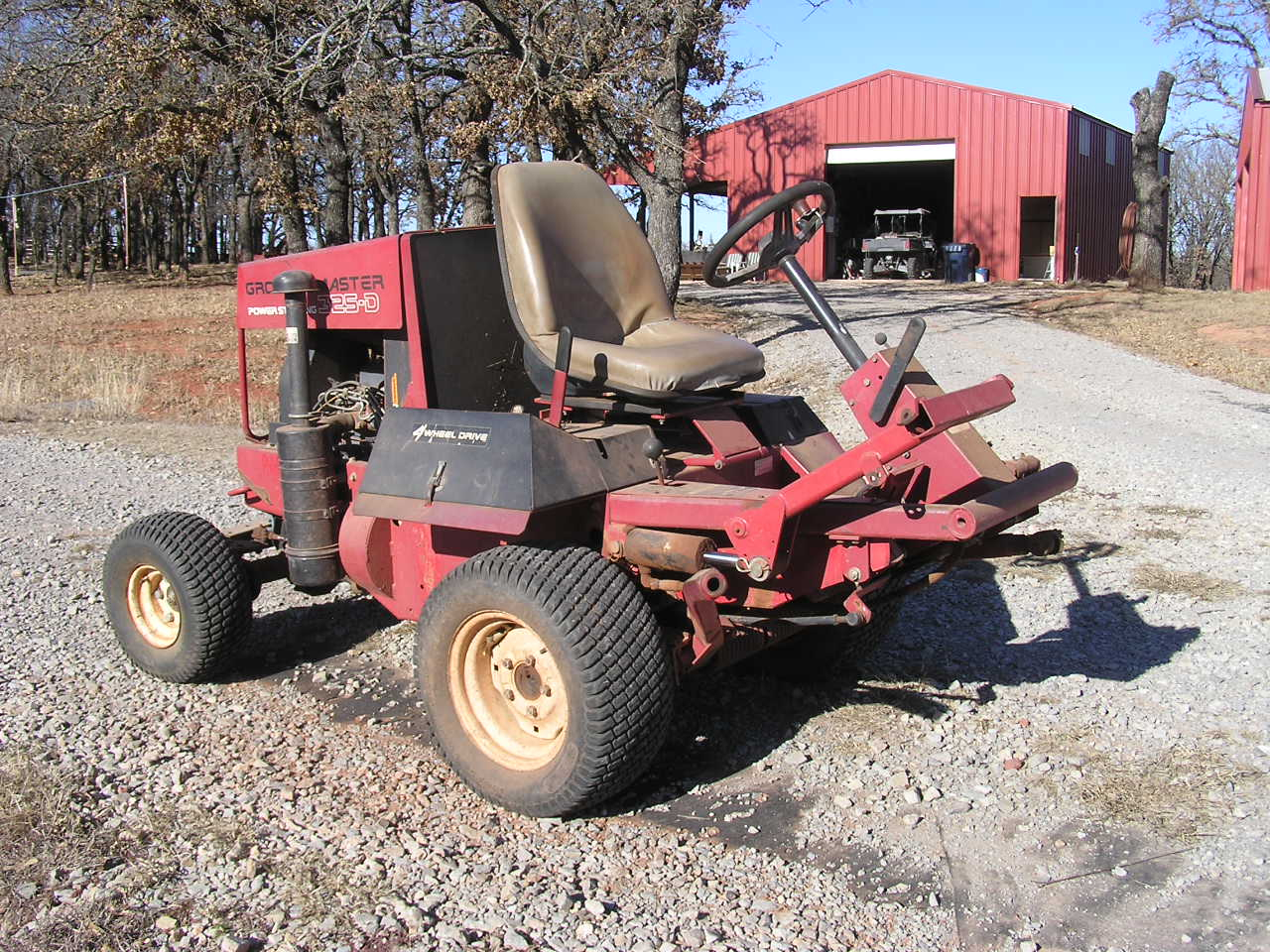

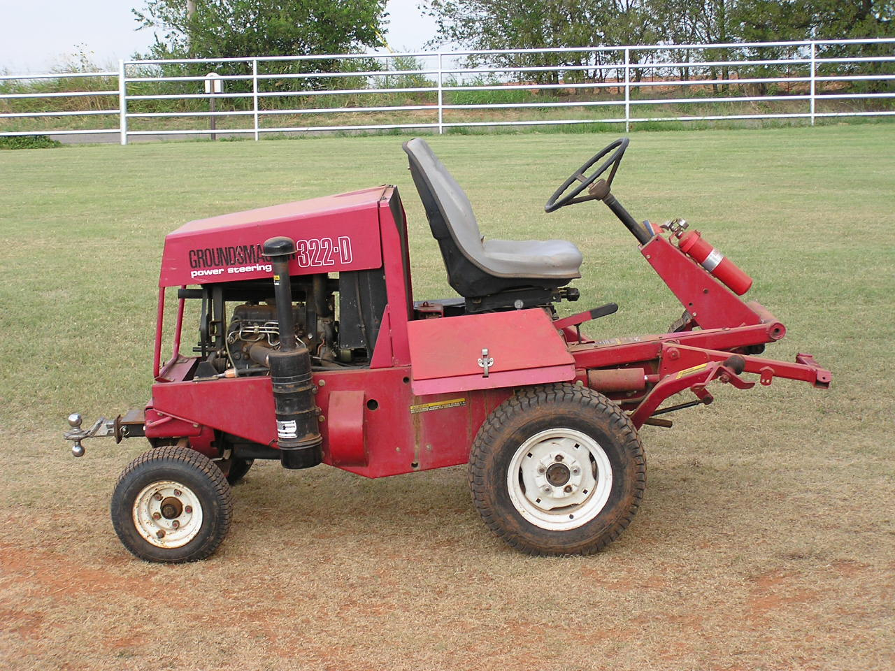

I remember combines with their rear wheel steering took a little "getting used to" in order to drive straight. Is that true with the Toro type mowers?
I guess I got used to rear wheel steering pretty quick, no problem driving straight. They do turn very sharp:
Got my first one in 2003, a 1990 model 322D:

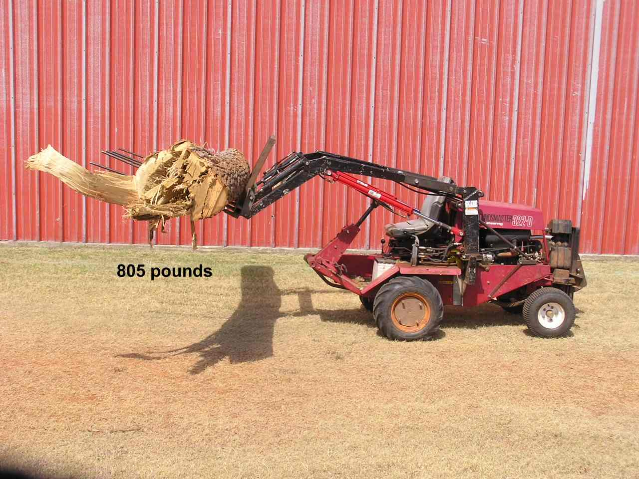

Still have it, added the loader:
