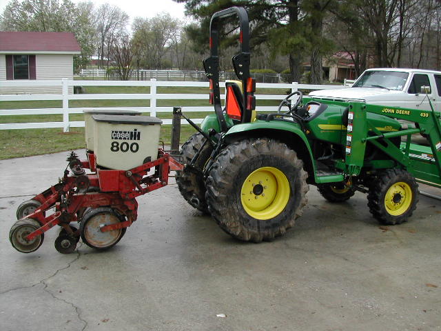

I bought a couple of CaseIH planter heads from my farmer uncle last week and I spent half the night cutting and welding but got them finished. Man were these things cumbersome to stand up to get them bolted to the tool bar. I put some seed corn in the hoppers this morning and tried them out in the front yard and they actually worked. Unfortunately I will now be mowing some corn in my front yard. Picture attached.

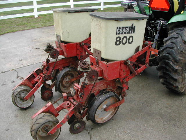

Another

/ 2 Row Planter #4
I was wondering what your row spacing is.. seems like most small planter rows are always in line w/ the CUT'S tires.. I have this problem w/ my JD 2 row & TC35D.
/ 2 Row Planter
My rows are set at 36". Why? That was just the way it worked out when I was putting it together with what steel I had on hand and the 3 pt hitch that I already had.

/ 2 Row Planter #13
The reason I was asking is because I have a problem w/ my JD planter's rows being directly in line w/ the tires. So if I go to use a 2 row cultivatar.. I'm driving over the corn. I'm going to try and adjust the width of the planting rows to fit w/in the width of the tires. The rows would be considered "narrow" or "double" rows.
