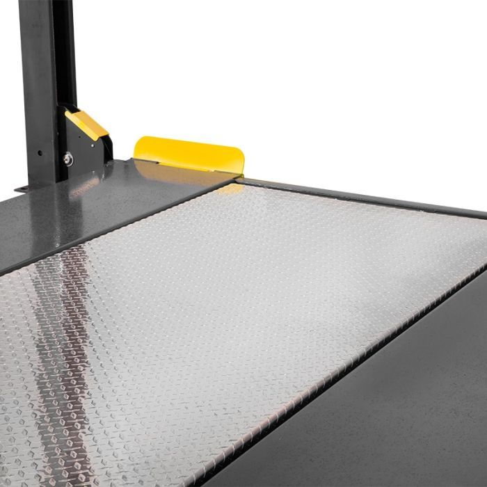

If you have the resources, I'd suggest a 4 post with rolling hydraulic jacks. I have an Atlas 409 four-post which I think is discontinued, but its extra wide for your dually and extra high with rolling jacks. I can park an Equinox under it and a Ram 2500 crew cab regular bed on it with a 13-foot ceiling height. I also have an old Atlas 408 four post but its just wide and long enough for a car (Charger). On that one I have to take the ramps off to get another car under it. In the shop we have a newer Bendpak extra high and extra wide lift. That one we've NEVER used for cars/trucks because Bendpak offers a diamond plate filler that makes it a huge height-adjustable workbench. Never intended it that way, but you will love it if you work on large heavy items. Has a tendency to collect junk though...

Here's the BendPak aluminum deck.

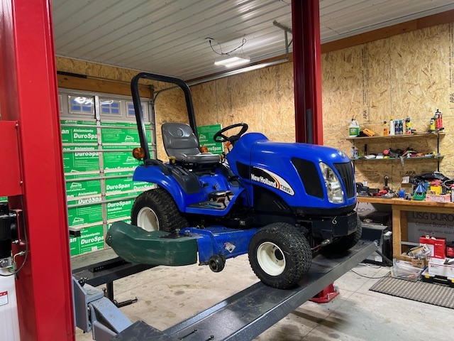

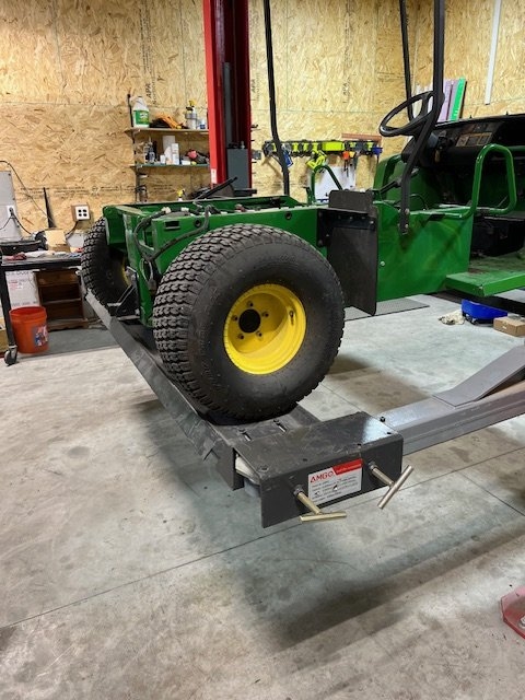

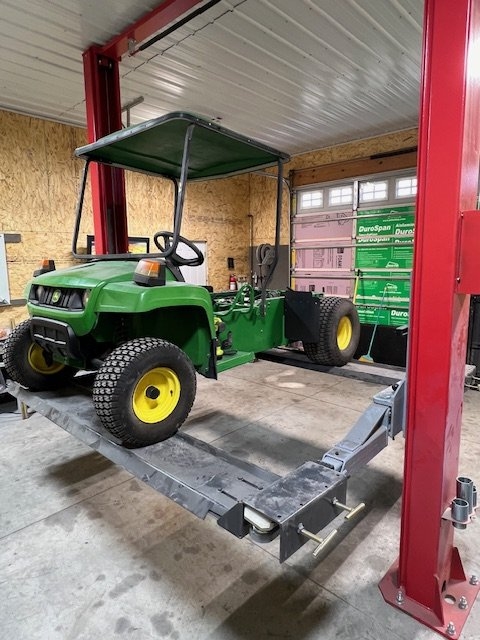

I decided on a two post, it's an Advantage Lift AL-SC10 for $3,995 right now they are on sale for $2,995. It is made in China to specs developed in the USA. It has been a very good lift, seems quality with thick steel. I have used it for vehicles and my golf cart, side by side, tractors. I bought an attachment from JMC Equipment for the golf cart that works for tractors, side by side, zero turn, etc. It is
AMGO Hydraulics 20805 Golf lift accessories SKU: AH-20805.​
With this accessory I can easily and safely stand under golf cart, zero turns, tractors, side by side to change oil, remove and sharpen blades, clean under deck, etc.
