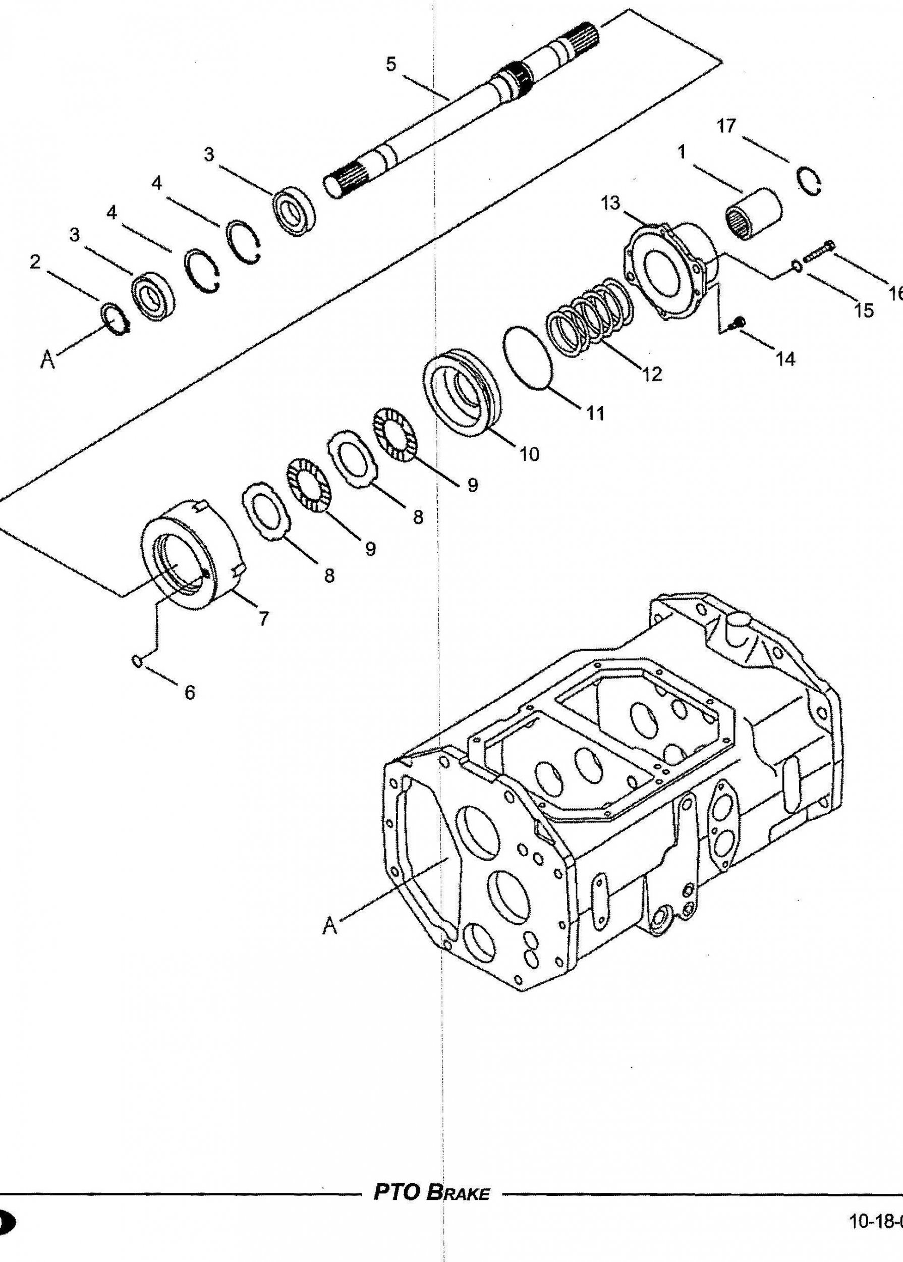

I have a landtrac 410dtc and the pto quit. Since the PTO switch has 2 positions, manual and independent. If the hydraulic don't build enough pressure to work on independent should the manual side still work off the transmission?
   / 2 positions pto switch live and independent. #2
Not knowing about the landtrac I can not say for sure but I am pretty sure it uses the same clutch for both. The manual side usually means it is engaged until the switch is turned off. In this case it may mean the clutch will disengage with the transmission clutch but is still using the electric clutch to engage and disengage.
What have you done to figure out the hydraulic issue?

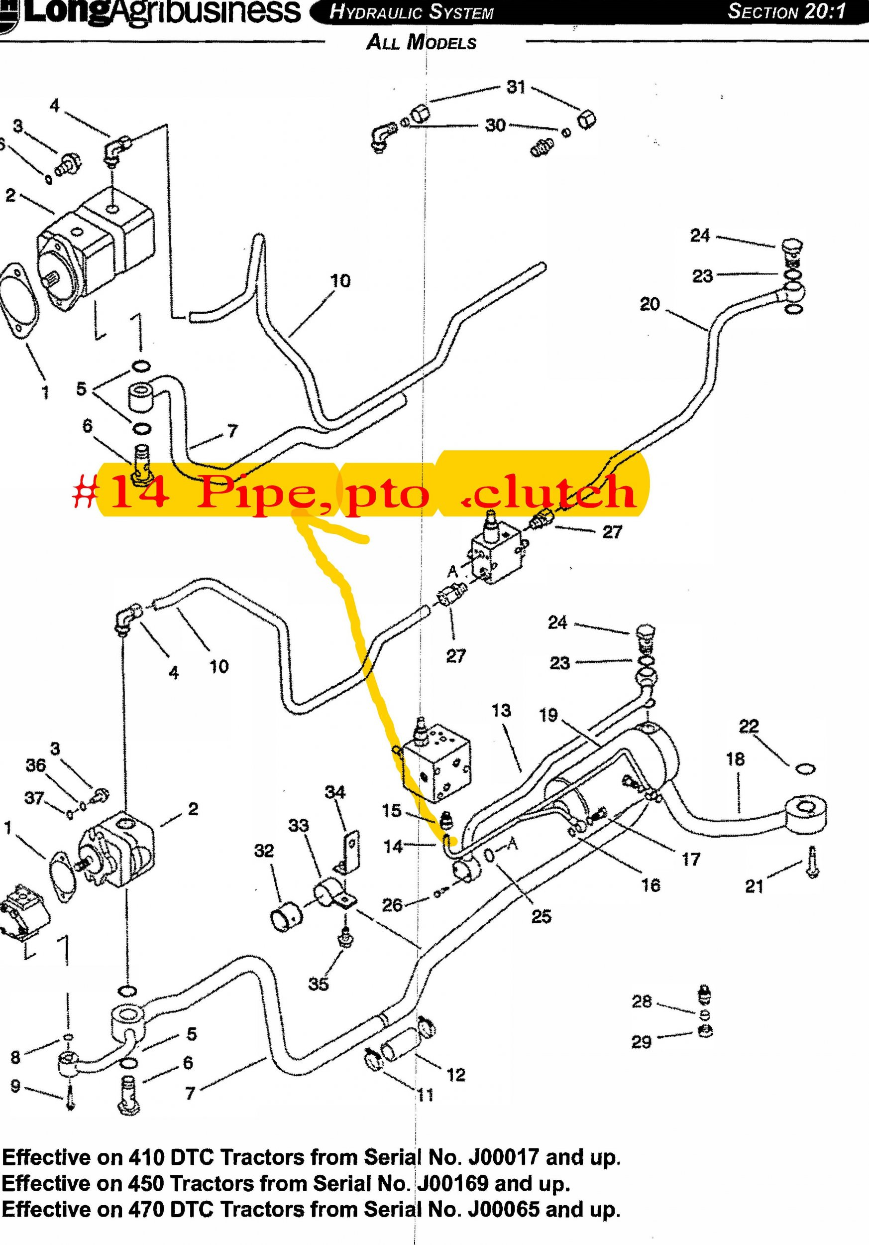

I assume when the pto switch is in Independent it provides flow to #14 pto clutch pipe releasing the pto brake and turning the pto shaft.
The wiring on the pto switch has four wires
1 power or ground input not sure did not test for 12 volt power.
2 Independent
3 Manual
4 Off
When I turn on Independent the PTO solenoid opens and I have hydraulic flow to #14 pto clutch pipe but not sure if there is enough pressure.
But when I put the pto switch in manual it won't turn the pto either.

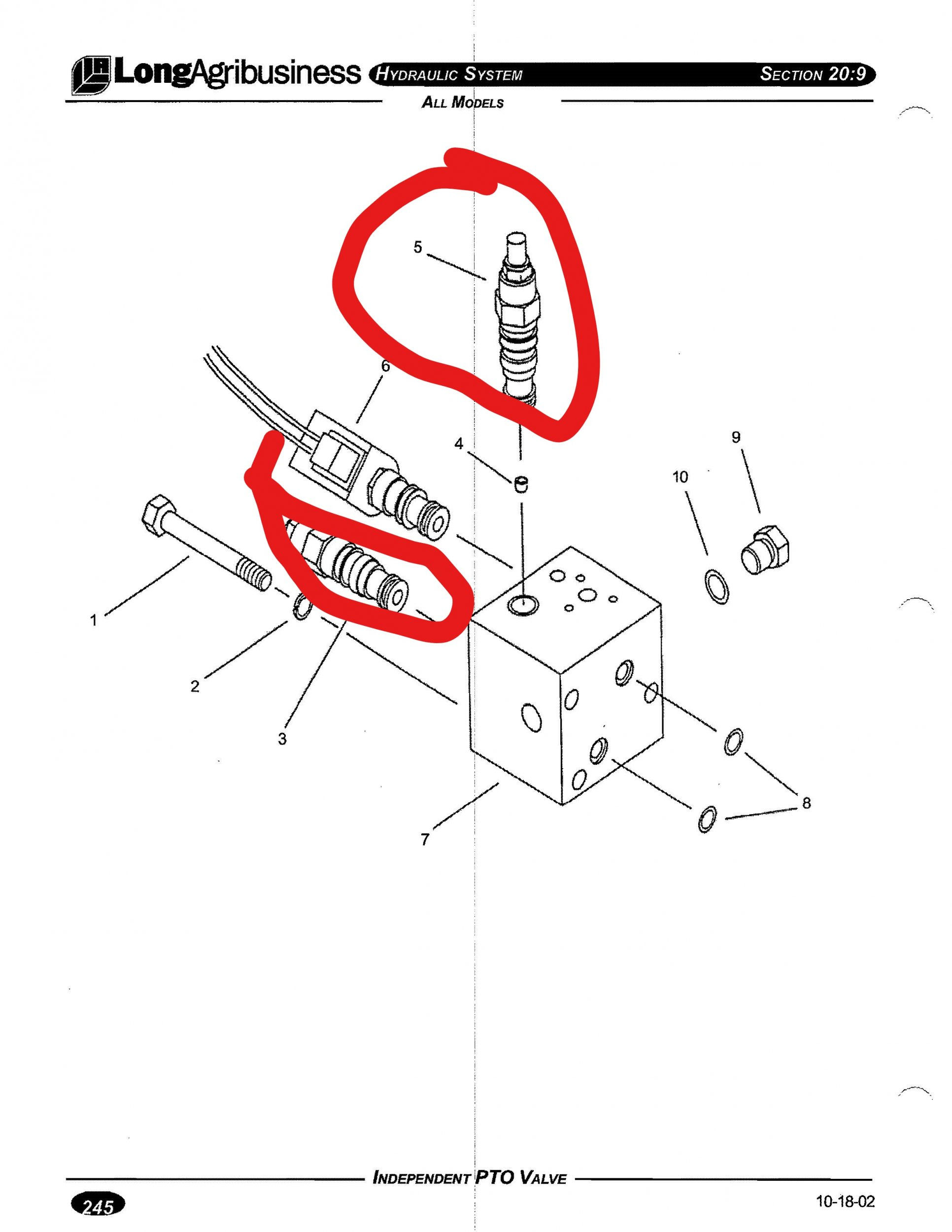

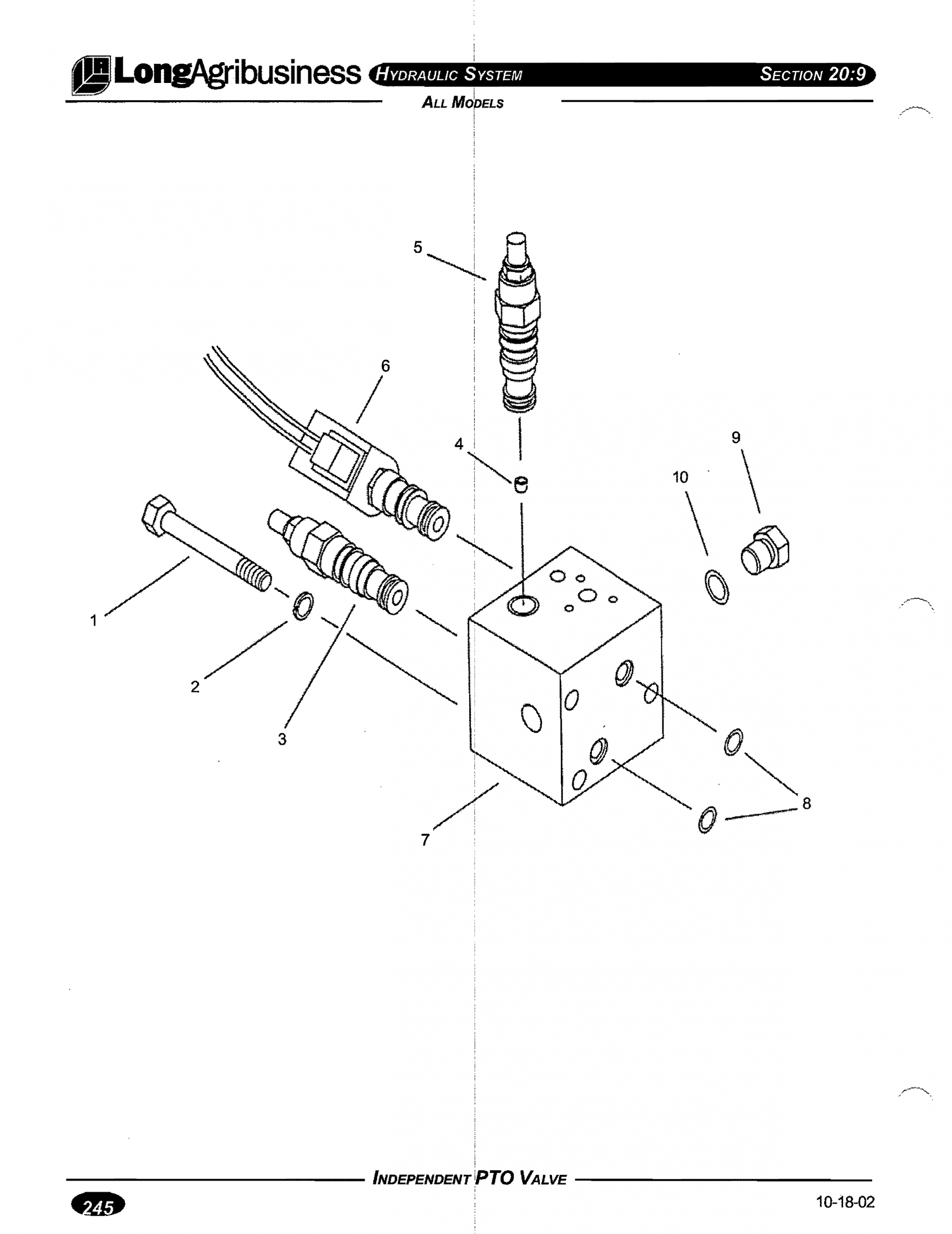

Dad was using it and got in some taller stuff and it quit. I removed the pto switch and I disassemble the switch and cleaned the contact and tested it with a meter. The switch works I get 12 volts to the solenoid when in independent mode only. I disconnect the #14 pto clutch pipe see the video 20220413_160127_Trim.mp4. I took everything here
and put it in my ultrasonic cleaner. One thing I don't understand is how the brake release when in manual mode. The three point hitch arms will lift the backend of are one ton flatbed so I know the pump is good. Now if the Valve, Sequence or Valve, Reducing is bad, should the manual side of the pto switch still turn the pto. What I need is someone with a similar tractor to pull their fuse or disconnect the pto solenoid then see if the pto turns with the pto switch in manual mode. Also what turn on to pto light on the dash it's not turning on now either.

When I said it works in one mode I mean the pto solenoid has power and hydraulic fluid flows when turning the switch to Independent. I don't feel the pressure is enough to release the PTO clutch pack. If I discount the pto clutch pipe should it flow as if a open water hose or like a shower head? Also what tells the dash pto light to turn on? Does it get a signal from the pto switch or a internal switch that senses movement of the pto shaft.

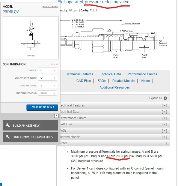

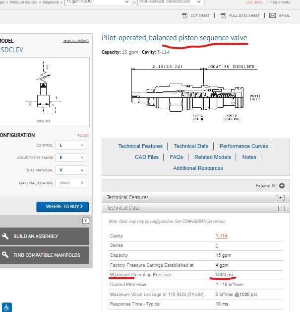

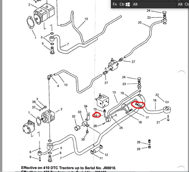

Okay after researching I found # 5 & 3.View attachment 744223
So if I remove the pipe going to the ptoView attachment 744224 it should shoot out like a pressure washer correct?
Not necessarily as it's pretty much free flow without any restrictions to make it shoot everywhere. Specially considering that it's fed by the power steering pump which has a small displacement.
Figuring out the pressure is more important to troubleshoot your issues. If you could get a service manual so you could see exactly where are the test ports and the proper pressure values, that would be awesome.
   / 2 positions pto switch live and independent. #10
I just saw the video you posted earlier. Missed that. Looks like good flow to me.
