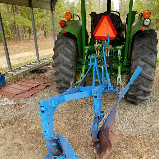

First post from a Tractor and attachment newbie! Purchased a low hour 1250 JD with 100 Loader and 4 used attachments, one of them being a 2 bottom plow. We hooked it up and plowed for about 1/2 hr and everything was going great until we hit a massive rock. Now fully understanding the "float control" for the loader after reading this forum, ours was set to stay down and the plow actually uprooted this rock that must weight 50 to 60 pounds. I think we were probably going to fast also (when I say we, I mean my son who was driving). Also reading the tips of hitting the clutch as quick as possible will aid in this not happening again - so lesson learned. We cannot figure out how to get the plow "reset". I have tried backing up on it, but it doesn't budge and slides in the dirt. Should I back against a stump maybe? I don't see a pin sheared so assuming it's not that kind of plow.
I have a buddy with alot of experience that when I can arrange both he and I being off work at same time planning to come try and reset it, but I'd like to learn myself (maybe this will help somebody else coming here too). He thinks it's an 1950's circa International Harvester plow but I can't find a photo that looks exactly like this one. Here are some photos - any help is greatly appreciated! Look forward to learning from all of you!

Yes, backing up usually resets them easily. I'd soak the inside mechanism and spring with some penetrating oil, and then raise the plow somewhat to allow it to swing partially back into position as you back up. You might have too much down pressure as it looks in the pictures. If that doesn't work, try to raise the plow to get the point off the ground and then jack up that forward facing rusted arm to attempt to swing it partially back in place. Maybe a winch strap wrapped around the upper frame and that arm will pull it upwards. Once free and the rusty parts soaked with oil, it should pop back into position when you drop the plow to the ground and back up.

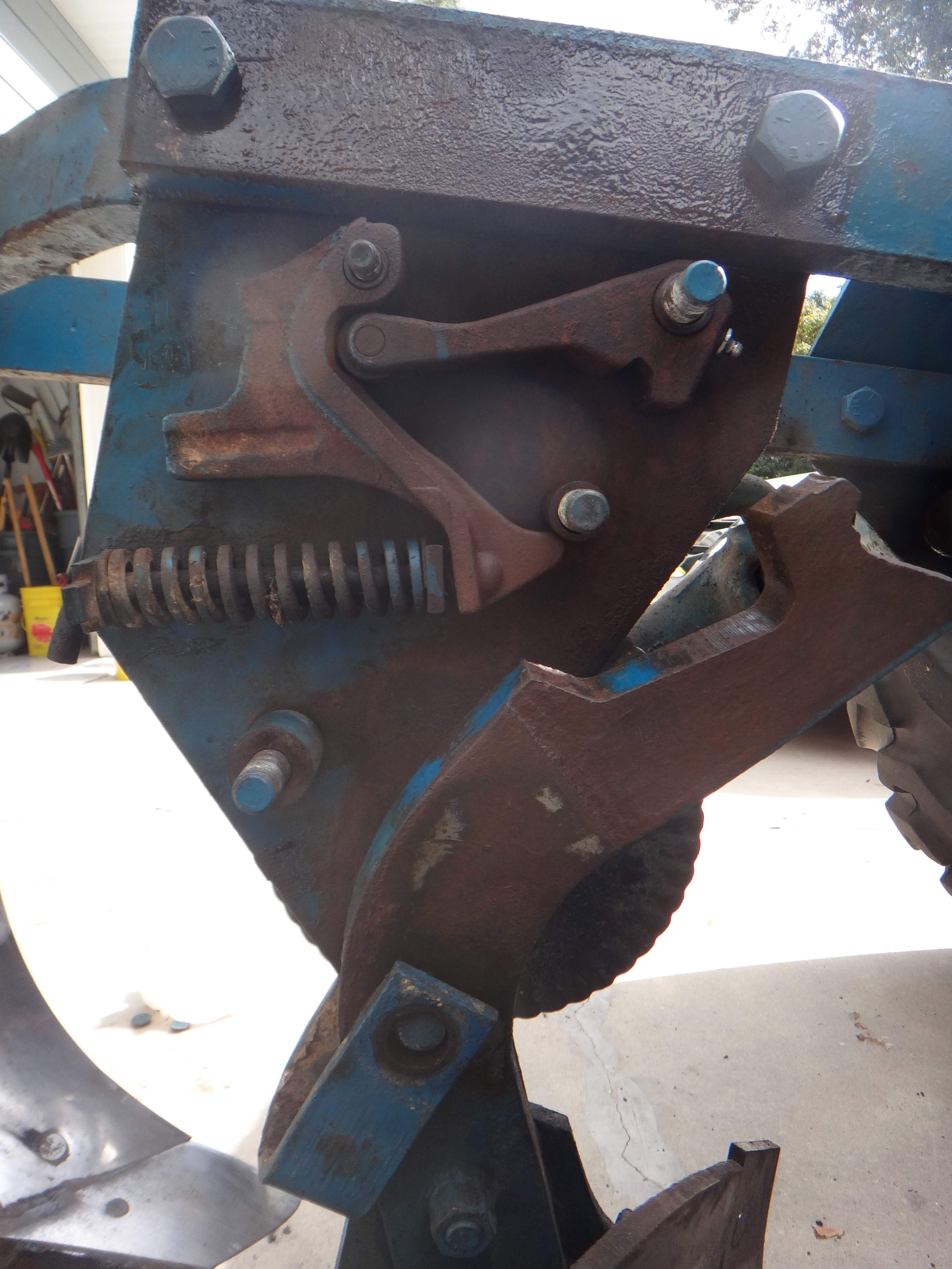

Here is what my Ford Series 101 plow looks like inside the trip mech.

You can back up against a stump or use a pry bar to get it back reset. It's probably just tight from lack of use. You can also loosen that pivot bolt at the bottom just a little and it will be easier to reset.
They are spring trip, not shear bolt. All you have to do is get it to latch back and start plowing again.
