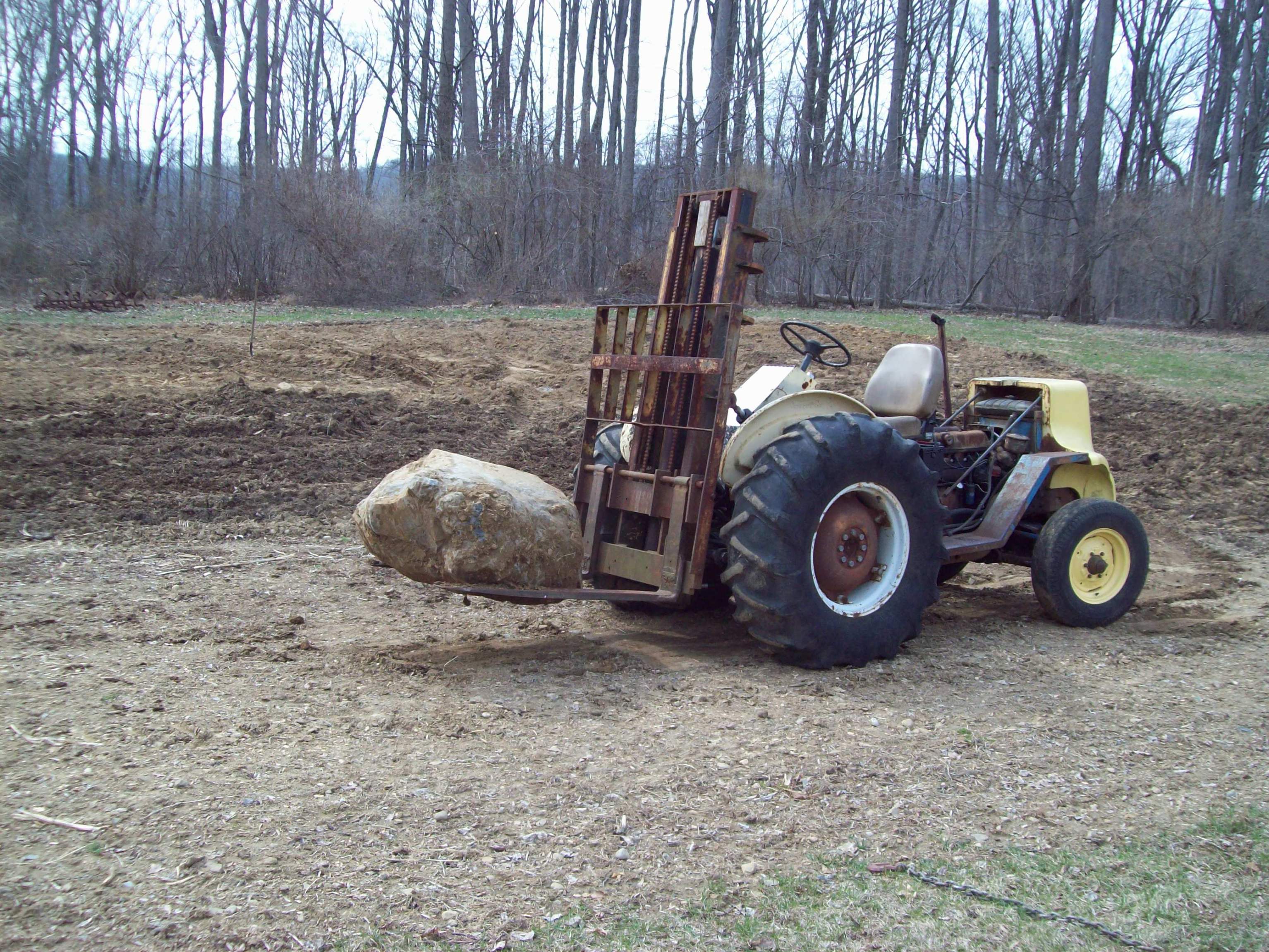

If you have rocks or hard soil you might want to consider a subsoiler frist to break it up. I've been working this soil for four years and with my dearborn subsoiler pulled out this rock yesterday. I will not use my good 2B plow in my soil yet, maybe in a few more years of rockpicking.
Kirk
