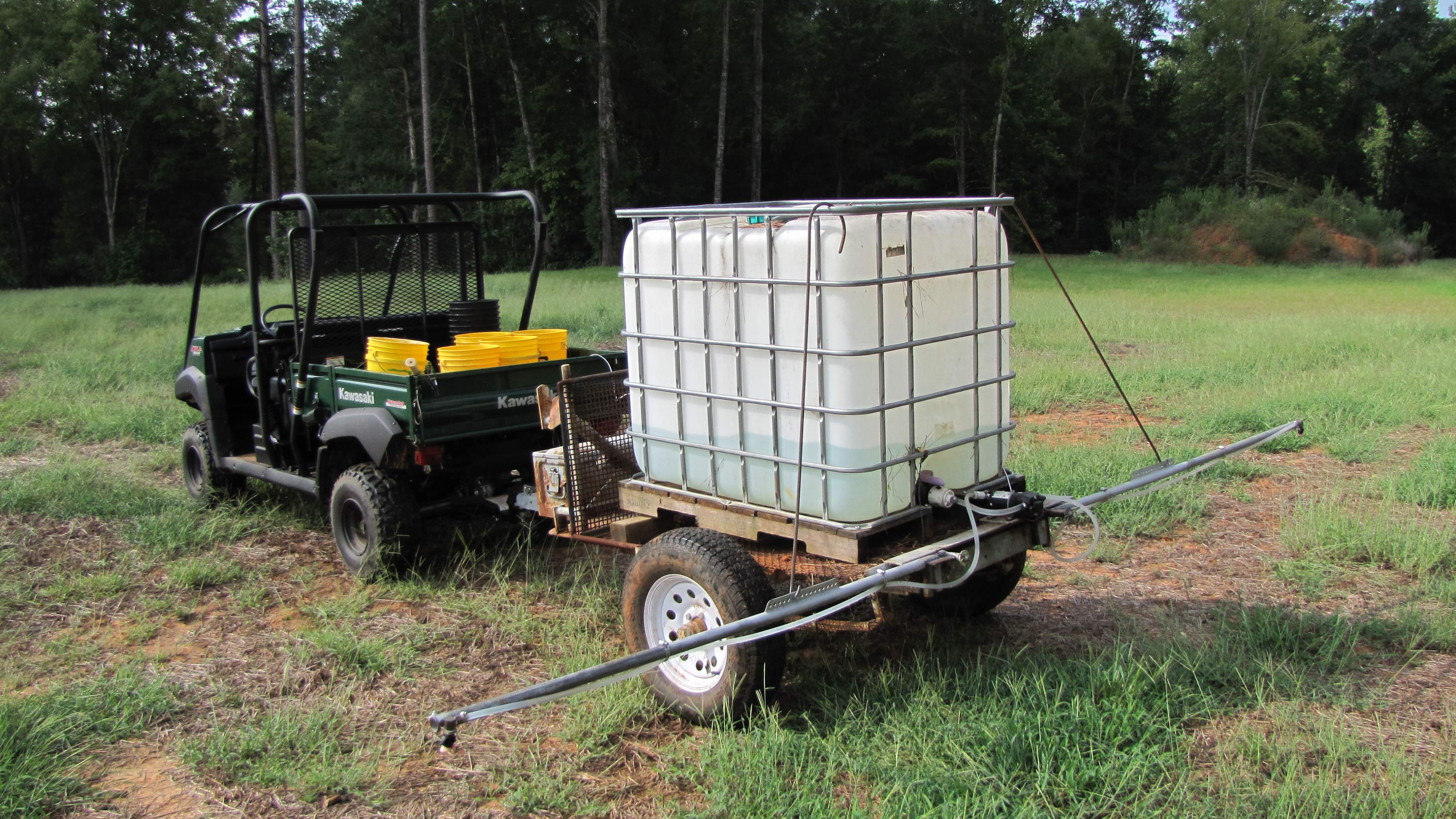

I don't know how much water per acre my sprayer will do, I've always done the calculation from the instructions on how much water and chemical per acre to use and then just going over and over it again until it's all gone. The results with this method have been fantastic, so I think I'm good with my sprayer nozzle size and pump.
I've changed the height of the sprayers since this picture was taken. I was hitting too many things with them down this low.

You should have the bar high enough so that each nozzles spray pattern overlaps an inch of so. The more water you put on (to an extent), the better your results so that you get good wetting of the weeds. You would be better served to establish how much water per acre your rig is putting out. To do this, put in plain water and measure off a specific distance that is easy to figure sq footage. Put a container under one nozzle and at the same speed that you will be spraying, travel that distance and note the amount of water multiply by the number of nozzles and divide the area you sprayed in the the square footage in an acre to come up with the portion of an acre that you sprayed. Multiply the amount of water by the fraction of an acre to see how much water you put on an acre. Then adjust your chemical content accordingly.

So basically, you are using 200 gallons per acre. That is very excessive (average range is 15-40 gpa) but as you noted, you have very good coverage (and thus results). To answer your question, Yes, you should be able to use less water, the amount of chemical will still be the same.
Actually, how many times do you think you go over the acre emptying the 200 gallons? Lets say if you run over it 4 times to empty it then you can easily cut back to 50 gallons per acre and use the 200 gallons to do the 4 acres (only going over it once). You have to put 16 bottles into the tank.

That 300 gal tank on a coupe would cover 20 acres at 15 gal/acre. Plenty of water for most weeds and chemicals. Suggest buying it at a farm store not lowes. Your price sound a little high.
What rate of chemical are you shooting for? 1 quart per acre?
Now to calibrate your sprayer. Guessing you have an electric pump. Get a jar hold under one nozzle while running sprayer and catch water for specific time. Then measure. May need to measure in ml then convert to ounces. 29.57 ml per ounce.
Know or measure your speed. And how many inches that nozzle is covering.
Say you measured your sprayer for 30 seconds. Figure out how far you will travel in 30 seconds. 4mph=176feet per 30 seconds. And one nozzle in good for 20 inches. That one nozzle will cover 294 sq feet in 30 seconds. Say you caught 12 ounces. Your rate will be 43560/294=148. 148*12/128=13.88 gal per acre.
Now just note the pressure your pump was running at and you can fine toon it to what ever you want.
