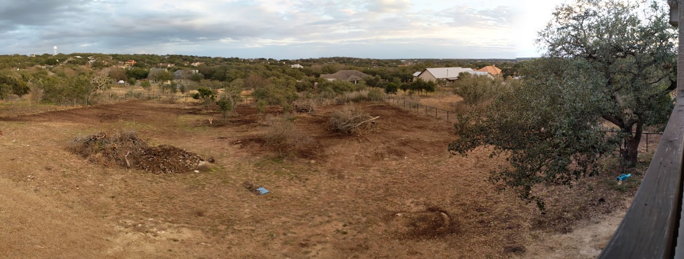

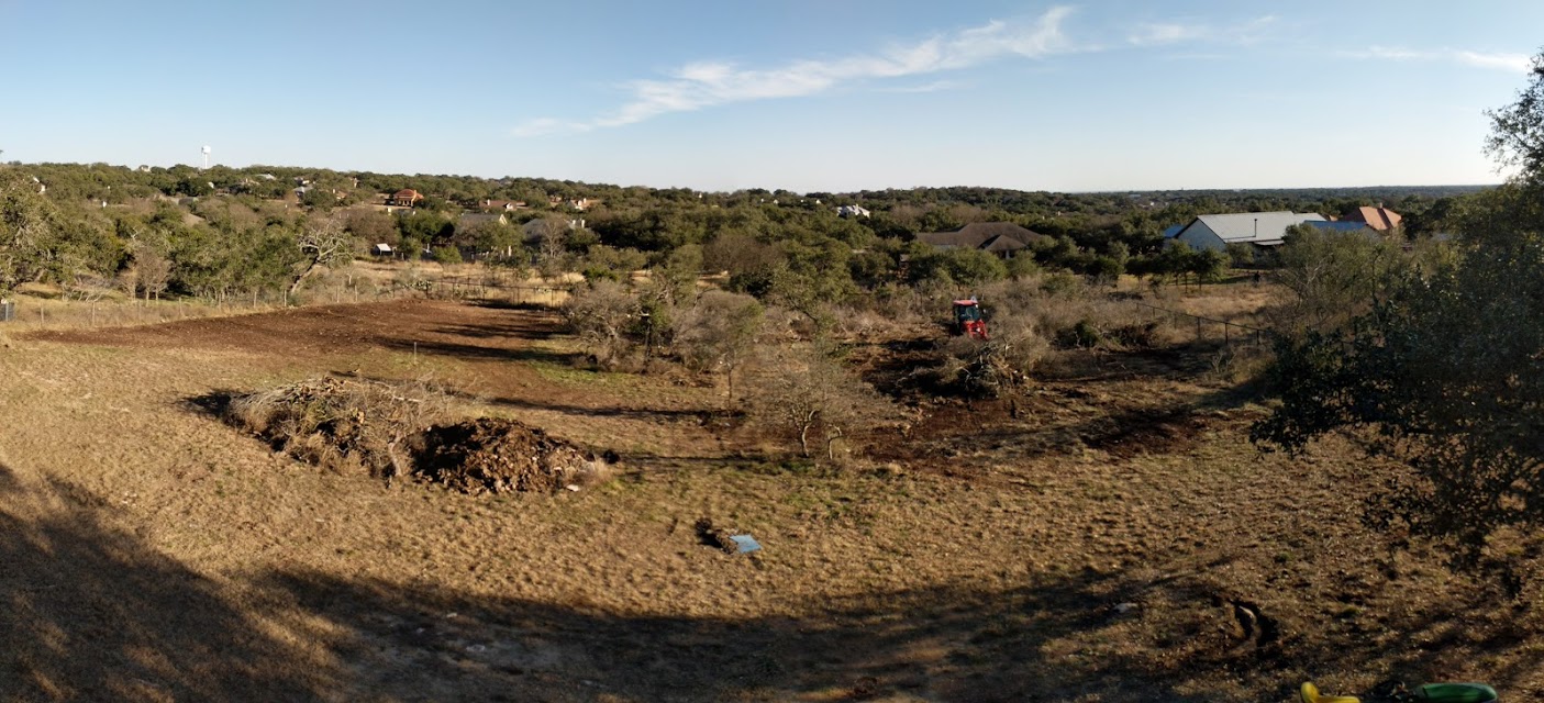

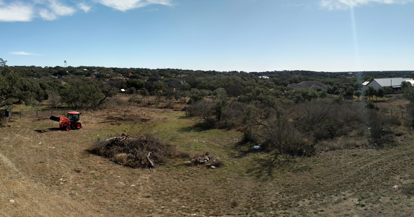

Man you're not kidding! I put in 23 engine hours in 3 days clearing land. It's been hot, it's been cold, it's always windy I've been kicking up all kinds of dirt and dust. I've had a great time but I don't do this for a living, if it weren't for that cab I'd have been in the house!
Here's almost a before, during and after shot of the 1st job. I forgot to get a true "before" shot, imagine the back left corner is full of crap too! :laughing:
   / 1st tractor; new CK3510SE #16
View attachment 535977 View attachment 535978 View attachment 535979
You better slow down you will put yourself out of work:D
