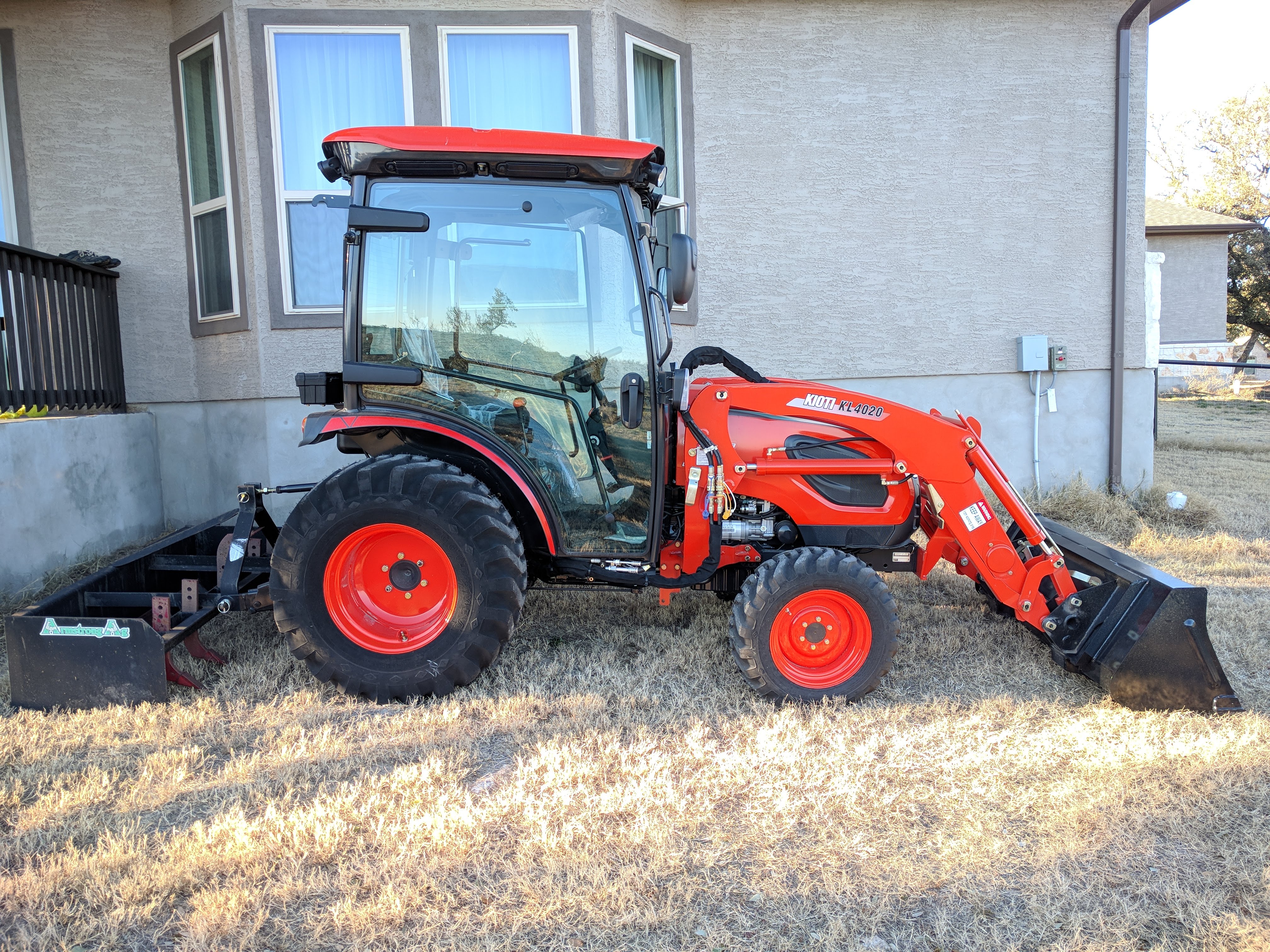

New-ish member here at TBN and I now own a CK3510SE! It's my first 1st but I did a lot of looking and listened to a lot of advice so hopefully I really bought my 2nd tractor 1st! One of the things that really made this a winner for me was ergonomics. I'm a big at at 6'4" and over 300lbs and I found many compact tractors, some even larger in frame than this, I did not fit on. I only got to put in an hour of work today, but no complaints and she was very comfortable.
Anyway I know how these forums go. Blah blah blah, nobody cares, get to the pictures already!

It looks like you got an upgraded loader. Specs say the loader is supposed to be a kl4010, but yours is a kl4020.
/ 1st tractor; new CK3510SE
Good eye. I believe that is just something that comes with the ck35010se and ck4010se models. These are factory cab models as opposed to a ck3510 with the cab added on. One way or another I'm sure I paid for it, lol.
/ 1st tractor; new CK3510SE #11
I think it may actually be the new version to replace the KL4010. At any rate you get an extra 100lbs of lift capacity.

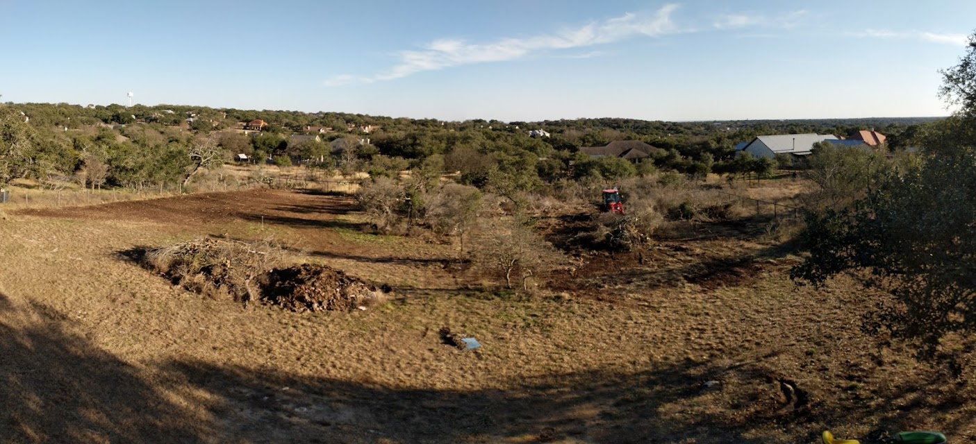

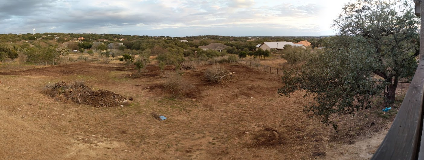

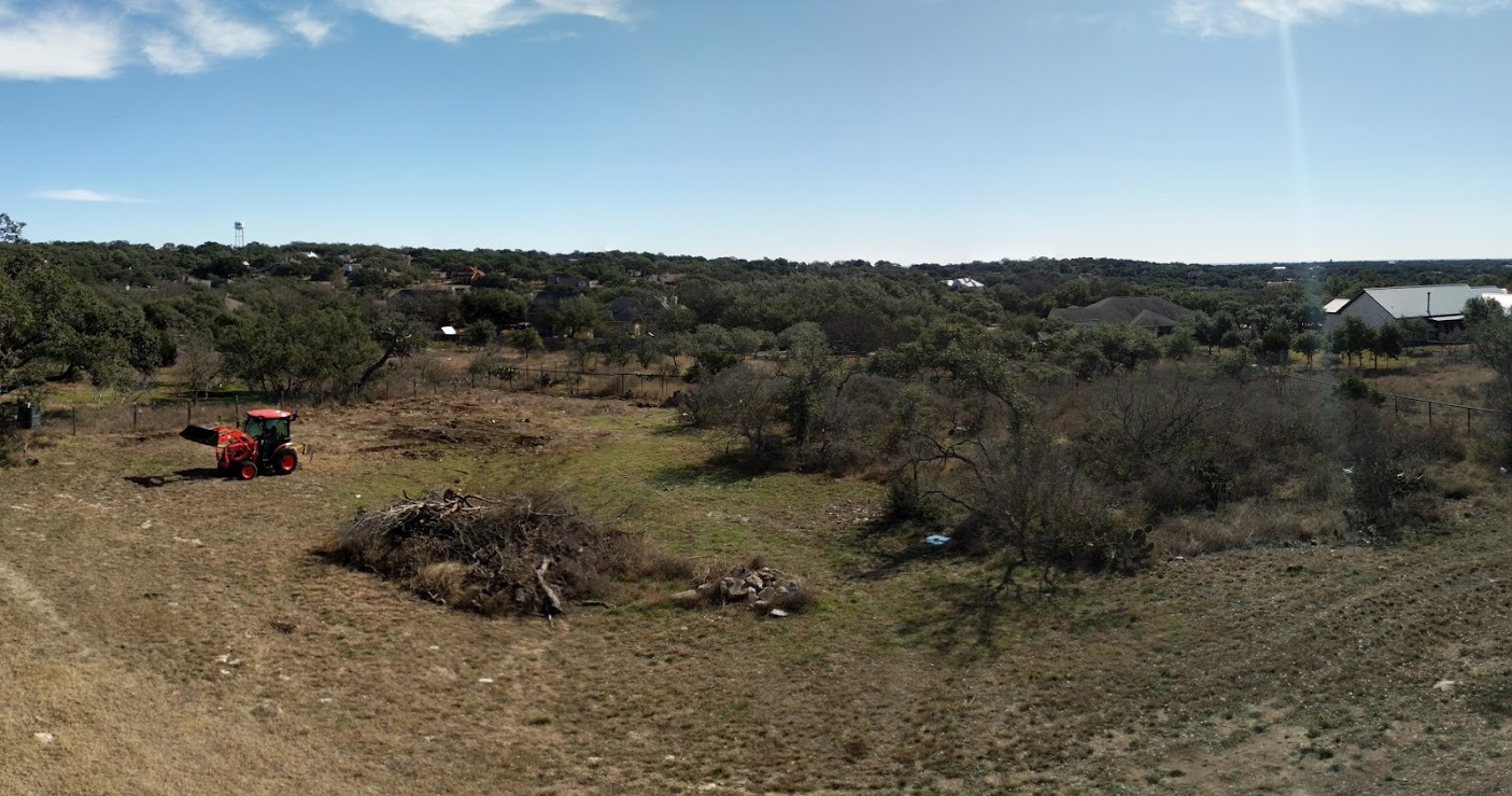

Man you're not kidding! I put in 23 engine hours in 3 days clearing land. It's been hot, it's been cold, it's always windy I've been kicking up all kinds of dirt and dust. I've had a great time but I don't do this for a living, if it weren't for that cab I'd have been in the house!
Here's almost a before, during and after shot of the 1st job. I forgot to get a true "before" shot, imagine the back left corner is full of crap too! :laughing:
