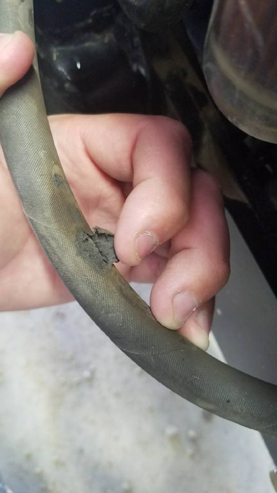

1) There's a hydraulic line on the left side of the engine that was wedged extremely tightly between the sharp edge of the frame and another line. I was able to carefully work it out over a period of about 30 mins. It was gouged quite a bit but I believe it's only an outer wrap...but I don't know for sure. I temporarily fixed it from getting worse by putting a piece of 1/8" thick rubber pad in between the line and the frame. I'm not sure how I'm gonna handle the permanent repair because the entire line needs to be rerouted to keep this from happening again. There isn't really enough room in there for all 3 of the lines that are in place.

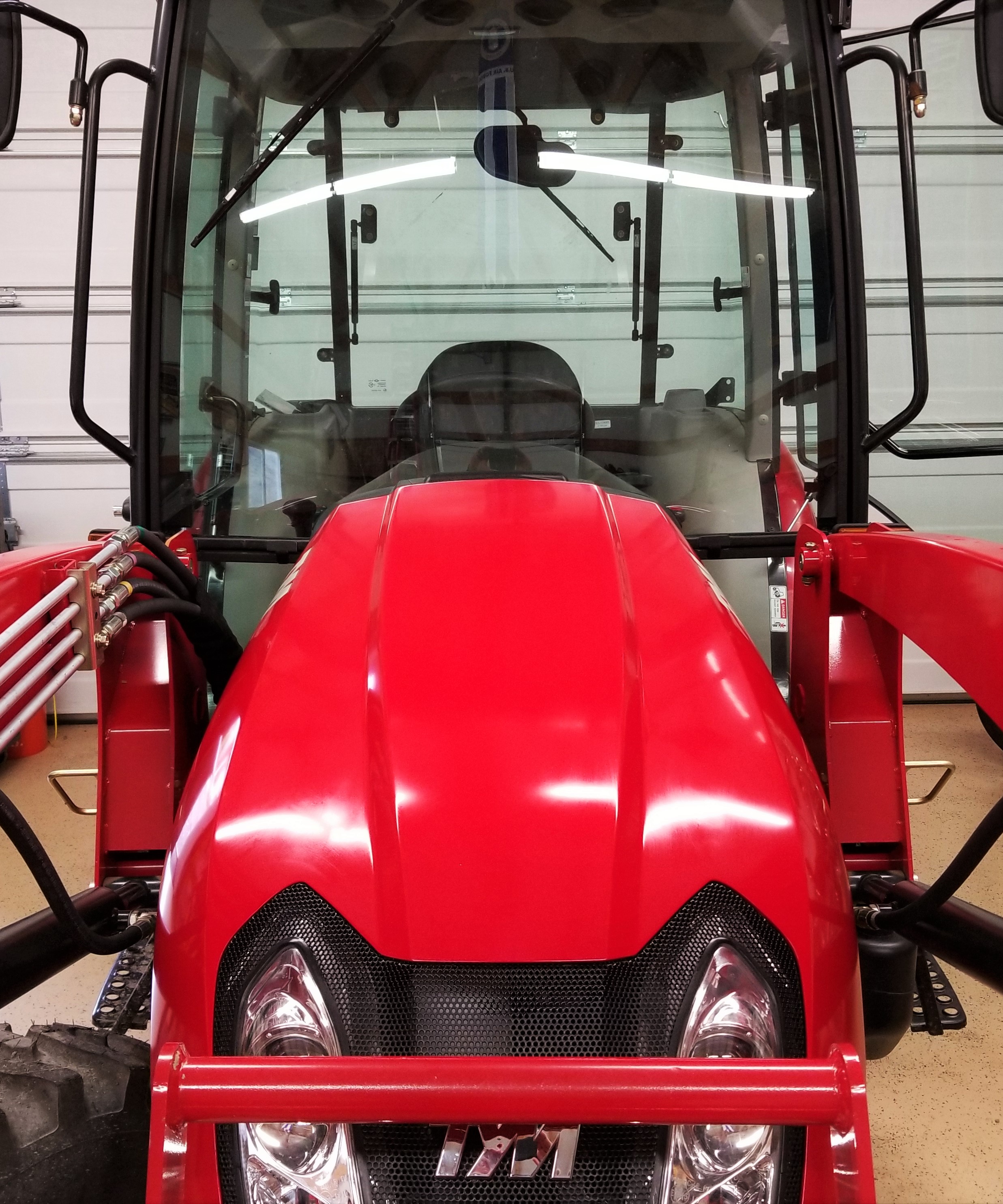

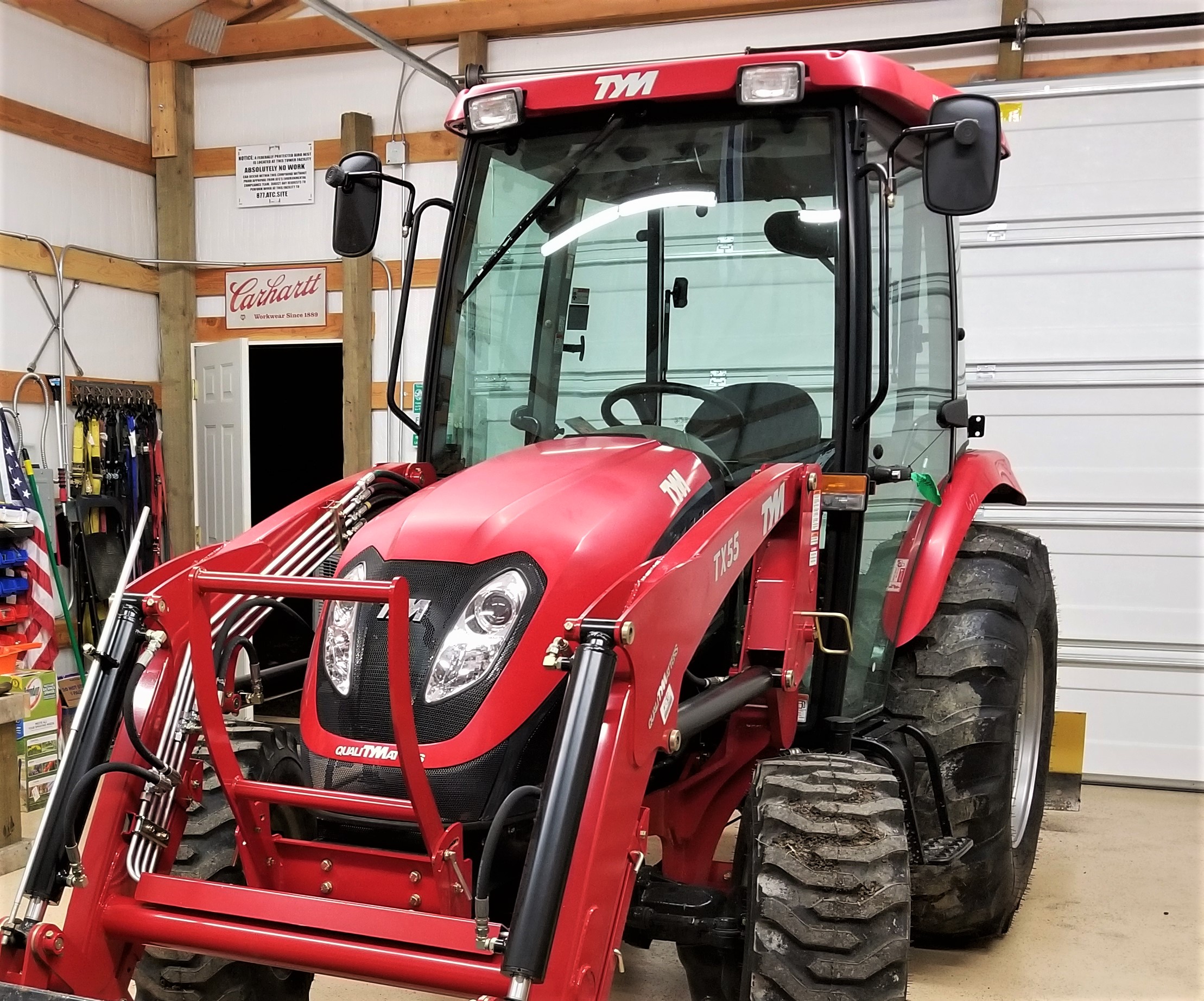

The other issue was a known issue the dealer told me about. The plastic hood was pretty badly sun-faded. I tried a few things to brighten it up a bit without success. Then I remembered I had some Turtle Wax Trim Restorer that I'd used several years ago on the top of a 96 Bronco we had owned for about 10 years (since new). Worked like magic on the Bronco. I put it on the tractor hood, let it set for a few mins and wiped it off. What a difference. It lasted several months on the Bronco so I'm hoping it lasts as well on the tractor. I'm gonna put it on the rear fenders next. Before and after:

Nice job on the hood. What does that hydraulic line go to?
/ 1st Issues w/New TYM T454
Haven't figured that out yet. I lose it behind the engine and under the cab. Waiting on the service guy to tell me what hose it is.
/ 1st Issues w/New TYM T454 #4
Same hose. Mine tore a bit. Goes from the loader valve to the hydraulic pump.
