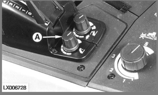

How do you mean "confused"? Does it move up and down if left in middle setting? Which knob in pic is the one that turns around and around? It is not a good thing for any of them, but I am guessing it is the one labeled 1 - 5? The other 2 are under the flip up cover you may not even know exists. The 1 - 5 knob is load and depth sensitivity knob and can definitely affect hitch operation to act "confused". Try setting knob at the 1 setting to see if it improves. Are you getting a rockshaft light flashing at you? Most likely you will need to get a dealer to plug into it and retrieve error codes to isolate where the problem is. You may also need to get rockshaft calibrated to get it to work properly after steppermotor replacement. As for your original question, there is no right or wrong way to use the sliding control. stopping at any point should result in rockshaft position staying where you leave the control. If not, then any one of the sensors or the computer controller could be bad or out of calibration. The control that spins all the way around will most likely need to be replaced to get a good calibration, even if it is not causing the present problem. Each control is moved through its. normal travel during calibration and if values at each extreme of knob movement is not in spec, calibration will fail.

One picture shows the type controller I have. the other pic I couldn't delete before posting. The dial behind the controller doesn't seem to work. It just spins. Sometimes when I'm raising the 3 point and I slide the controller and it won't move or its delayed. It will shake sometimes as well but not very often.

The knob behind the controller, going from 5 counter clockwise to 1 is the Load/Depth control.
I can't answer about turning free. My tractor is 6 miles away.
Replacement of stepper motor requires calibration of the HCU Hitch Control Unit. This might be your problem, not recalibrated.
Rockshaft refers to the shaft that the cylinders lift/lower. There are arms and links that attach to the lower draft links of the 3pt hitch.
On the controller:
There is a sliding lever that to the rear raises the lower draft links, forward lower them. 0 = raise, 9 = lower. It has stop for depth (amount lowered to). There is wheel outboard of the sliding lever you push down on to rotate, it moves a stop inboard of the sliding lever.
If the sliding lever is moved all the way forward the draft arms will be in "Float"
A Raise/Lower Switch on the near to operator side. This switch will raise the draft links to limit set by the Height limit dial under the rear cover. It will lower the draft arms to the setting of the sliding lever.
Under the cover to the rear is two dials. Nearest one limits raise height. Counterclockwise for lower maximum height , clockwise for higher maximum height. Far dial adjusts the rate of drop, how fast the lower draft links drop. Something heavy can be adjusted to drop slower.

Ok, makes more sense now. I'm pretty sure that 1 to 5 dial is broken. To re calibrate the stepper motor I have to have a dealer do it or there are some mobile mechanics around, could they do it? Thank you for your help

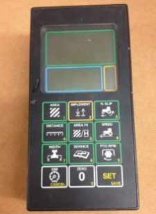

If your tractor has a performance monitor(pictured), then it can be done by anyone with the instructions on how to do it from the technical manual. If not equipped with that, then you can plug one into the diagnostic plug to do it if you can find one or borrow one from another tractor. Other than that, then it most likely needs to be done by a dealer. It is a fairly complicated procedure so a technical manual is a must. Hydraulic oil needs to be heated to 40*C before it can be performed also.

That performance monitor is shown being used in the video I linked to in a previous post.
