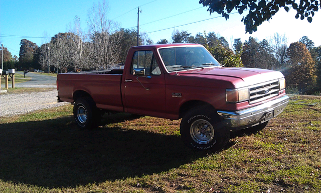

Anyone have or had a F150 XL 4x4 with the 302 engine and I think it is an automatic from the mid 90's era? The picture shows a clean truck not beat up at all.
mail
Having 215K miles on it is my big concern especially it being 4WD because I can see there is nothing cheap about the front drive train. The seller has only had it 6 months and uses as his daily driver and states he has his eye on another truck is the reason he is selling it.
It is listed for $2K FIRM which is not much over dealer trade-in for a solid truck of that age per www.kbb.com so the low price scares me a bit. He said the truck looked as good on the other side as in the photo and the engine and transmission worked well. He has put brake pads on it and a power steering pump.
The truck will be for the neighbor actually who has horses and one belongs to my daughter so the truck will be for local use more for pulling equipment trailers getting hay ect and may never be over 50 miles from the place most of the time.

The pictured truck above turned out to have the 205 HP instead of the 195 HP version engine because it has the MAF air intake. The body was just as straight on all sides as the one in the photo and the paint seems to be unretouched OEM coat of paint. There was no rust even under the body.
It is my guess it was a company truck for most of its life. It has a bracket in the ceiling for like a communication radio and speakers in the rear of the king cab that were not stereo type speakers but more like the kind that could be used so people outside of the truck could listen to radio traffic.
The bottom and back edge of the bench seat on the drivers were taped up due to wear damage but the seat and carpet on the right side looked more new like so it may have been a supervisor truck perhaps because it could not have been used as a work truck. The dash had your normal cracks for that age truck.
It may have a tow package due to the helper springs that looked factory. It had a Perry Company (Waco TX) Crash rear bumper that looked almost like it did when new that was made out of formed heavy channel steel and a heavy receiver hitch under it. The transmission shifted well and the ATF was clearly bright cherry in color on a white paper towel. Like most Fords it has the tow mode switch on the column shift.
Since it has manual locking front hubs it is my guess they are replacement hubs (hope that is the case). We did not stop, lock and engage the front wheels but did do hard right/left circles in a parking lot and there was no noise or other funny stuff happening.
He recently had the brakes redone which required one new rotor as well. Last week he bought a set of used tires for $100 so the tires are so so but seem to drive OK. He had replaced the power steering pump and a new timing belt with the label still very easy to read. The alternator has yellow hand painted letters/numbers on it like it may have come out of a junk yard.
While the engine had some normal for the age oil leaks it was cleaner than most with over 200K miles on it. I never seen so much room under a hood in years.:thumbsup:
It is a rust free/dent free with good paint old PU. Another unusual thing it had the correct large size Ford battery that started it fast. The fact the ATF was cherry red and it was a Ford battery may have indicated it was fleet maintained for many of its miles. They were not put on the truck off roading or in city traffic I am certain. The ride was OK for a $2K truck.
The $2K price limit was a hard number because the truck is not required and that was our cash saved for the project. The daughter wanted it and traded for it today with a 25% deposit. Since she is two years away from driving on the road we may be gifting it at some point but she wants to hand on to it for a while she said. :D
We are to pick it up next week because the guy requires a truck in his construction business and had picked out a Chevy Z71 for his next work truck and plans to get that trade made the first of the week. He is a Chevy man and wanted more than 205 old ponies. :laughing:
It helped me to know why he wanted another truck. He had spotted this F150 that seemed to look like a straight truck and it fitted his budget for a work truck at the time.
