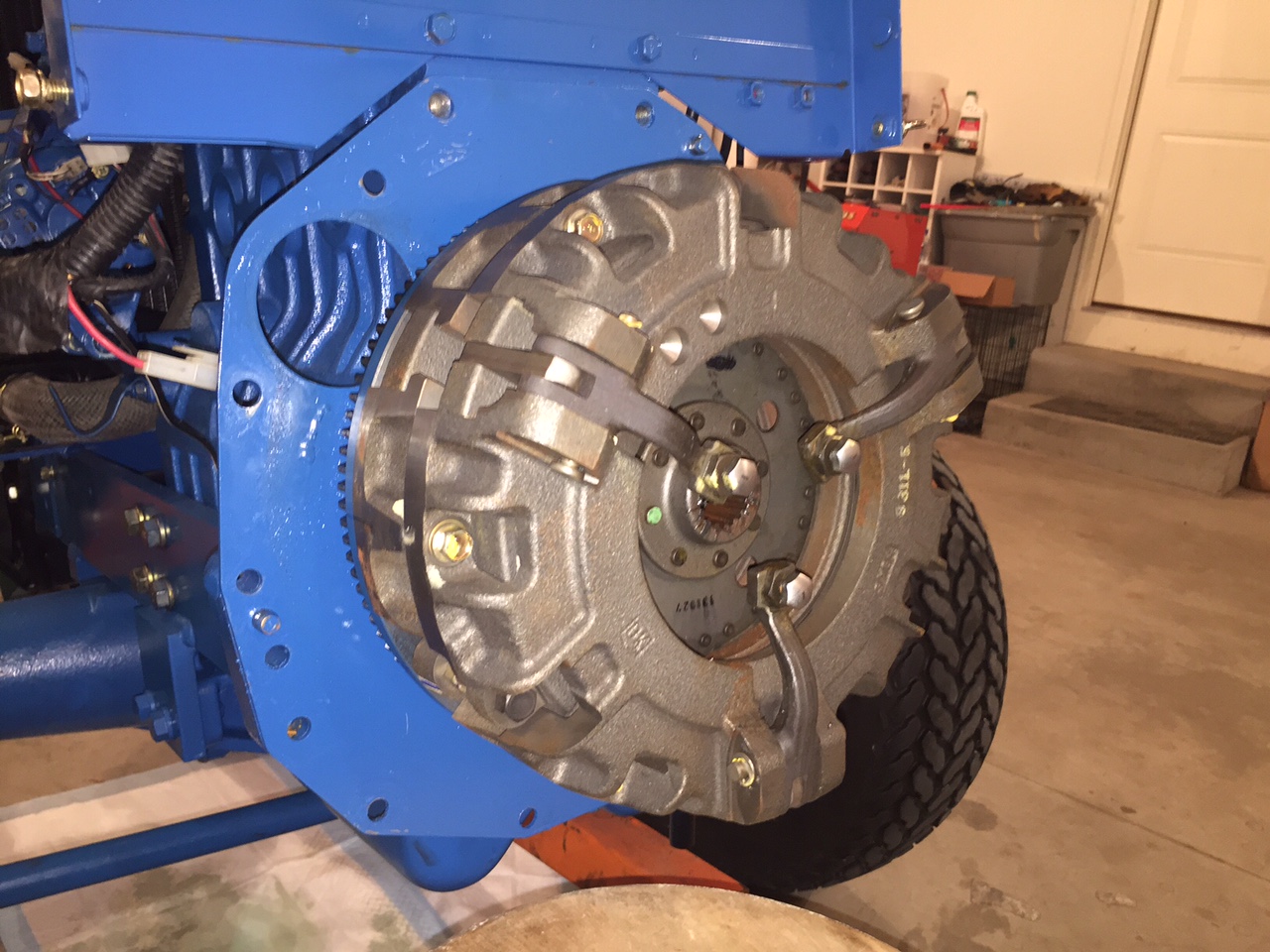

I split the tractor last night and can't see anything wrong with the clutch setup. It only has 300 hours on it since new...the tractor hasn't had a lot of use! I'll dial indicate it before taking it apart to explore the plates...to see if there is anything wrong inside. I also plan to take the engine out of the frame and remove the oil pan to view the engine balancer...and check whether it's properly sync'd with the crank...as the possible source of my vibration issue. This is a lot of work I had not anticipated doing...very disappointing. :thumbdown:

If the disc was in backwards would it cause the clutch to not disengage? I don't have any tractor clutch experience, but lots of semi truck and that's what they'll do if the friction disc is installed backwards. Just a thought....

Okay, I evaluated the double-clutch and found both clutch discs were rusted to their respective clutch plate. Apparently, over the few months it took me to reassemble the tractor, moisture in the air caused the plates to rust and I wasn't aware of it. Anyway, the discs and plates are all cleaned up and that should resolve my clutch issue.
The question remaining is what is causing the engine vibration. Was it the frozen clutch discs that caused the vibration? Is it the engine balancer being out of sync as TractorTech hypothesized or is it something else? Checking the balancer requires removing the engine from the frame and removing the oil pan. I'm not sure I want to do that unless I really have to.
Anyone have a sense whether the clutch could cause the vibration or not? ...or should I continue the disassemble the engine and check the engine balancer?
