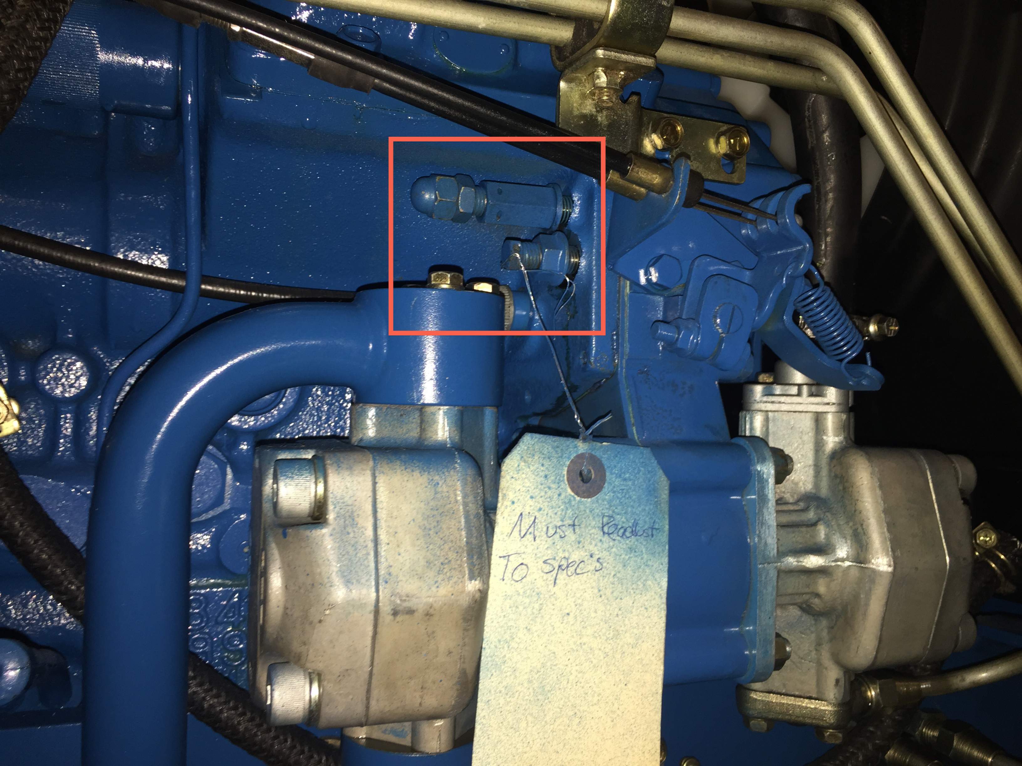

3) thirdly, when I got the engine back from being rebuilt, the tech put a tag on two bolts located on the right side of the engine (see pic). The tag reads "must readjust to specs". I cannot for the life of me figure out what these two bolts do and their description/function is not listed in the Ford repair manual I bought for this rebuild project. Though I doubt these bolts are causing the vibration/clutch problems, I certainly want to figure out what their function is and how to adjust them.

   / 1993 Ford 1920 Engine Failure #22
Sorry to hear of your clutch problems, looks like you need to split the tractor again.
Hopefully the problem is obvious and inexpensive.
As for those two bolts they are for adjusting the injection pump.
One adjusts the engines high idle and the other adjusts the fuel rate (power).
After you get the clutch sorted out and can run it up to speed adjustments can be made.
NOTE!! I'm not sure which way the adjustment works but I suspect that turning them in will increase the engine speed and torque (HP).
I would adjust the speed screw first until it runs at the specified no load speed then slowly adjust the fuel (torque) screw until it performs as it did prior to the failure with no smoke.
90cummins

Also, thanks 90cummins for the info regarding the two bolts (used to adjust the injection pump). Anyone have further insight or factory paperwork/instructions regarding properly adjusting it?
Again, thanks everyone for your help.
