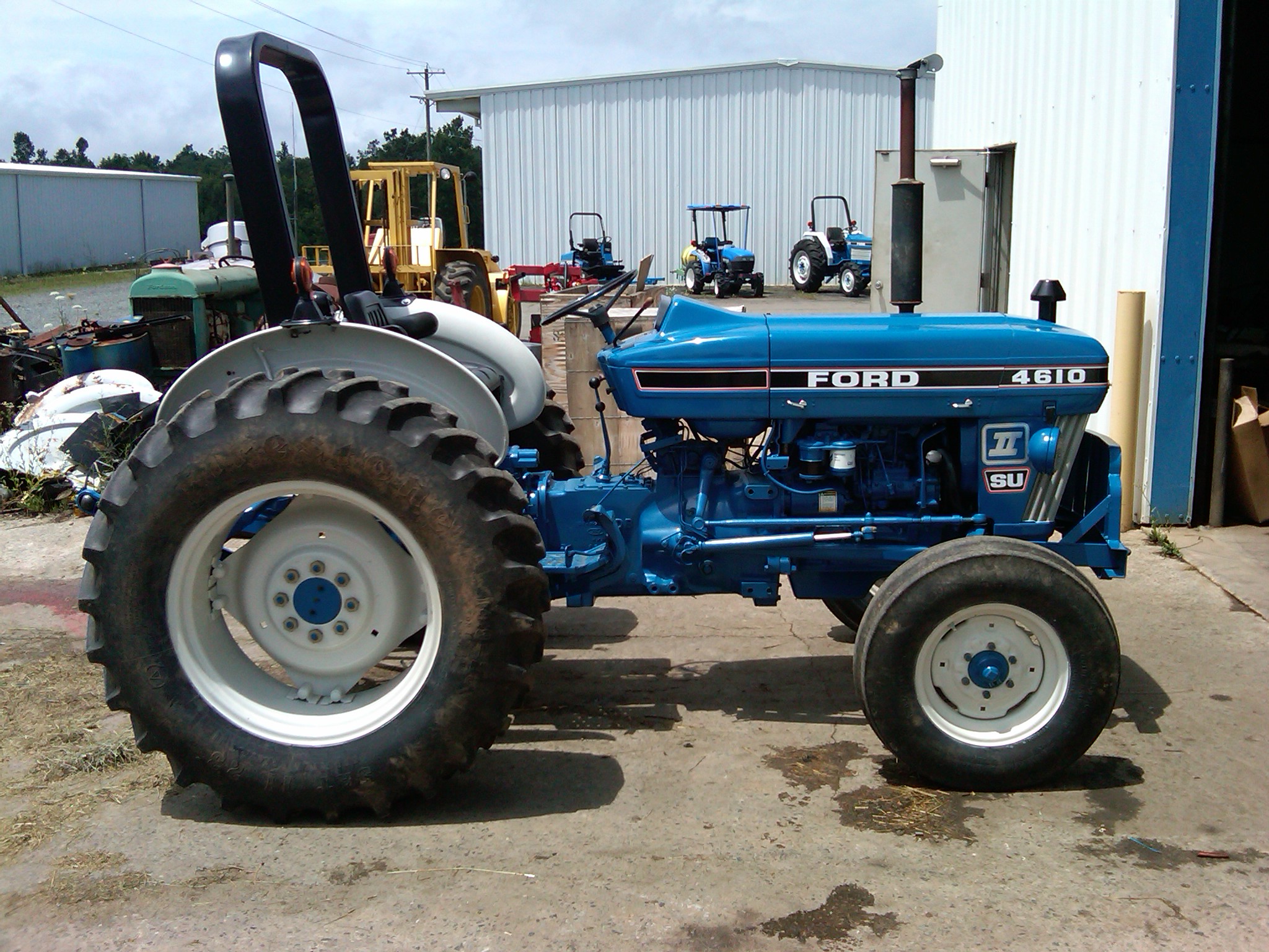

Yeah i'm sure of what it is as i'm a Ford nut and especially an SU nut. I have a couple myself but didn't realize they were made in England as well. Here's a picture of one of the BC serial numbered tractors i found. Check it the rops as this is the style they used when converting to the 3930. I checked in both placed for each tractor and there are serial numbers on sticker under hood and on chassis that match.
As for the strength of the front end they are definitely weaker and lighter, however for bush hogging and general soil disking this tractor is awesome especially in tight places due to very tight turning radius. Just not going to handle a front end loader very long if worked hard.

Ford tractors were assembled in Basildon England both before and after the Romeo Michigan plant was closed following the 1988 production. The vast majority of Ford Farm tractors built between 1989 and 2000 and sold in North America were built in Basildon. Noteworthy exceptions include large Fargo-built 4WDs, Versatiles and Genesis tractors built in Winnipeg, Asian compacts, and Mexican tractors. Some tractors built between 1965 and 1989 were also built in Basildon and equipped for sale in North America. There's nothing special or particularly noteworthy about having a post 1964-British built Ford. If you have a post-1988 3 or 4 cylinder Ford utility tractor with blue paint, it is most likely a British built tractor.

So should i stay away from the England tractors? Are they less valuable or more problematic. I want a 4610 SU II but trying to figure out which ones to look for. Also, is there more emission equipment on the England tractors or 90 models and up? Can't remember when some of the laws changed.

Re-read this part of my previous post:
"There's nothing special or particularly noteworthy about having a post 1964-British built Ford. If you have a post-1988 3 or 4 cylinder Ford utility tractor with blue paint, it is most likely a British built tractor."
Federal emissions requirements for 3 cylinder Ford sized tractors kicked in on Jan 1, 1998, long after 4610 production ceased. If you want a 4610 SU, you should be more concerned with price and condition than country of origin.
