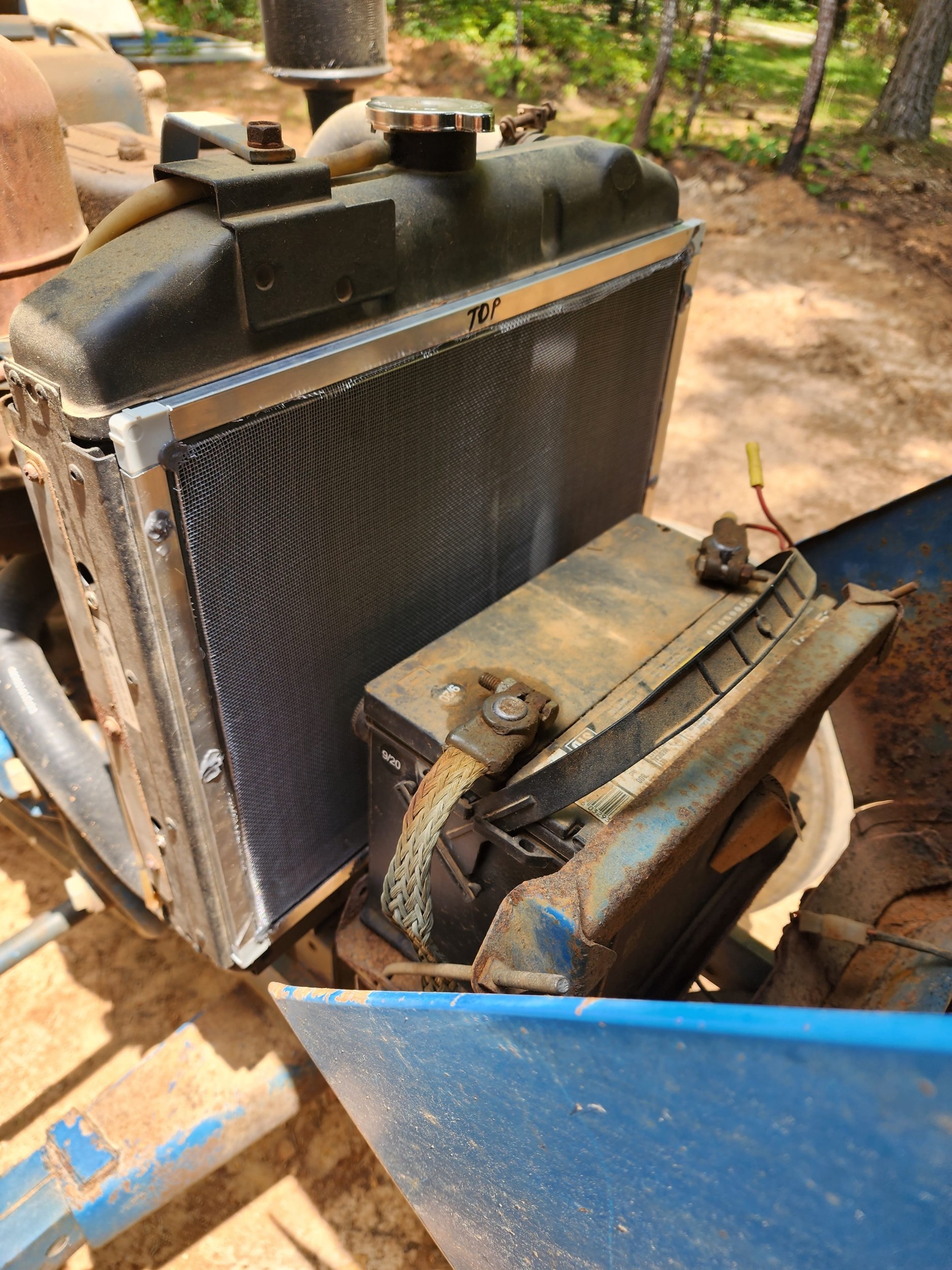

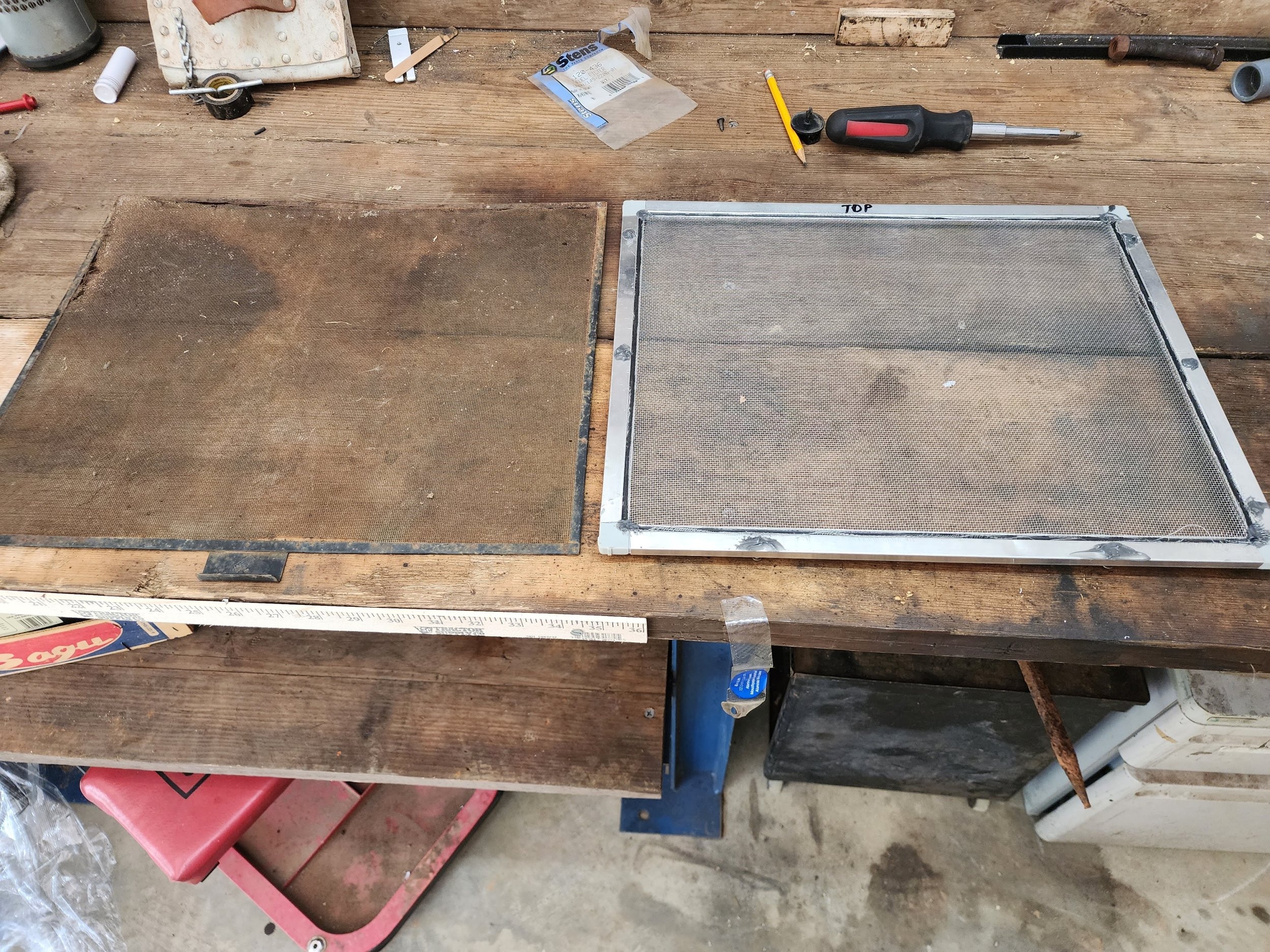

the radiator screen on my 1980 Ford 1700 is rotten and trying to pry the metal frame a part to just replace the screen is not working. I have found a couple of complete screens on line but at 120 bucks I am thinking I can build something, now I have an idea but I'm looking for something that has been tried and worked before I go to far and completely build something. Is there a kit that comes with the frame that can be made what ever size is needed?

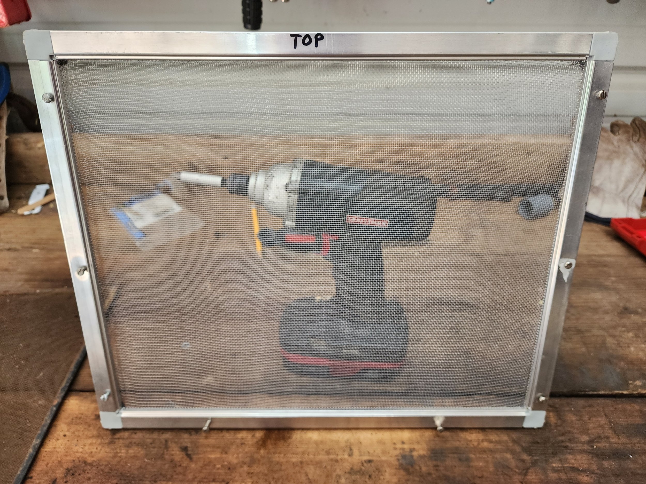

Okay this is what I came up with and if the heat don't destroy it then I think it will work. the screw heads slide in the same grove as the old screen and the ones on the bottom keep it from going to far. The frame is aluminum and so is the screen and I know they make the corners in aluminum but I couldn't find it the day I was looking.

I second gregster613. It looks good. Part of working with equipment is improvising.

Thanks for the replies I run it just a little and it seams just fine but later when I go do some bush hogging I will know
/ 1980 Ford 1700 radiator screen #8
Keep it clean now ! That's the biggest thing I noticed on my Ford 1900. And I did buy the NH brand new screen for mine as it was mangled too badly.
