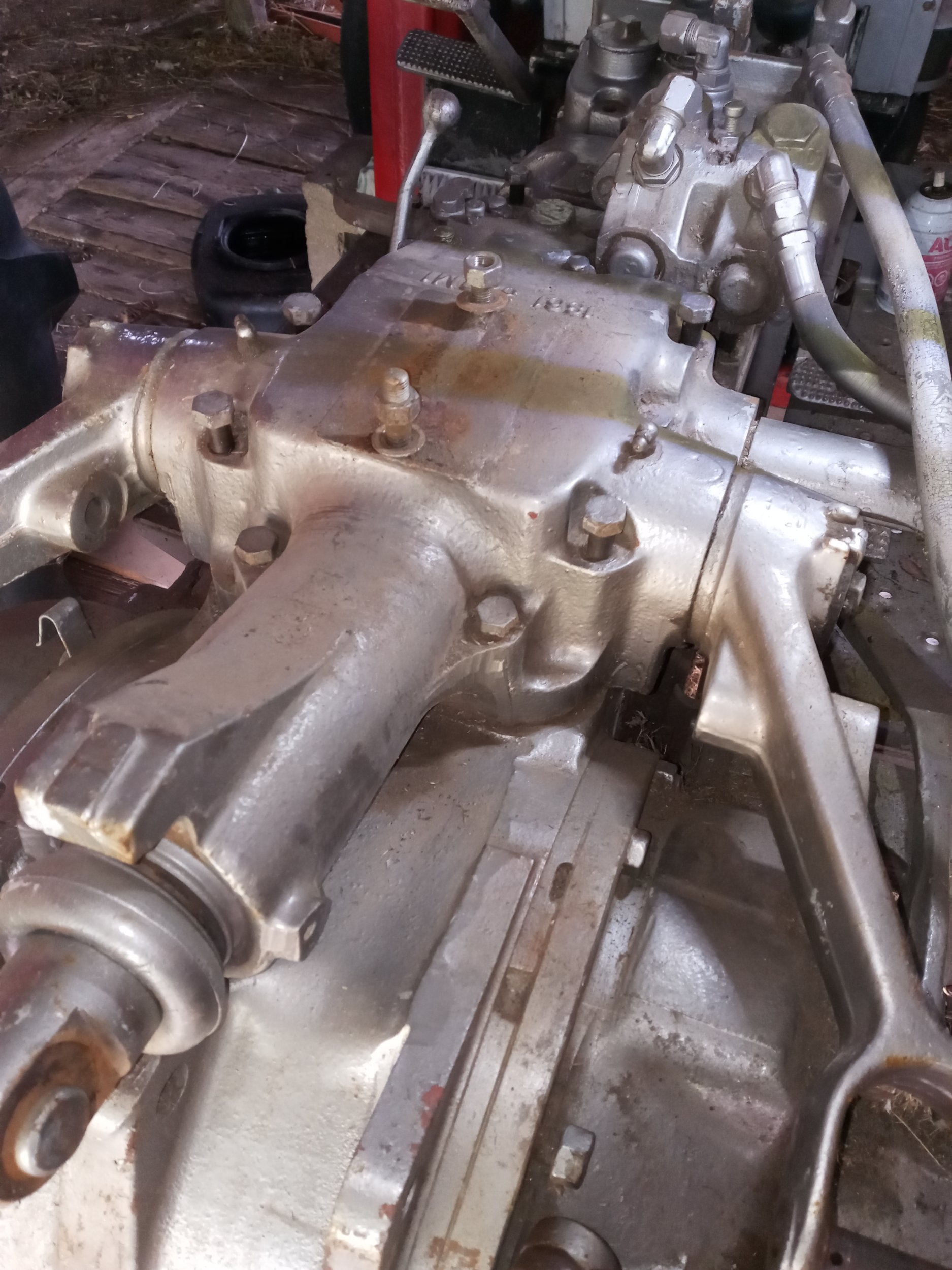

Patrick! Sorry I missed your last post there. I (we) pushed the tractor in the barn for the winter and just getting back to it now. I have it ready to 'split' on solid jacks and support and was checking the helpful notes here to get ready for a local repair guy to look at the inside once it's apart (and a few other smaller things he can probably advise on). Thanks to you all again for the guidance getting this far. Your timely and accurate advice saved me $$$.00 for sure! I'll let you know the result in a couple of weeks when hopefully it's moving again. Have a great summer!

So I called the repair guy who is too busy to come out for 2 weeks... and he advised that I can get to the problem inside by removing the seat and access the gears by removing the cover as seen in the photos. One set back is there is one bolt (you can see the underside-view photo) that will not clear the hydraulics and lever housing. The rest of them are no problem. Suggestions?

The question I have now is: remove the hydraulics housing to allow the bolt to come out? (It isn't obvious how to do this and if I do it, does this affect the hydraulic pressure in the lines?) Or... should I do the split as originally planned? Everything is drained and supported and all the bolts are loosened. Think I prefer the former except for that one bolt.

Most people would simply remove the obstructing valve body from the lift housing before attempting to raise the housing. Putting it back with that bolt dangling will be nearly impossible, what with trying to get the standpipe back into place and the vertical links in place for the control valve as well?
You would be far better off ( and do less damage) to just split the tractor rather than continue as you are. You haven't really studied the service manual, have you?
