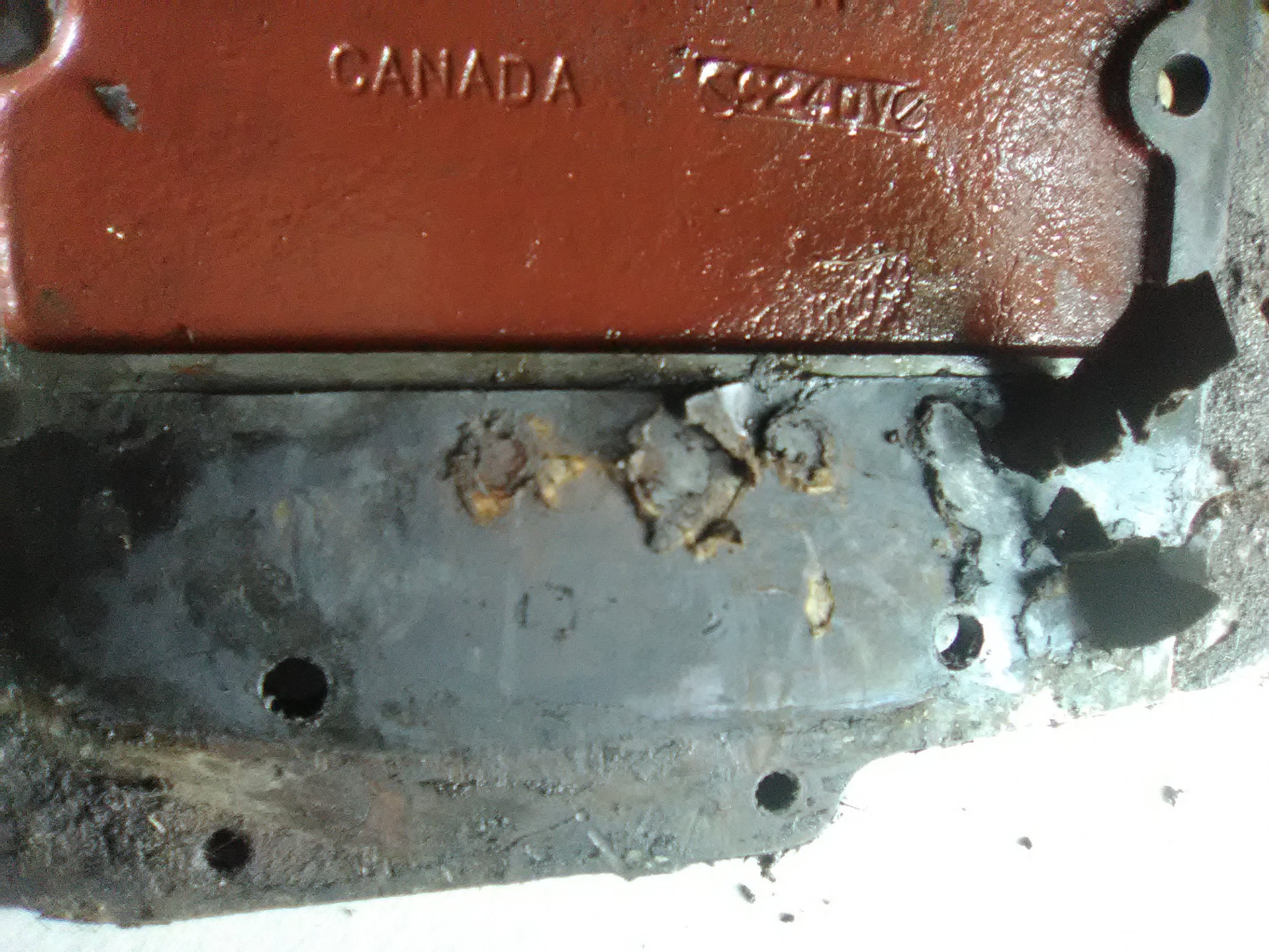

Here are photos of the gasket looks like it has been mangled by the motion of the h-l range bar. Could this affect the shifting ie; it's not moving into place properly when moving the shifter from low to high and back and forth? Seems like a fine point but there it is... What now? Thanks for this help Patrick!

The gasket would have little or nothing to do with it. Now the cover is off, you see the shift gate and rail are intact. The problem must be in the hi/lo itself. With the spring and detent plungers loose you can easily shift any of the rails by hand, so what does the hi/lo rail feel like? In theory, you should be able to slide it from hi to neutral to lo and back again, and with just a slight finger pressure on the detent spring feel the plunger drop into each one. Does that happen? You may have to rotate some gears/shafts to find the right spot, but if you can't make that happen you will need to get into the fork and sliding collar of the planetary unit on the back of the transmission. A rear split may be in your future. If the problem is with the fork or the collar, you may be able to get it out and back in place with the lift cover off. If it's in the planetary, then the split will need to happen.

I'm hoping against hope I don't have to split it the way you describe. It might be cheap fix but it doesn't look easy. I'm going to suggest I fashion a new gasket and put the cover back on top see and go from there. Do you concur

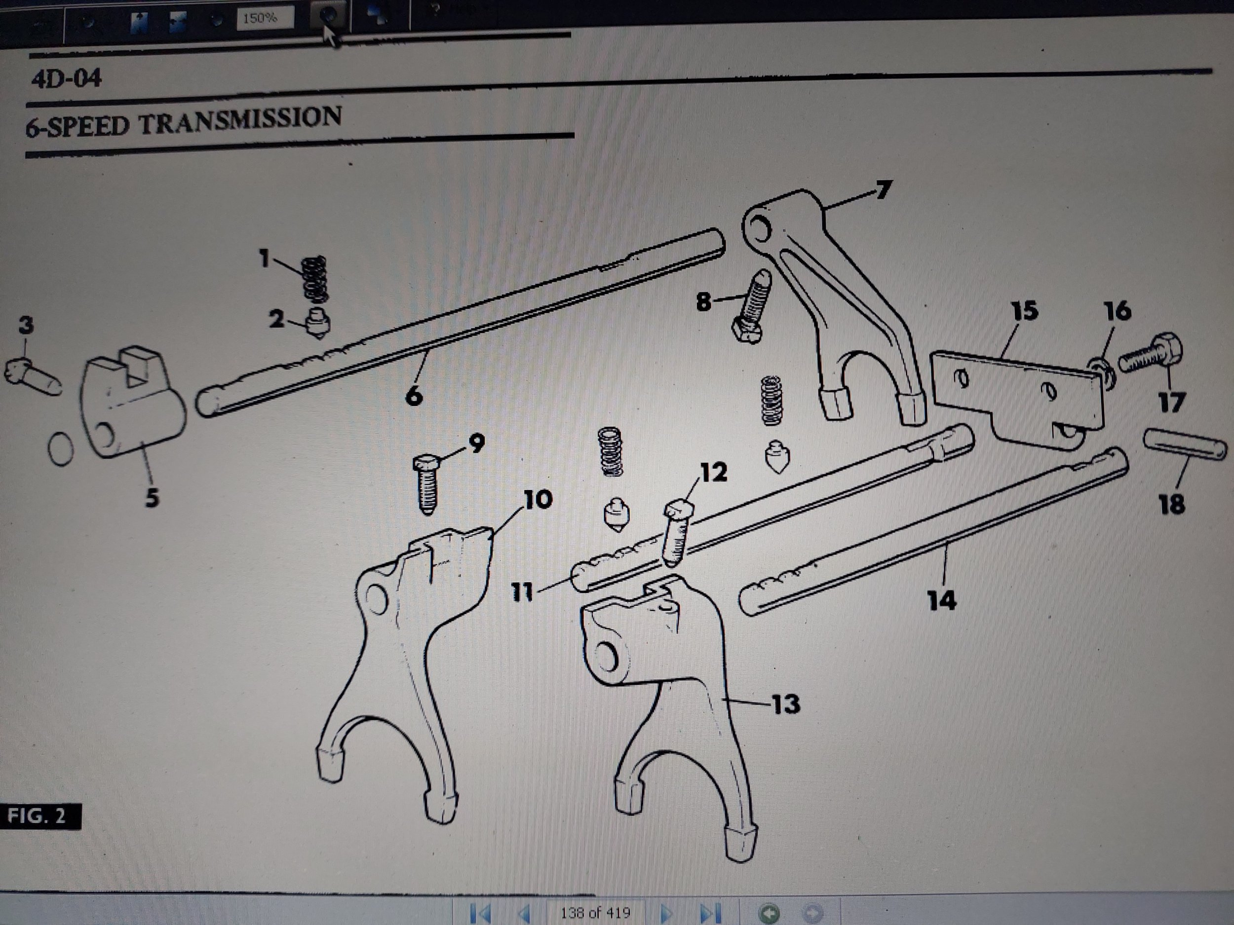

I understand you mean R-1 & 2-3, referring to the lock-out mechanism, but why does he mention four springs and plungers?
Here's a picture of an 8- and a 6-speed shift cover from a 135 book. Could it indeed be an 8speed? Or are they a different design in the bigger tractors?

From his photos, it is an eight speed. Doesn't really matter though, the hi/lo is basically the same with either. If his problem is back there he still has more digging to get to it.

Looking at Doitnow's pictures in post #36,
1st (Top) rail slides back and forth for HI & LO
2nd from top slides back and forth for 3 & R
3rd from top is stationary and prevents moving two slides at same time.
4th (bottom) rail slides back and forth for 1 & 2
