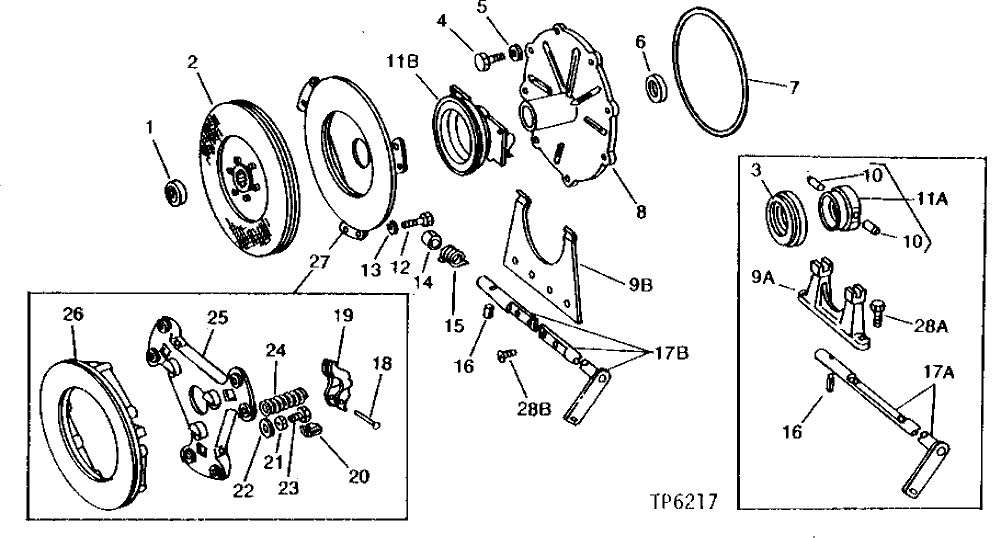

Two splits possible, forward of shift levers or behind shift levers.
You want to do the first if you are after the clutch, same as TX Jim says between engine and clutch housing
I have a JD 2030 I need to replace the clutch housing on later when it warms up.
